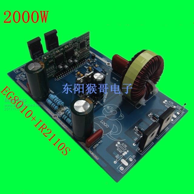

If you are wanting a high voltage DC to AC inverter this kit using the EGS002 board might be worth having a look at. I have not had anything to do with these but it might be an easier way for you to achieve what you are trying to do.
Edited by Madness 2017-11-21

Does that 2000W inverter kit need heatsinks and 380VDC and maybe other components?
