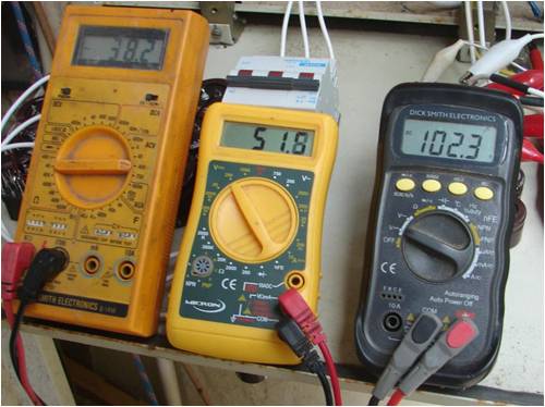

Posted: 02:09am 11 Nov 2009
  herbnz said  I will test on mains a single phase version. Here I can use a variable supply and with my cap bank switch in different values caps.
Always struggling for time here.
In a normal ac cct a cap will charge and discharge by equal amounts. What I see in the bridge cct in relation to the two caps on each phase, on the +ve cycle one cap charges via the batteries the other charges in parallel to ac supply. hence different charging currents on the -ve cycle the return current from other phases is in a opposite way this should result in a dc level on each cap that seems to be in a favourable bias for the next cycle we should see a DC level across each cap Time constants will play a big part here.
The diodes dont isolate the ccts but act as steering devices.
Hi Herb,
I have a pic of the voltages I measured today.
The meter on the left is the ACV across 2phases. The centre meter is the DC voltage across the lower bridge of the voltage doubler. The right meter is the voltage across the two bridges.
WRT your comments.
I treat the voltage doubler like 2 series cap coupled arrangements that are parallel across the windings but in series across the load. This to me is the easiest way to visualize.
In the cct here
What I have seen is that the caps connected to the top rectifiers develop a negative DC voltage when measured between the AC from the winding and the rectifier input, and the caps connected to the bottom rectifiers develop a positive DC voltage when measured between the AC from the winding and the rectifier input.
The sum of the absolute value of the voltages equals half the output voltage. The voltages are not static, but change with loading and AC input voltage.
As to what to call the diodes function????? I suppose normal rectifiers could be called steering diodes as well.
To test the function of my cap voltage doubler arrangement would not require large expensive caps or bridge rectifiers. 3phase source may be a problem for some. I would not go back to a single phase test as the ripple makes it harder to measure without a CRO.
Gordon.

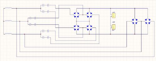

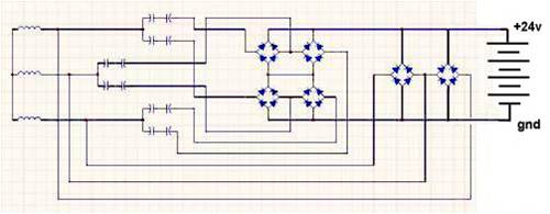

KarlJ
Joined: 19/05/2008
Posts: 1178
Posted: 11:41am 12 Nov 2009
so Gordon, how does the series load work with 24V battery and a 48+V inverter like the PVE1200, ie like Phill's
I cant understand this part of how it works per the schematic, would obviously save me some money in batteries.
I bought a PL20 as the aim is to have as many similarities to Phills as possible as the learning has been done.
I took his advise and have got (on their way from Japan) 24 x 680uf 450V caps.
Initially I'll be running them on a single stator with half wired as star the other half as delta, rotor is probably a bit big at almost 2.6m.
Batteries is a bridge i'm still yet to cross, if 24V will do then i'll save the $$.

I have noticed an error in the cap article. There should be a connection between both pairs of bridge rectifiers. That is the 2 + terminals of the bottom rectifiers shoud be connected together, and the 2 - ve terminals of the top set of rectifiers should be connected together, and these sets are then connected together. This means 4 connections in the centre between the rectifiers. My original picture in the forum thread a way up now was correct.
I expect Gizmo will be able to easily fix the pic in the article.
There have not been any Queries, so I suspect no one noticed a difference either.
I hope all readers have the correct wiring, as in my pic above.
Gordon.

Hi Gordon
The readings we want to see is the Dc voltages across the caps Your comments re the bias confirm my interpretation of how this cct works. I myself will concentrate efforts on this. The charging here is added to the next 1/2 cycle to boost the output as we see in the accepted voltage multipiers. The caps are charged up by the different loads each experiance due to the steering of the respective diodes one via the batteries one directly back to the windings (ie parallel )
Yes I always see diodes as steering devices .
The boosting will depend very much on the cap value, loading, frequency. In other words the amount of charge taken on during the charging part of the cycle hence Time constants are the key.
Even with your revised cct I cannot concur with your view that there is two separate rectifier ccts added together.
I will continue my measurements as time permits I really envoy you being able to spend so much time on this. I retired to a remote block thinking I could work on projects but find my self more bogged down than when working living in town. Even to get time to read reply here I had to get up 5am .
HerbEdited by herbnz 2009-11-14
SparWeb
Joined: 17/04/2008
Posts: 196
Posted: 05:22pm 12 Nov 2009
Hi again Gordon. I'm always following progress, and again I have a mill worth trying this on. Maybe I will add some experience with industrial motor conversions, where so far most success has been with the F&P's.
I do want to understand the diagram as well as possible, first, and the reduction in resolution makes it hard to read the image. I also cannot tell if Gizmo has updated your diagram image or not, so the starting point may be a bit out of date. What I can see leaves me with a question. I've "tweaked" the drawing to show what I mean:
Do you have to use 12v batteries? It looks like a continuous string of cells for 24v should be connected, like I've shown in my edited version.
I'm not very familiar with circuit drawing conventions so maybe you're not supposed to draw things this way, or maybe you've used a short-hand notation and it's obvious to everyone but me.
I also use a 3-phase bridge in my system, not the little square bricks, and it looks like it won't matter as long as I use the 4 brick rectifiers as you've shown in the parallel Cap circuits. If I'm right so far, I'll draw up my own circuit diagram and post it.
Hopefull someone will give a shout if I'm about to let the magic smoke out.

GWatPE
Joined: 01/09/2006
Posts: 2127
Posted: 12:00am 13 Nov 2009
  herbnz said  ...The readings we want to see is the Dc voltages across the caps...
...The charging here is added to the next 1/2 cycle to boost the output as we see in the accepted voltage multipiers. The caps are charged up by the different loads each experiance due to the steering of the respective diodes one via the batteries one directly back to the windings (ie parallel )
...The boosting will depend very much on the cap value, loading, frequency. In other words the amount of charge taken on during the charging part of the cycle hence Time constants are the key.
...Even with your revised cct I cannot concur with your view that there is two separate rectifier ccts added together.
There are several points here that I will address.
Starting at the top.
"The DC voltages across the caps".
Some will say that one set of caps could be removed, and a direct winding coupling to one 3phase bridge would work. This is true, but as the AC voltage rises to the point where the normal 3phase non doubler 3phase rectifier would pass current, the caps would effectively be directly loading the windings in a parallel resonant manner. This is not the objective.
The DC voltage across the caps? consider only when there is just DC current flowing to the load and above. 1/2 of the peak rectified AC voltage appears as a DC acrosss the caps at cap voltage doubler loading cutin. I have not had the opportunity to measure all voltages in all windmill operating conditions.
The caps in the top and bottom rectifier cct are synchronized. The volages are directly additive within the cycle, and for each phase. The charging is not determined by the loading, as voltage doubling occurs below cutin, with no load current. The measurements in the pict above were measured from an unloaded test. The output voltage is proportional to the input AC voltage up to cutin. This is not a charge pump like you are suggesting, as the synchronicity gives the peak voltage straight away. There is no power charging and discharging of caps until current flows. There is a DC balancing charge voltage developed across the caps up to cutin, but no AC until current flows. As increasing AC power is passed by the caps, increasing AC voltage is developed across the caps.
The voltage boost is linear with AC windmill output voltage up to cutin, and is not proportional to cap uF. The power transferred to the load after cutin is proportional to cap uF and AC Hz and the ACV developed across the cap in response to the loading.
I think you will be surprised when you consider the windmill windings being effectively 2 parallel sets of windings with DC isolation being provided by the caps. The separation of the AC and DC with the synchronous operation allows the cct to function the way it does.
Gordon.
PS: anyone with a multimeter, handy with a soldering iron, or clip leads, with a 3phase PM motor and 12 diodes and 12 DC caps could show the voltage doubler function as an academic exercise. probably a few dollars for new components, Low voltage testing, not even a battery needed, 1n4001 diodes and 10uF 35V caps, and spinning the motor by hand on a pulley.
The usefulness with a windmill comes with component sizing for the required power levels.
PPS: from the meter readings above.
The ACV was 38.2VAC. This would be approx 54.01 peakDCV, less approx 1.2V diode loss, so 52.8VDC. The measured 51.8V is close enough. double this is 103.6VDC. The measured 102.3 is close enough. All these measurements are within the meter measurement errors.Edited by GWatPE 2009-11-14
become more energy aware
Gordon.
P
Very surprised
Not saying it dosent boost just how it does it.
Gill stop grinning up there sorry I did not support you at the start you were right on with your analyisis.
I will continue testing caps here but will end this discusion now as it appears the forum supports Gordons explaination. I myself cannot accept the isolation theory.
Herb

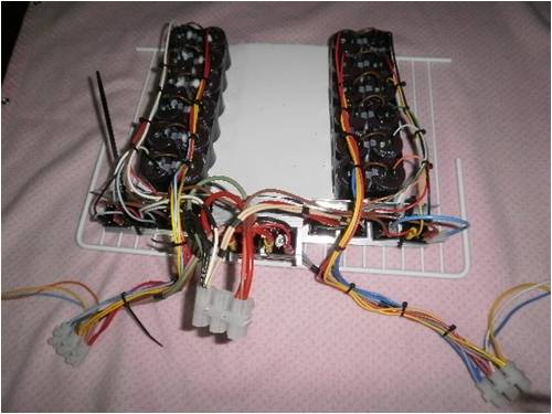

KarlJ
Joined: 19/05/2008
Posts: 1178
Posted: 09:45am 13 Nov 2009
I reckon you should call it the
"OZ-FLUX CAPACITOR"
It will sit in the "fridge" electrical cabinet.
Additional wires with ends are for the stop switches.
This setup uses 12x 35A bridge rectifiers and 24x 680uf 450V caps back to back.
Can be used for a dual stator mill or in my case a single stator with half in star and half in delta.
caps ebay from Japan- best I could do was $100USD including freight.(which was 1/3 of the cost)
Total is about $180 bucks worth of bits here and about 3-4hrs to put it together.
From an economic point of view at 18c/kw/hr =1000KWhrs extra the 'mill will need to make over its life.
I figure 1KW/hr/day extra it will make over uncapped rig call it 3 year payback which is not unreasonable.
If you have no other sources of power
....probably priceless as not much will match it.
Edited by KarlJ 2009-11-14

Hi Herb,
This discussion has been in flux since last christmas, when I first presented the cap voltage doubler. I was hoping someone could have presented a spice simulation or similar in this time as well.
Here are some measured AC & DC voltages that you requested. Just remember that no DC durrent flows through the caps, only AC, and this is only when there is current to the loading.
I have just run a 1phase test of a cap voltage doubler only, using a single output 28V 2.5kW torroid on the mains. This has 4 pairs of DC caps connected to 2 bridge rectifiers, with the bridge rectifies connected in series. 50Hz test only.
The output was quite constant DC wise on the meter. I used an 100uF cap, to simulate a small battery. The voltage did not drift up or down over time.
The 28VAC input gave 76.8VDC output. The cap arrangement consumed 4mA rms AC at 28VAC. There appears to be no significant power[0.1W] consumed in the voltage doubling process. Unloaded, there is DC across the caps, but no AC. Both ends of the transformer output AC were at a potential of 30VDC above the negative potential of the lower bridge rectifier. The input of the top bridge rectifiers was 13VDC below the maximum DC positive output voltage, and the input of the lower bridge rectifiers was 13VDC above the voltage on the negative output. The ACV between the upper and lower bridge rectifier inputs to the bridge rectifiers, after the caps was 100VAC on one side, and 80VAC on the other. I expect that this is not a sine wave. I have probably posted a pic of the waveform around page 15.
The path the current flows will be guided by the potential at each of these points. The pics posted by others did not make allowance for the DC across the caps. This changes the way the bridge rectifiers work. The windings sit at a DC potential approx half the output voltage, and the full input AC is effectively placed across each bridge rectifier. There are 2 bridge rectifiers, so the voltage will be double, which it is when measured on the cct.
All I can suggest is that your understanding of the isolation here is different to mine.

Hi Sparweb,
any chance of a spice simulation?
My voltage multipliers are working on my new design AxFx mill. Phillm has the Rolls Royce version at 3kW. The cap article has more details of my cap arrangements, and Phill has posted his config elsewhere as well.
I have 12V batteries and LiPo cells. The battery is just that, an accumulation of cells. This gives the system voltage. A battery is not essential, but smooths out the transient power bursts from wind gusts.
Your pic is OK. 3phase bridges make the connections easier as well. You will only need a total of 3.
Gordon.
SparWeb
Joined: 17/04/2008
Posts: 196
Posted: 07:04pm 13 Nov 2009
[quote]3phase bridges make the connections easier as well. You will only need a total of 3. [/quote]
Three instead of four rectifier blocks: This will probably become more obvious as I draw it up.
Once I have a good diagram and tried wiring it up, I do want to try a Spice sim, too. Thanks.

Hi sparweb,
Yes, with 3phase bridges, only 3 in a total system of cap doubler with a normal rectifier. 2 used in the cap voltage doubler, and one for the normal rectifier. The direct connected 3phase bridge would have a higher current capacity, as outlined in the cap article.
It will be interesting to see what spice comes up with.
