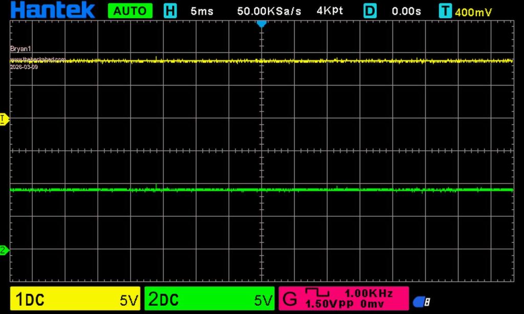

first scope test
Ch1 to D1
Ch2 to D7
Gnd

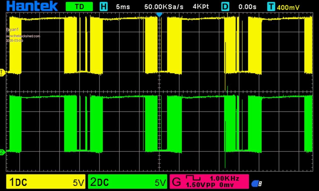

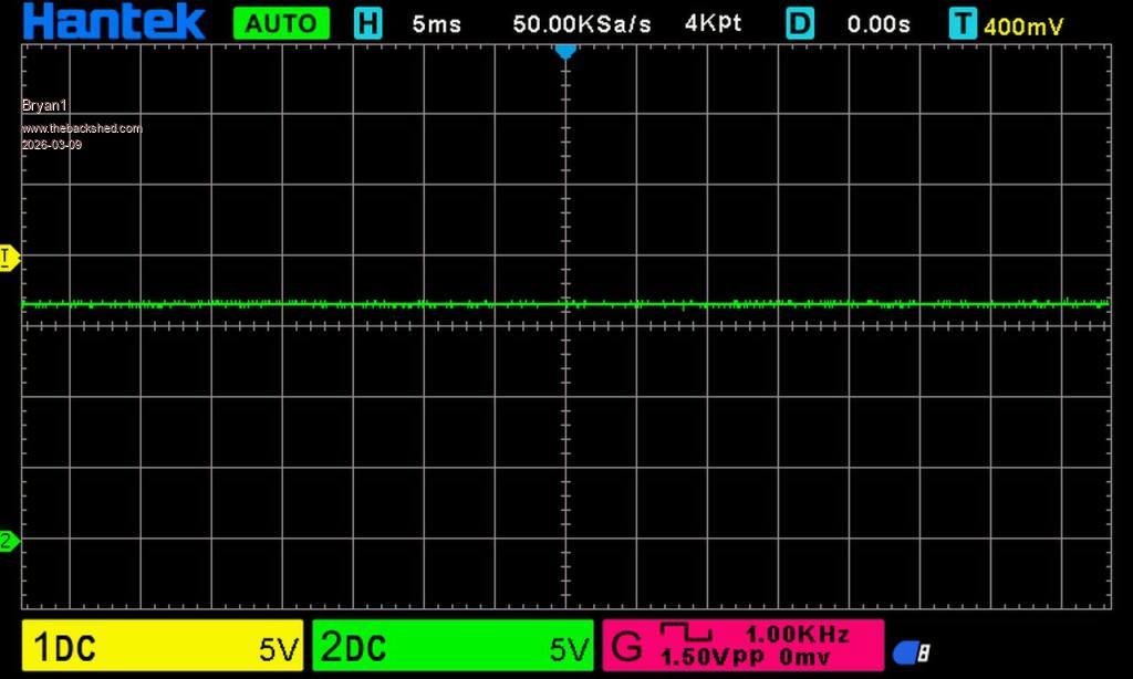

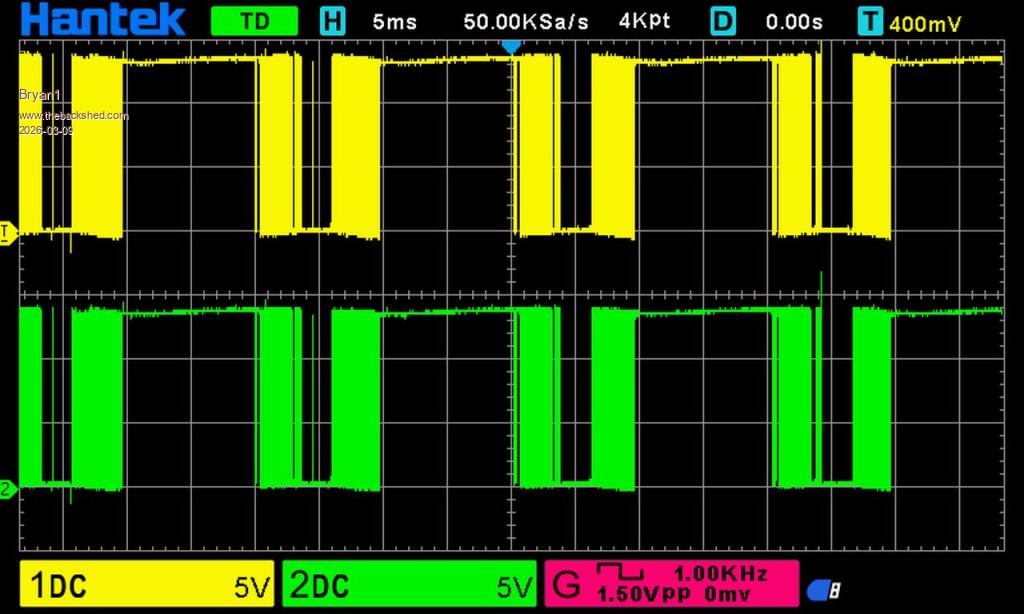

Bryan1
Joined: 22/02/2006
Posts: 2297
Posted: 03:26am 09 Mar 2026
VS1 Low side
CH 1 pin 1 on the TIP42
CH 2 pin 1 in the TIP41
VS 2 low side same setup
more to come
VS1 high side
VS 2 high side
So it does look like the high side TIP's are gone.

Just a sanity check on the high side scope tests:-
Did you remember to pull the 'low side' of the high side totem poles (i.e. VS1 and VS2) to gnd for the high side tests? If vs1 and vs2 are left floating, the bootstrap caps won't charge i think.
I'm not sure which diodes D1 and D7 are, so i don't know if those scope tests look right or not.

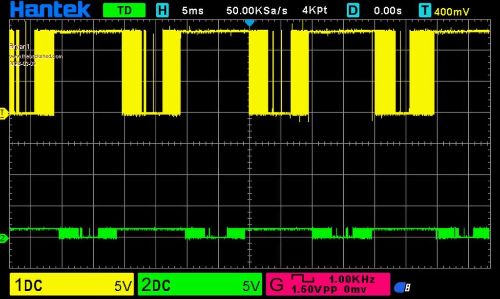

tinyt
Joined: 12/11/2017
Posts: 564
Posted: 01:26pm 09 Mar 2026
  mab1 said  Just a sanity check on the high side scope tests:-
Agreed.
Also, Bryan's scope traces are confusing.
TIP41 pin 1 and TIP42 pin 1 of the pair are connected together on the board, so Bryan's green trace is a duplicate of the yellow trace.
D1, D7 traces seem to show something wrong by the low P-P voltage of the green trace (D7) but I am no sure yet.
Bryan, let us see if this will work with all mosfets still unsoldered.
