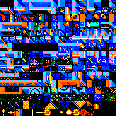

Posts: 6104
Posted: 10:34am 29 Oct 2023
Still VGA only: additional functionality:
- you can place a bomb, and have 3 seconds to run (at least 5 tiles) away.
- the bomb does 11 damage radius 5, so all hoverbots within 5 tiles will die.
- when too close, you get damage also... so make sure you have a medkit.
this version has a new library, with sprites for arrow cluster, bomb and magnet.
The bomb functionality is "almost" complete. In next version I target to add:
- walls block the bomb blast
- tiles can also get damage (bridge/canister) from the bomb
There is a new library, so
LIBRARY DELETE
LIBRARY DISK LOAD "lib/pet_lib21b.bin"
RUN "pet21b.bas"
The ZIP is quite large since I included all actual artwork also So Martin can copy the new sprites I created into his MMB4W game.
petrobot21b.zip
Have fun walking around in the worlds ....

The Screenshake while the Bomb explosion can be done somehow like this
Draw first stage of explosion
pause 20:Sprite Scroll -4,0:pause 30:Sprite Scroll 8,0:pause 30:Sprite Scroll -4,0
Draw next stage of explosion
etc..
so that every Time you have to draw, the Tiles are on the correct position and you dont need to calculate an offset

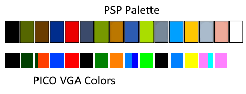

I will try the challenge of replacing non-existent colors with dithering next.
compare:
If you're unlucky you'll get a new, revised tileset
Dithering causes details to be lost, so it can only be used on larger areas.
Martin

Posted: 11:29am 30 Oct 2023
Volhout,
as I announced yesterday, I replaced non-existent colors with dithering, as you can see, I partly replaced the Tiles which match better to the PSP Version, also the outdoor Tiles are a little darker so the Sprites will be easier to recognize:
The goal was to keep the details
You can try out whether you like the new version better.
Voltaire: "the Better is the enemy of the Good"
Martin
alt-Tiles.zip
Edited 2023-10-31 00:44 by Martin H.

Posts: 6104
Posted: 03:31pm 30 Oct 2023
Hi Martin,
Added the new tileset. But RLE compression is becomming inefficient.
The library grew to 97kbyte. Old library was 94k. Do not dither more tiles, since we run out of space (100k = limit).
petrobot22.zip
Only adaptation is the support for the new library and the 4'th tile index file.

Joined: 04/06/2022
Posts: 1548
Posted: 03:50pm 30 Oct 2023
  Volhout said  Hi Martin,
I'm not sure which one looks better. The new tiles are closer in color to the original but the dithering is clearly visible on some tiles.
It was a suggestion

Amnesie
Joined: 30/06/2020
Posts: 763
Posted: 07:35pm 30 Oct 2023
Maybe there is some compromise, I think dithering looks great...
