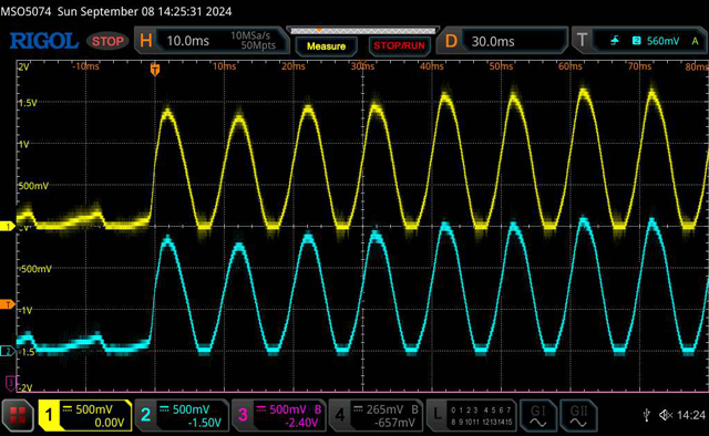

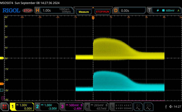

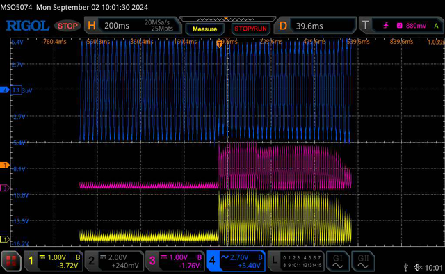

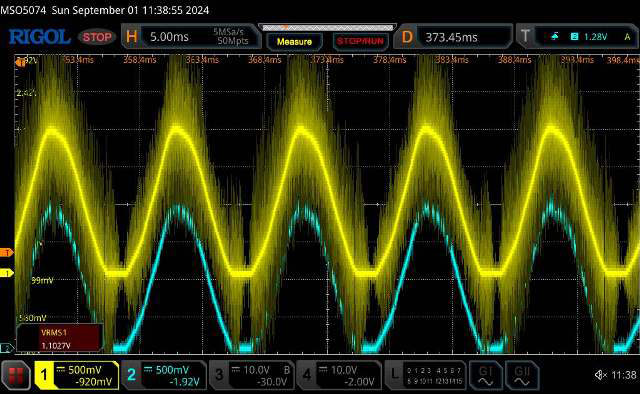

Thanks Aaron, and others who have sent me a PM or email.
I've been tuned-our for some time now with the New Inverter, still some tiding up and testing to do, but gee it's getting better by the day - and here is why:
For some time now in the last Inverter and power board, I've been chasing some high frequency noise and ringing, this followed across to the New dual inverter, the boards only have ferrite beads on one side in both boards.
So I wanted to try the power board's with all ferrite beads fitted, see if it makes a difference.
In the dual inverter, the noise appeared to be more noticeable from one power board, but due to the radiating nature of this noise, it was proving hard to pin down.
I spend the past couple of days building two new power boards, the ferrite beads I used are not as thick or as long as wiseguys original, so inductance will be different, but these beads should make some difference, and they allowed me to mount one power board straight to a big flat heatsink, so didn't need to build up a set of spacing bars.
Test mode is your safety net for testing without damage, use an adjustable power supply, I set the current limit to around 400ma, and start the voltage at 10V and slowly increase it looking for any sudden jump in current, the LCD will indicate some AC output even at voltages around 13v to 16v.
I found one power board made the Test Inverter setup draw twice the idle current, as the other board, I traced that to an incorrect resistor value on one Opto coupler
The result is the waveforms are now really good and all the noise has gone, but more testing will be needed to see the real impact of the ferrite beads, and if the smaller beads are suitable.
A benefit of reducing the noise, the idle current is now slightly less.
The Inverter idles at 47 Watts:
With the boards installed in the new Inverter, the power difference between AC outputs on each toroid is now almost impossible to detect on dual AC power monitors, even at 3.5kW, both AC currents and powers are now virtually identical.
I've hit the new boards with over 712A total Peak DC input and all I got is one little flick of the LED light above me.
The really interesting thing - I sat beside the Inverter when it started the Extractor at 500A peak DC input for 2 seconds, the Toroids were "absolutely" silent with the new boards starting that load, with old boards the toroids made a slight buzz with very high current startups.
So there are a number things I need to investigate with the old boards, at least I can take my time now.
FYI:
Current sensor on the DSO are now really clean, DSO captures of the compressed startup current waveforms are now a clean smooth envelope.
Old boards 240A per power board (480A total input):
New boards:
Old Boards : Current sensor zoomed
New Boards:

For AC current, I found the Peak Clamp meter I had was no good, lowest range is 200A and it showed nothing on peak hold into the 2nd Toriod.
I should have set up one of the little current transformers, but I'm just running out of time at the moment.
I've removed the 2 stage switch and connected the Inverter back to a straight Dual stage Inverter.
Now I need to build a second Nano 7 controller as a spare whilst I'm in the building frame of mind.
A dozen or so household repairs and yard work that I've neglected for the past 2 months also await me
But at least the switching method you came up with is sound

  Quote  Your edited post suggests an AC current occurred with the Variac somewhere north of 100A ?
I guess it may have been getting close to that if the calculations are correct, and allowing for parallax errors at a distance of 2 meters looking at two analogue meters kiss 300A each.
Inverter AC current trip is set at 48A on each power stage, so AC trip is at 96A, and allowing for AC voltage drop at those transient peaks, I guess that might be somewhere around 18 or 19kW ?
Edited 2024-09-13 18:24 by KeepIS
