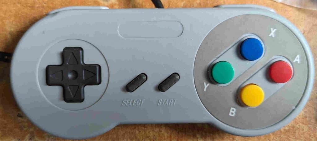

Why does the USB always announce that a generic gamepad is detected whenever a keyboard is plugged in? I've just tried two other keyboards. This one is a wireless Logitech and it announces a mouse, keyboard and gamepad! That's probably because of Logitech's multi-purpose dongle. The other two keyboards are normal Chinese ones.
If I add a generic controller that is added as expected.
Incidentally, the direction pad on it is detected by online testers as pushing a LH analogue joystick to it's 100% limits. It's not seen as switches and I don't think it works in MMBasic. It's the usual "bone" shaped controller. (I've lost the command for reading anything but the WII controller in MMBasic. Can someone help please?)

You seem to have a strange controller - bin it   . My one has all buttons as digital and reported  by the DEVICE(GAMEPAD n,B) function.
Lots of keyboards seem to report multiple USB devices. The firmware treats unrecognized devices as a gamepad as there is no standard code for these. Just ignore them.

It *looks* like that but has no indent. It is obviously different inside. I have 2 of them and they both work identically!
Buyer beware....

  Mixtel90 said  It *looks* like that but has no indent. It is obviously different inside. I have 2 of them and they both work identically!
Buyer beware....
Personally I think we have too few data-points, I suspect the number of people running the USB firmware + having a "generic" controller could be counted on James Doohan's right hand. And, even though I do have a RP2040 based USB board it's just low priority to update it's firmware and give it a poke. Best to let things settle for a while IMO.
EDIT: The "indent" is presumably there so vendors can add their own badge. The photo Peter posted looks absolutely identical to one that I have with a PiHut badge glued in that spot.

If you want to send me one I'll see if it can be supported easily

It might be useful if they could be read because we don't know what vendors (apart from that PiHut one) are selling. They are generally sold as "Super SNES USB game controller", but that may cover a multitude of sins as a lot of systems can map the controls.
