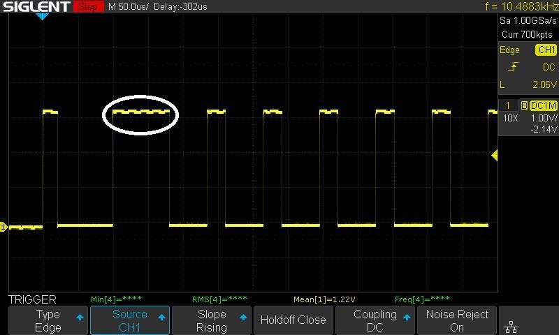

Posts: 6548
Posted: 04:47am 16 Nov 2024
More on the DHT22
I compared the timing between RC9 and RC15. I cannot see any difference.
When I attached the CRO leads, I was able to get valid readings some of the time.
Looking at the trace, the ripple at 3.3V is visible on RC15 but not there with RC9
I have tried shorter leads and capacitors on the data line and it worked, some of the time.

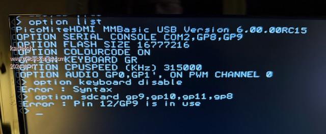

karlelch
Joined: 30/10/2014
Posts: 335
Posted: 04:47pm 16 Nov 2024
Hi,
I have a question regarding the PS2 keyboard in the HDMI/USB 2350 version. I was playing with the Solder Party RP2350 Stamp with carrier board (see also this thread and "PicoMiteHDMIUSBV6.00.00RC15" works out-of-the-box with HDMI monitor and USB keyboard.
The problem is, to activate the SD card, GP9 is required on the carrier board:
OPTION SDCARD GP9,GP10,GP11,GP8
and (as described by Sasquatch) works for the HDMI only version ("PicoMiteHDMIV6.00.00RC15")
However, the "PicoMiteHDMIUSBV6.00.00RC15" firmware complains that "Pin 12/GP9 is reserverd on startup" - used by the PS2 keyboard, which is not needed when using a USB keyboard - or am I wrong here?
OPTION KEYBOARD DISABLE
generates an error ("Error : Syntax") in the HDMI/USB firmware, but not so in the HDMI firmware.
Shouldn't it be possible to disable the PS2 keyboard also in the USB version?
What am I missing?
Thomas
