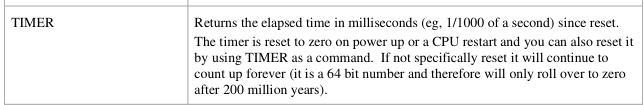

  bfwolf said  From the latest manual:
Can TIMER be used as a COMMAND?
It can be used as a variable (timer = 0 etc) but I tried
timer 0
and got Error: Syntax
(using mmb4l)
Posts: 5994
Posted: 10:15am 03 Mar 2025
  matherp said  What a convoluted way of doing something that is fully supported
TEXT 10,200,str$(timer,3,0,"0")
ACKn,
There is a better way. I will use it.
But why does the convoluted way not work ? Is there a hidden snag, I was not aware of, or is there a flaw in the implementation ?
dddns
Joined: 20/09/2024
Posts: 875
Posted: 10:34am 03 Mar 2025
It does!Try
Str$(timer,0,0)
