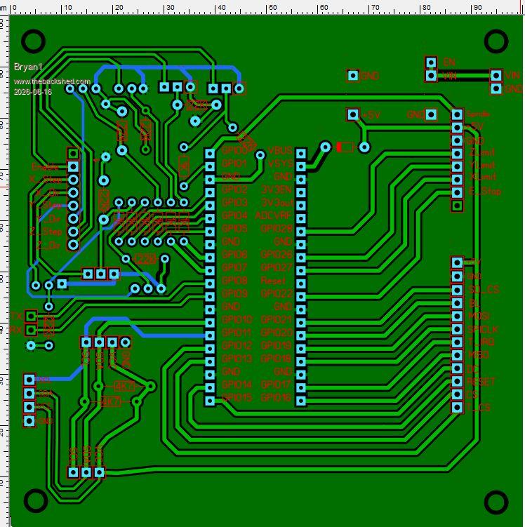

Now I did put in my setup code Enable is GP0 on the Z axis and the enable is hard wired to the X and Y axis. Now when I start the code the stepper system stays in idle mode as indicated by my programmable power supply. When I take off the dupont connector for the enable the stepper system comes active.
Now a few times I have found after doing a few tests the power supply drops to 8 volts and the 1.8amp max current is reached also the red light on the power supply is indicating the error.
Do a reboot leaving the dupont enable disconnected and all is well then many times the touch stops working so I did a GUI test touch until it does respond.

Just looking back over some things and couldn't figure out why the steppers won't enable. This might be a problem:
I think this has the Enable permanently tied to 3v3. Hopefully an easy fix
Regards, Lyle.

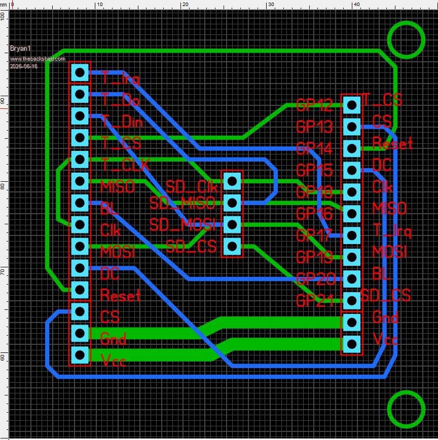

Ok finally found some time to get back on this project and I've soldered up the lcd board but can't get the lcd to work.
Now when I type in backlight 2 the display does dim but trying to do the bubble test I'm just getting static on my shed radio and the lcd isn't showing the bubbles. So I did try the ST7796SP one as the ST7796S didn't work and it's still the same.
Now I have traced every connection and found no errors in the wiring.

Now when I first tried I typed run and the stepper system did arm and with the enable connected it did stay unarmed so the board is OK.
I did think it could of been that old AAA 4 cell case as it old and rusted a tad so swapped it out with a 10 volt DC in plug pack but still no change. Got 5V on the 5 pins too so not sure what is going on here.
Regards Bryan

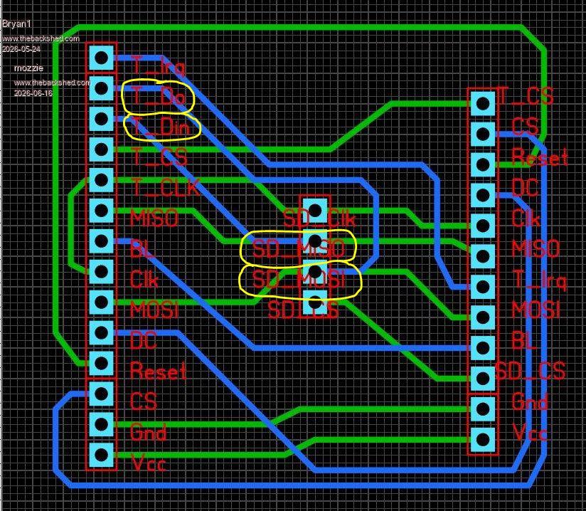

mozzie
Joined: 15/06/2020
Posts: 469
Posted: 03:07pm 15 Jun 2026
G'day Bryan,
Good to see you making progress, I have been munted by the flue (or something) for the last week, very nasty
A close look at the LCD PCB and it looks like:
MISO is connected to Touch-DIN
MOSI is connected to Touch-DOUT
This could be causing some grief
Regards, Lyle.
Bryan1
Joined: 22/02/2006
Posts: 2297
Posted: 03:22am 16 Jun 2026
Thanks for pointing out that mistake I made Lyle   I changed the SDCard 4 pin header to a 90 degree pin setup and put it under the pcb then cut both tracks and soldered in jumper wires the correct way.
I did put V3.00RC19 on and doing B: files did show the SDCard contents but trying to set the time on the RTC is still going the "not found" error.
Now as the boards only cost $3.50 for 5 of them   I'm going to get on and correct the error of the SPI lines which should make a nice no bones backpack for the LCD's.

Posts: 3416
Posted: 05:23am 16 Jun 2026
The 3 I2C sockets are wired correctly to each other but are the wrong way round at GP10 = I2C2 SDA & GP11 = I2C2 SCL.
If you consider getting new boards made perhaps add a ground pin to the bottom socket.
While you are at it there appears to be room for pads for pullup resistors on SDA and SCL. You may never need to install the resistors but it costs nothing to add the pads, just in case.

Posted: 06:26am 16 Jun 2026
Ok it does seem these grey cells got both boards all wrong so just got on and ammended the mistakes on both boards.
Now with the LCD board moved the silk screen for the SDCard connector so one can see them and swapped over the SPI lines.
On the stepper board corrected the I2C lines, put in pullups also put GP1 which is the Enable pin to ground as tying it to Vcc stopped the steppers being armed. Also with the step and limit connectors added a non connecting pin to make them a 8 pin socket as 7 pins sockets aern't around.
Also one thing I need to do with every board which I neglected to do was put in mounting holes so they were added.
V2 Stepper Board
V2 LCD Board
Now rather than rush ahead and order these boards if I have gotten something wrong again could it be pointed out please.
Regards Bryan
