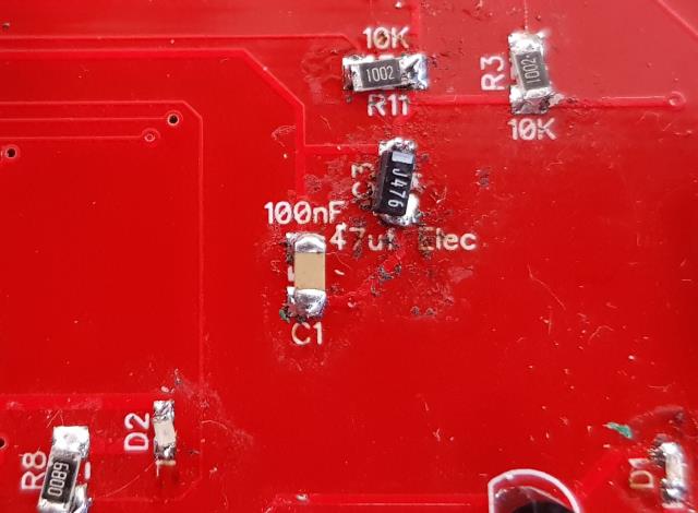

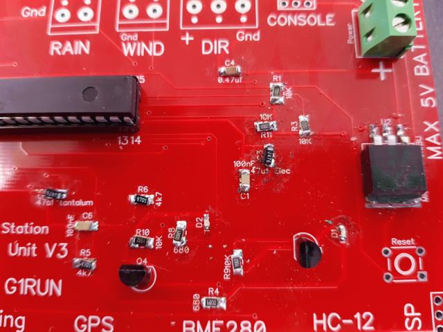

Could my soldering be the reason this board isn't working?
I "attempted" to solder SMD the other day to save someone having to do it yet again for me but I failed, it doesn't work!
Guess my eyesight and hand/eye co-ordination isn't what it used to be - I "used" to be a tv tech years ago and was able to solder smd back then!
Good examples of how "NOT" to solder

Some of those SMD joints look a bit suspect but may be OK, just becuase they are not square doens't make them bad joints. Check both side are soldered and they are not bridged under the compement to short it out.
You should check the 5V rail at the processor socket (chip removed) preferably with a scope to see if it is clean with minimal noise but a meter will suffice.
You should also check that cap under the processor, if it is the one connected to pin 20, it is supposed to be a tantalum 47uf or usually a 10uF X5F non polarised ceramic. It looks more like an electrolytic which won't work properly.
Other things to try, does the MM work in another board (shows it is programmed and working correctly).
After those thing then normal checks like reset line and any stuck pins will depend on your experience and available tools.

It's alive - no idea how but it is
I resoldered the tantalum cap connected to the MM and put 3mm led's on the board instead of the smd ones and it now works
Miracles do happen!
