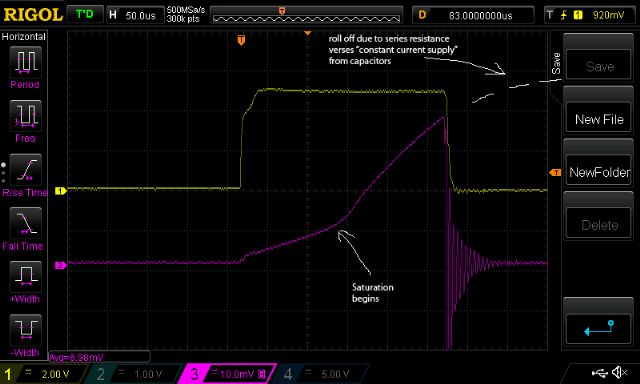

Here is what saturation looks like:
One part of the (pink) curve rises at a low rate, then it changes to a faster rate of climb when saturation is becoming prevalent.
Yellow is mosfet gate drive, pink is current, approx 1mV / Amp
In my tests I frequently find inductors level out at some sort of current.
In the case of the above, it's at about 45 Amps. This is due to series resistance of the circuit (inductor ESR plus mosfet Rds(on) plus wiring plus capacitor ESR)
Posted: 04:10pm 03 Jun 2017
That final leveling out effect appears to be the power source dying in the bum.
If you build a ramp up / ramp down type tester, the current keeps rising at an ever increasing rate until mosfet turn off.
But your waveform does illustrate the point of the smoothly rising ramp, and the initial upward bend very nicely, which is the point we are interested in.

power source dying in the bum = significant power source impedance
I hinted at this with the sum of (inductor ESR plus mosfet Rds(on) plus wiring plus capacitor ESR)

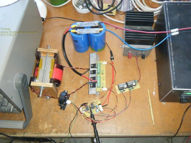

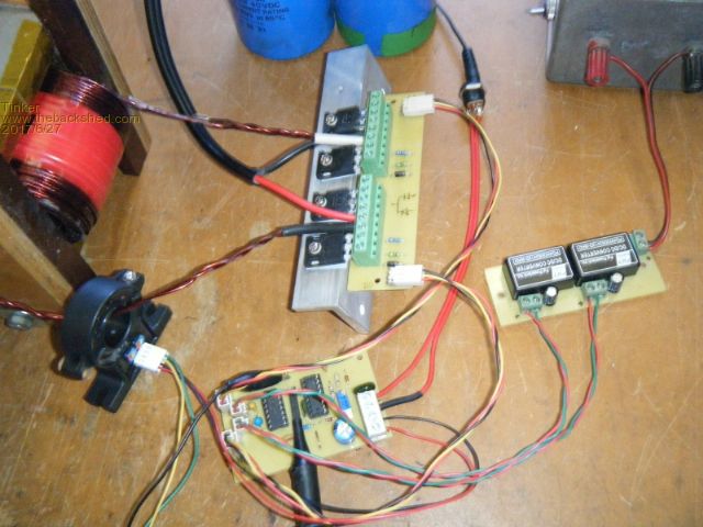

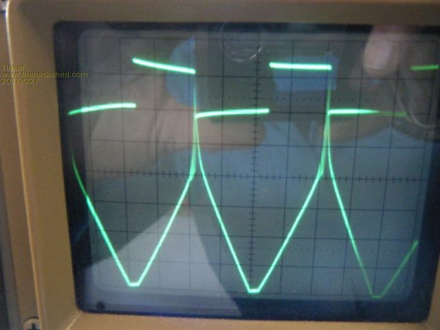

After Solar Mike has been doing some choke saturation testing I just had to try that myself
The approach was a bit different, I split the circuit into a driver PCB and a power PCB.
That used up some small PCB offcuts and also made the connecting a little easier, IMO anyway.
Here is a picture of the test set up:
And another, showing details better:
Testing was done with my choke (2 x C ex Aerosharp)cores epoxied to a plywood backing and hardwood side bits. This made a very strong 2 piece core assembly, which let me easily insert the wound coil and also change the air gap spacers.
The coil was wound from recycled 1.8mm dia wire (2.5mm sq) which I wound on 2 in hand, simultaneously. I did this on the lathe, manual powered chuck and the tool post clamping the wires to wind with an even strain.
125 turns were wound on, why 125?. I had two skeins of 500g wire and these gave 125 turns 2 in hand .

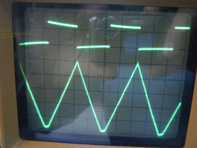

Test 1 with a 2x 0.8mm gap (laminex pieces) got to saturation at 10A, giving 1250A/t
Test 2 with a 2 x 1.2mm gap (plastic sheet) got to saturation at 12.5A, 1562.5A/t
Test 3 with a 2x 1.7mm gap (original gap spacers) got to saturation at 20A, 2500A/t
All tests were done at 52Hz.
Here are a couple of CRO pics - sorry about the poor quality.
Pic just before saturation:
And this one with saturation:
Its quite obvious when saturation occurs, the noise from the coil also changes.
Note, the pics are not with the same air gap. These were just the clearest pics of the bunch I took
Nothing got even remotely warm even when left running close to saturation for a while. The trace is also nice linear, which I like. So these cores seem to be suitable.
They are made of a quite flakey material, not laminations, so I epoxy coated them to prevent material coming off each time they got assembled.
From the above results the following coil will be wound shortly:
One layer would accommodate 18 turns of 1.8mm dia wire, wound two in hand (5 mm sq).
A total of ten layers would give me 18 turns of 50 mm sq. This would fit nicely and give me the maximum copper/ turn ratio for that core.
I shall find out what inductance that makes when its finished.
18 turns would saturate at 138A, that's almost 7.5KW from my battery bank and a power level that I don't plan to get near once that inverter is finally running.
My thanks go to Warpspeed and solar Mike for their valuable contributions with this choke core saturation testing.
Posted: 11:56pm 26 Jun 2017
O/k got that Klaus.
On time pretty close to 9mS I think.
Twenty amps peak.
125 turns.
What was the applied dc voltage for that ?Edited by Warpspeed 2017-06-28

125 turns.
Ha, did not write that down Tony. I'll repeat the test tomorrow and note all the details.
