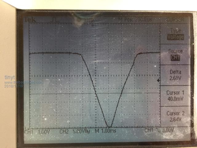

One thing that puzzles me is the mains sync pulse.
It seems to me I will get a low level input at AC zero crossing.
I can't determine which 1/2 of the waveform it is.
I think we get a low level pulse each 1/2 cycle.
This is not enough information to phase lock.
I hope the mains sync feature will only be used in totally isolated
systems. It must never be connected to street power.
Would I be right in thinking mains sync will be used to coexist with
an isolated grid tie inverter system?

Here is scope waveform of the EXT_SYNC with the isolated transformer driven at 60Hz. (sorry for the dirty 'scope, I need to clean it). This was taken from my experimental inverter. Note the clamping of the Atmega328 on chip clamp diodes. Based on Atmega328 datasheet I/O pin threshold, it is around 2.6V at VCC of 5V. So I set the cursor to it.

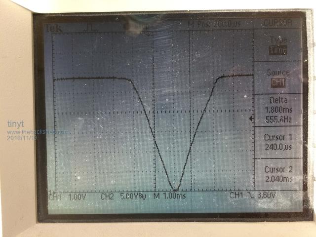

Next picture is with the cursors changed from voltage to time showing delta of about 1.8 (should be around 2.0) milliseconds at the falling and rising voltage thresholds.
Based on Atmega328 datasheet, if you set IECRA bits:
ISC01 = 1
ISC00 = 0
then interrupt will happen at the falling edge. For 60 Hz, if the code wants to know the actual zero crossing, it will happen about 1.0 millisecond after interrupt.
