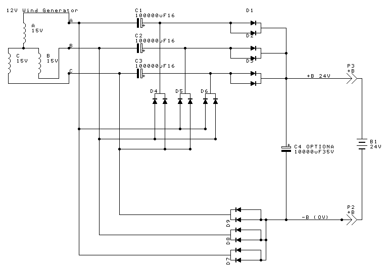

I see there was a post by user spacejunk on Fieldlines some time ago about using a voltage doubler on 3 phase, different circuit.
http://www.fieldlines.com/story/2006/6/19/143035/964
I searched for "3 phase voltage doubler" in google and found a few interresting circuits.

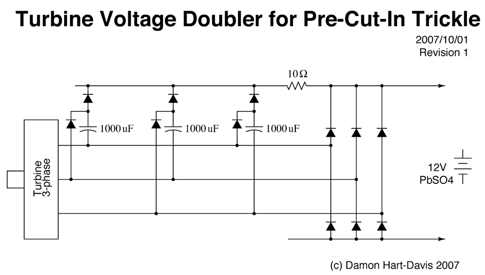

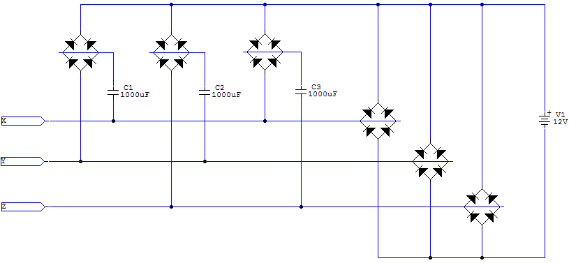

I've redrawn the above circuit using bridge rectifiers.
Uses 6 bridges, but each bridge is using its internal diodes in parallel for increased current capacity.
This circuit above, ( drawn by Damon Hart-Davis ) also shows polarised capacitors. Now I have a feeling this type of voltage doubler can use polarised capacitors, and lower voltage than we have been using, so long as the mill is always loaded and never allowed to free wheel. The circuit a couple of posts up, posted by spacejunk, shows polarised caps rated at only 16 volts. If this is the case, then this type of voltage doubler would be very cheap to build.

OK, can one of you bright sparks please post an image of the voltage doubler and tripler arrangement in the Gordon/ OZ-Flux capacitor method?
Oh and I read somewhere else that in the back to back cap idea it didnt matter if they were neg to neg or pos to pos, please confirm as it looks like I stuffed up and wired neg to neg.

Hi Glenn,
you missed the important resistor in this arrangement. As the mill AC increases to normal rectifier cutin, the caps will present a parallel load across the windings. The resistor prevents high currents, and is a loss.
In the spacejunk cct, I see 100,000uF caps. These would present close to an AC short cct at even a modest 20Hz. I see voltage doubling, but the loading presented will not be optimum for the windmill in changing wind conditions.
Arrangements with multiple seriesed caps present high impedance at low Hz and pass low power. OK for high voltage bias ccts.
I have found an arrangement that can give a close to optimum windmill loading.
Gordon.

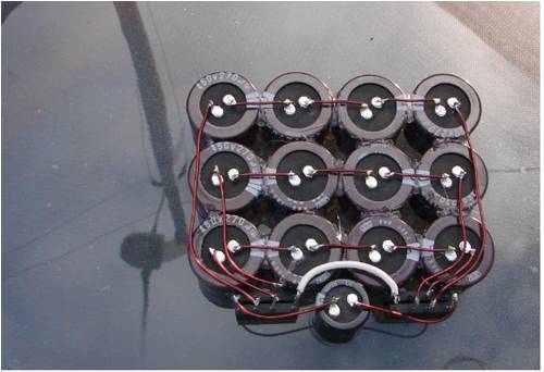

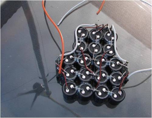

Here are some pics of a cap voltage trippler and a cap voltage doubler that I recently assembled. I used the 270uF 450V doubler to get the measurements for Herb.
This is the doubler. 270uF 450VDC caps with 25A 600V bridge rectifiers.
This is the trippler. 100uF 400VDC caps with 25A 600V bridge rectifiers.
With my arrangements there can only be a maximum 1/2 the AC windmill output voltage across the caps in a voltage doubler, and 1/3 the maximum AC windmill output voltage in a tripler. This reduces the stresses on the caps. Part of the more optimum windmill loading is related to not pushing the caps too far.

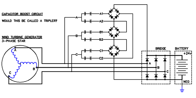

sketch of the tripler circuit anyone???

Would this be a correct diagram for a "Tripler"?
Is it possible to correct or delete this circuit diagram if it is wrong, in case someone comes along later and tries to build it?
Yes Steven I can do that if required. Glenn.Edited by Gizmo 2009-11-30

Hi Sparweb,
In a cap voltage tripler, I use 18 caps, DC type in the back to back arrangement. The arrangement is really 3 AC coupled series cap loadings with the rectified outputs placed in series, instead of 2 as in a voltage doubler. In my arrangement the phases are loaded equally in each cap section.
I have been looking at the arrangement you have pictured above. You have non symetrical adding of the voltages in each rectifier block, but my testing still shows a voltage tripling effect.
I am sure that there are many arrangements that will work. The output voltage was not as stable as with a full 3phase bridge arrangement, but this abridged version should still be OK for the low power that would be expected that the caps are required to pass. The individual capacitance for 12 caps in a tripler will need to be 1.5X the size of those used in an 18 cap arrangement to offer the same loading. The loading offered by the caps is determined by the capacitance, and the voltage developed across the caps.
I would leave the cct as it does perform a similar function.
Gordon.
PS: As long as readers remember that the caps do not necessarily double the rated windmill power. The better loading offered to the windmill is the objective.

Thanks for the check Gordon.
I want to model it with Spice and see what it says for various cap values. Now that I've drawn it myself I understand it a lot more, too.
