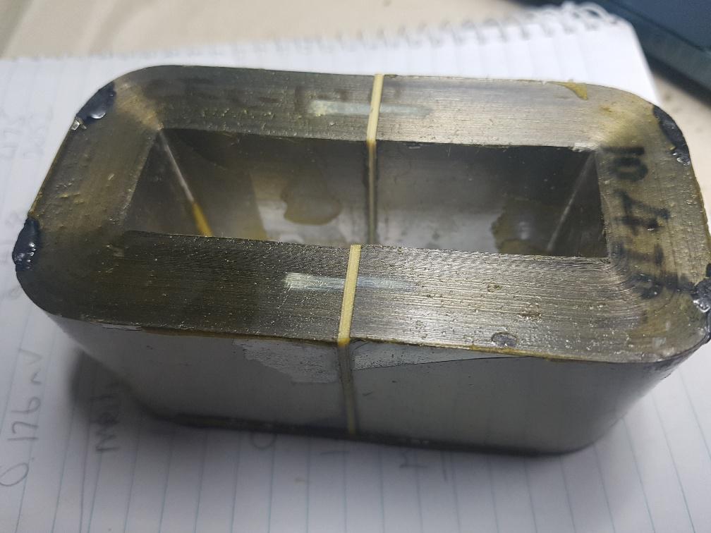

  SYM-1 said  That aerosharp core.  We don't seem to have any here.  Is it a toroid?  Is it powdered iron or something else?
Grant, these Aerosharp chokes are wound silicin steel U cores as you can see in the above picture.
They are made from the exact same material as our beloved large inverter toroids, but are wound around a rectangular mandrel, instead of a round mandrel for toroids.
These "rectangular toroids" are then sawn in half, and the mating faces ground to a mirror flat finish.
This is the right stuff, but its from some unknown Chinese company I have never heard of.
Grant
Here is the "large Aerosharp core".
Note the very thin laminations. This is
not a 50 Hz transformer's laminations as we know it, Jim.
This is really thin silicon iron sheets, that permit it to work at rather
higher frequencies than 50 Hz.
And see the gap, that is very important.
No gap means not much use for this project.

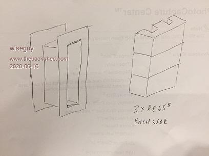

Poida, Today I ordered some sets of EE65 ferrites from Neosid @ 11.10 + GST each.
3 sets are about $37 total. On paper they should handle more energy ~10-15% more than two of the EE70 core sets.
I am currently designing a 3 stack bobbin using PCB material that will solder together at the edges/seams and our great Chinese friends... to manufacture, 10 bobbins for ~$14 total ($1.40ea) + freight. For those that cant picture what it should look like I have done a quick scribbled sketch which may help.
This could be a reasonable cost/performance contender.
I have also asked them for a list of readily available lowish cost large sendust cores from their overseas suppliers, for toroidal choke experimentation, to avoid long lead times.
So much to do so little time available.....
I forgot to add that if the gap say for the centre pair of E's is less than the other two it would perform much like the swing choke, better at lower energies whilst still retaining a high saturation ability.
Edited 2020-06-16 21:37 by wiseguy

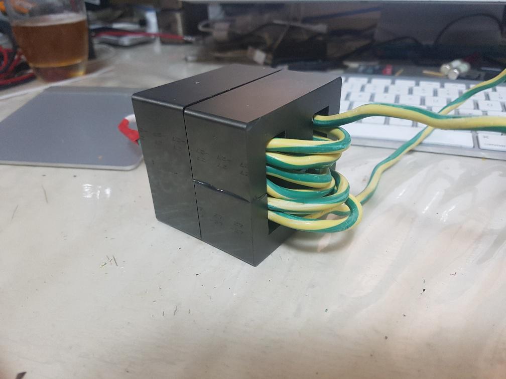

More tests.
2 x small, gapped N87(?) E cores
62.6uH, 7 turns.
In 107.1V, 20.2A, 2163W
Out 48.0V, 42.2A, 2026W, 93.6%
28A ripple. No saturation and a good candidate for the project
looks like this:
2 x N27 E70/33/32 E cores with hand crafted 1.5 - 1.6mm gaps.
(the $26 a set items from RS Components)
58.4uH with 6.5 turns
In 106.8V, 20.1A, 2147W
Out 48.0V, 42.0A, 2016W, 93.9%
30A ripple. A bit too high.
so I made it with 9 turns.
99.1uH, 9 turns
In 106.7V, 20.3A, 2166W
Out 48.4V, 41.9A, 2028W, 93.6%
15A ripple.
This is a $52 inductor that will work fine at 2500W and 110V input.
Give it 9 turns of whatever fits in the gap and you are good to go.
15A ripple at 2000W and 110V is excellent.

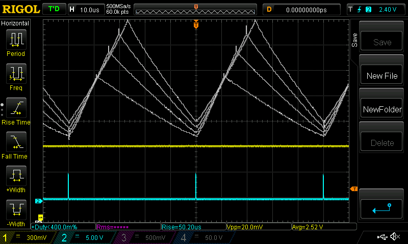

  renewableMark said
Maybe try one set of the ungapped next to the other 2mm gapped set, that would be a little like Warps swinging choke wouldn't it?
Here are the two inductors and how they perform.
110V input, 20kHz pwm, 1 Ohm load.
First is two with 1.0mm gap each. Two of the E cores, 6 turns, 66uH
the White lines are current at 500,1000,1500,2000,2500W
Blue is pwm, Yellow is current.
We don't need to know the scale, but it is 0.3V/div and 0.197V/Amp
Zero current is the 4th line up from the bottom.
We clearly are seeing the start of saturation at 2500W.
but I would be happy to run this inductor in a build of the 45A mppt controller.

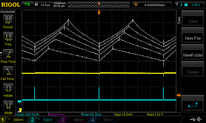

Next, I undo everything, and make one E core with zero gap and another with 2.0mm gap. Just as you wanted to see.
I then put 6 turns around the inner leg, so it's the same as the above test.
This gives an inductance of 425.5 uH
This would seem to be really much more better-er than anything because it's
425uH and I have shown about 100uH is pretty much spot on.
More is better, right?
I did not bother going to 2500W, we can see where things are heading already at
2000W. Not good.
At 2000W there is a 60Amp swing.
What is happening is the zero gap E core saturates with little power, becoming an expensive short circuit, leaving the remaining 2.0mm gap core to just do something already.
With only the 2.0mm core and not many turns, we see clearly the result of low inductance. i.e. very steep current traces.
This is not in anyway a definitive proof of the worthlessness of Warp's recent comments on the subject. A stepped gap might be quite useful here.
I don't know how to built one and test it.
So far I am content with a single gap width of something with a suitable permeability. We get a straight line for the current as the voltage is applied to the inductor.
This is beer-driven Electronic Engineering research. Lucky there is some in the fridge.

I found some silicon steel cores on alibaba.  Can anyone tell me the dimensions required?
Persistence is the key
poida
Joined: 02/02/2017
Posts: 1497
Posted: 04:35am 20 Jun 2020
  SYM-1 said  I found some silicon steel cores on alibaba.  Can anyone tell me the dimensions required?
The one shown in the above post
is
15.75mm thick
103mm long
53mm wide
46mm high
approx 15.75mm radius at each of 4 corners
