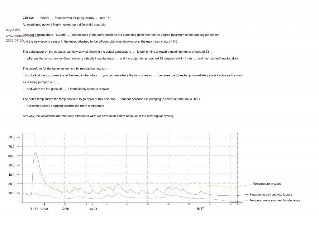

  Warpspeed said  Fantastic progress there Roger, it might need a little tweaking still, but basically sounds like you have a goer.
Thanks Tony, and yes I've bumped it up one degree for each  ...  Ld 11 degrees and HD 16 degrees.
With the room at 16.6  ...  it turned off with tubes at 27.5  ...  and the outlet was at 26.0  ...  which is just about right. Much lower and the airflow feels a bit too cool.
Ideal day now for testing as the cloud comes and goes  ...  I see cycles every five minutes or so.
Cheers,  Roger

I haven't posted any charts for a while but thought it was worth showing how things look with the new differential controller looking after things. Thanks Tony.
Hopefully tomorrow's will be better again seeing it can be ready to go with the first sunlight  ...  assuming of course that we do get some.

I don't know if this is a normal winter or not for us over here  ...  but I have been amazed at how many days the sun does shine at least for a few hours  ...  and how few days it is grey and overcast all day.
Another observation is that it doesn't seem to matter how cold the ambient temp is  ...  if the sun shines, we can pump heat.
At present I have 18 tubes and the new one will be 60  ...  so potentially 333% higher  ...  plus being on the roof, will not be shadowed by the fence in the mornings and later afternoon.
It started off early this morning, soon after 8 am  ...  though I wasn't able to concentrate much on what was happening. Seemed like it maybe should have been allowed to build up more heat before it came on  ...  I'll have to look at the data tonight to see if it makes more sense.
I did crack open the logger that sits at the warm air outlet and drilled a hole so the sensor is exposed directly to the airflow  ...  so will hopefully be a bit more responsive.
Cheers,  Roger
It does not need very high tube temperatures to work. As long as the tubes are warmer than the house, there will be heat to harvest.
In fact, the blower will cycle and keep the tubes at a just sufficiently high temperature to work.
That is excellent, because heat losses through the ducting will then be far lower if the warm air coming back to the house was at a much higher temperature.
The whole thing will be much more efficient than allowing the tube temperature to get really high before turning on the blower.
The data logs will tell the story...

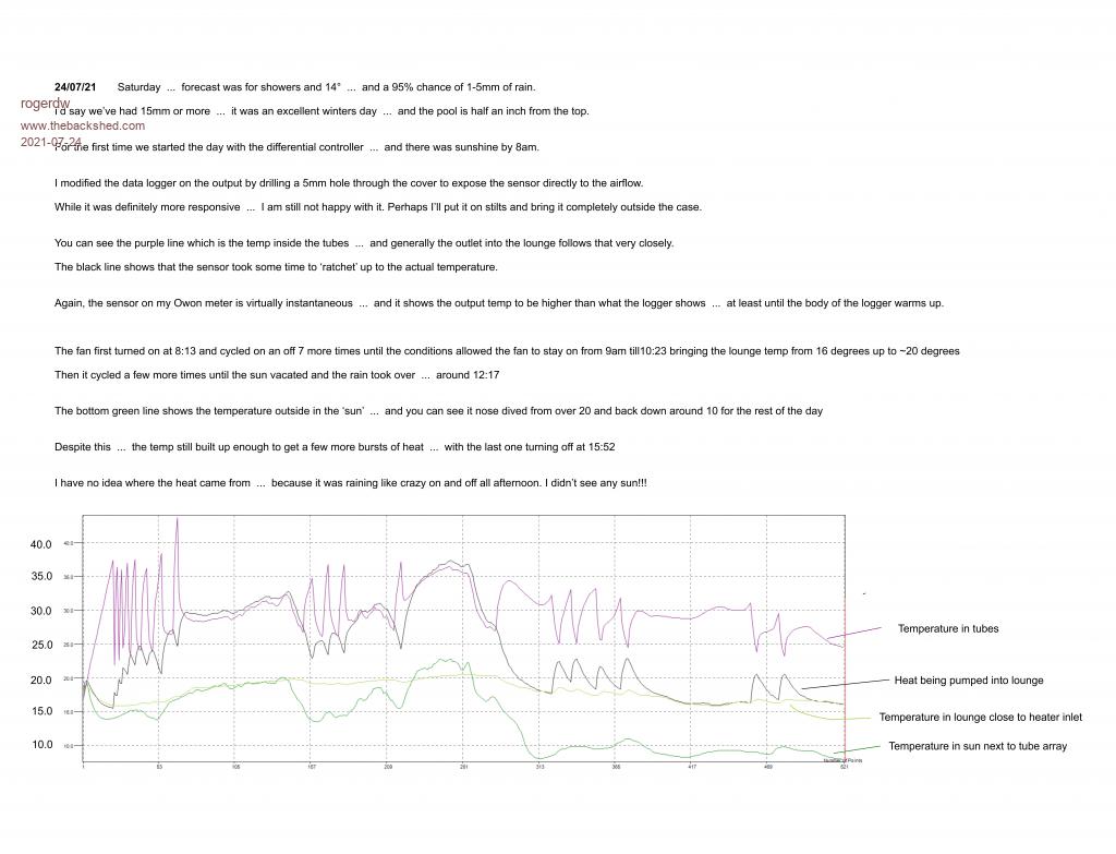

Okay, well I thought this mornings figures were a bit dodgy  ...   but while I had drilled the outlet data logger case to expose the sensor to make it more responsive  ...  and it does seem a bit better  ...  it still seems a little slow.
I might bring it right out on stilts into the airstream to see if that helps.
Apart from all that, it looks like the system is working very well
With the conditions we've had since the rain set in at lunch time, I normally would have just turned it off  ...  but like you suggested Tony, the system still managed to eke out half a dozen more bursts of heat that I would have missed out on.
Cheers,  Roger

  Davo99 said  Looks very Promising!
I'm sure the heat output was not a lot but the fact you got any is the takeaway here.
When the clear days do come, going to be very worthwhile.
Thanks Dave. It did actually start out very well because of the early sun  ...  and took the room from 16 degrees up to just over 20.
Then of course when the change came through and the outside temp dropped considerably  ...  the guts dropped out of it.
I need to address that data logger because I was getting away with its sluggishness before  ...  because it used to have time to catch up to the changes in temperature  ...  they were long slow changes   ...
...  but now that the temp goes up and down over only a 5-10 min cycle  ...  the device takes far too long to respond and reads 5-10 degrees too low sometimes.
If I could use my good meter to log the readings, it would look far better.

Yeah, thanks Tony. Despite being the middle of winter we still do get some great days of sun, even though the wind can be biting. I can't wait for another of the good days to see how this new controller performs then.
I just went out and modified the data logger again and fitted the sensor fully outside the case. I think that is what worried me this morning seeing it still lagging behind the actual temperature  ...  and of course making the graph I showed look poorer than it should.
It's funny how different results can take the edge off the enthusiasm  ...  and then some good ones can bring it all back.
Thanks to you and Dave for all your advice and support, it really helps.

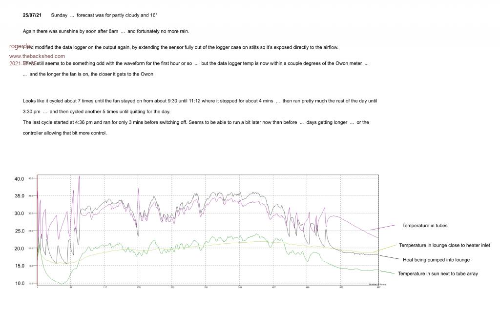

Posted: 02:13am 25 Jul 2021
  Warpspeed said  Wind and a low outside temperature should have little or no effect, the only real killer will be big black nasty clouds that block the sun.
Yes, that seems the case.
What surprises me most is it doesn't seem to need direct sun either  ...  just light  ...  though of course the output is not that spectacular until the sun pops out.
My modified data logger is working better than yesterday  ....  much more responsive  ...  though still 2 degrees below for a minute or so  ...  and finally as close as .5  if the fan runs for long enough.
Looking forward to seeing the chart tonight.
Cheers,  Roger
Posted: 02:54am 25 Jul 2021
If your logger uses thermistors, try getting some of the really small bead thermistors.  These have a very short time constant, well under one second.
In fact they are used in hospitals to detect breathing by sticking one up your nose.
They are that fast and that sensitive.
Just a random thought Roger.
The relay in your differential temperature controller will probably work fine for years, but the motor inrush current might eventually burn the contacts.
If you fitted an external relay to switch the motor current, it would be a lot simpler and cheaper to replace if it ever does eventually suffer.
A solid state ac relay would be the bee's knees.

Here's todays figures. Was a nice day  ...  cool enough, but sunshine on and off all day.
Nice to see the lounge temperature go from 16 degrees up to 22 degrees.
The charts are certainly quite different to before fitting the differential controller, with the switching on and off until the sun is sufficient to allow the fan to run continually  ...
...  and then later in the afternoon as the sun reduces and it comes in cooler  ...  then the fan switches in and out again until it gives up for the day.
Another thing I should mention is that I have had the fan switched to high speed ever since fitting the differential controller. Just about all my graphs in the past were with the fan on the low setting  ...  except on really sunny days.
Something that seems odd is the temperature of the outlet into the lounge is higher than the temperature in the tubes during the middle of the day. Not sure how or why that is happening.
