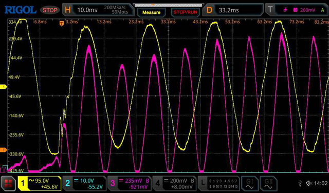

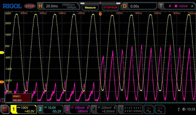

Here is a capture of the Inverter AC from a power point in the shed, trigger is at the point of switching on a 2.4kW Jug, the Inverter ticking over at 600 Watts as the Jug is powered on.
Yellow: Inverter AC Output from a power point in the Workshop:
Other Color: Hall current Sensor output from One Power Stage
Both stages are equal and each stage is drawing around 60A DC peaks for a total Peak DC current waveform of 120A @ 100Hz.
AC load jumps to 3kW  - Not a single blink, even continually flicking the Jug on and off.
Below:
Bandsaw 428A Peak DC current waveform @ 100Hz. Unlike the higher current Dust Ext, this sometimes gives the slightest flick in the lights. Things like the belt driving the lower steel wheel chirps as it slips slightly, can affect the load on the induction motor during startup.
This is the worst case startup waveform I've managed to capture for the Bandsaw, depends on where in the cycle it starts.
On the 1st cycle, AC dropped from 235v 218v, back to 230v by the 3nd cycle, and over 230v after the 4th cycle.
30,000uF high current screw Caps in each power Board hide and modify some of the initial current surge, the Hall Sensor does not see the current drawn from the PB Caps, and "each" Cap can easily deliver over 1000A if shorted - they can have some dampening effect on the Hall Sensors for the first cycle or so.
NOTE: Flat topping on the AC waveform is harmonic distortion from the other loads that are running, it's exactly the same on Mains AC.

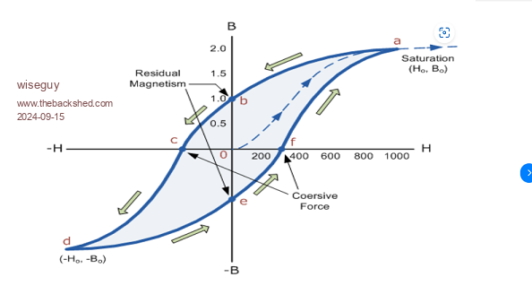

  phil99 said
Residual magnetism can contribute a little more but they have good quality GOSS which holds little residual.
Your own experiment shows a 1.5V cell can reverse it in a quality toroid.
A great deal of work went into minimizing residual magnetism in GOSS as having to reverse the residual every half cycle causes a power loss.
Look up B-H curve Hysteresis Loop. The points where that loop crosses the B axis are the residual magnetism. The area enclosed within the loop is proportional to the energy lost in each cycle.
Your cores run cold indicating there is little power lost there and therefore little residual magnetism.

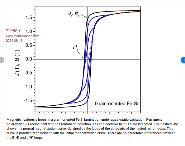

Phil, whilst I agree with almost everything you said I am having a problem with the gist of the last few sentences re residual magnetism.  In the interests of education (me included) I looked up graphs of BH curves & residual magnetism. I believe the focus was initially related to the heating or lack of it in KeepIS's Toroids
First a BH curve that shows soft iron and non silicon steel typical magnetic behaviour.
The curve shows as you stated the residual magnetism when the magnetising force is reduced to zero at the point where the graph crosses the B axis & shows maybe 50% residual magnetism. The excitation was ~ 2 Tesla, the remanence is around half that value.
Now a graph showing a typical silicon steel BH curve.
This graph shows saturation at around 1.8 Tesla but the remanence where the B axis is crossed is much higher at around 1.5.
I agree, the area within the BH loop is related to losses and heating and compared to the first graph the BH area is much reduced.
But there are a couple of other things to mention further, one is that we usually aim for ~ 1 Tesla in our transformers so we are well away from saturation and the BH area is thus reduced accordingly.
The second is that from the graphs it appears that we can change the flux in the cores with realtively small energy input due to its permeability.
The second silicon core hysteresis diagram shows higher retentivity of the material and it is closer to the saturation point. Little extra additional flux (in the same direction) would put the core into full saturation which from the graph shape is a very hard saturation.  In my experience, big Toroids can make a hell of a thump and trip circuit breakers which I think also goes against "little residual magnetism"?
This response is not to argue, as I am open to being corrected if I have misinterpreted the graphs etc, I don't care as much about being right or wrong, just keen to better understand the black art of magnetics.
"A great deal of work went into minimizing residual magnetism in GOSS as having to reverse the residual every half cycle causes a power loss".
Could it be more correct to say that a lot of work went into making GOSS material where the intrinsic magnetic domains were more readily/easily influenced (demagnetised/remagnetised) to counteract the otherwise high residual magnetism each cycle thus reducing power loss?
A comment about the 1.5V cell, which could theoretically supply a current of ~ 15A with a 0.1R impedance & with 200Turns, that is equivalent to 3,000 Ampere turns which sounds significant from the 1.5V cell ?  The cell should be able to cause saturation I think in either direction ?
Your further comments would be appreciated.

Working backwards, the 1.5V cell use may well have an internal resistance greater than 0.1Ω. A repeat of the test with an ammeter in series with a similar size/type cell would be needed. Putting a multimeter straight across a new alkaline AA cell gave 5.9A.
"Could it be more correct to say that a lot of work went into making GOSS material where the intrinsic magnetic domains were more readily/easily influenced (demagnetised/remagnetised) to counteract the otherwise high residual magnetism each cycle thus reducing power loss?"
Yes that is a better description
The graphs would have been clearer if the loops were in different colours. The smallest loop they show is for 1.1T so is closest to what you use and shows a residual of about about 1/3 of the maximum, and requires little energy to reverse.
"In my experience, big Toroids can make a hell of a thump and trip circuit breakers which I think also goes against "little residual magnetism"?"
They can indeed make a big thump and trip circuit breakers and the residual is a contributor but the main cause is the duration of the initial half cycle. An ideal inductor draws no current at switch-on, no matter what the voltage, then rises at a rate determined by the voltage, for as long as the voltage is applied.
For an ideal inductor and a sine wave (starting at 0V) by the end of the first half cycle it will have risen to double the normal peak value. For an iron cored inductor that is the main thing that pushes the core into saturation and massive current spike.
For a cosine wave (starting at Vmax) the available rise time is 1/4 cycle so the current can only rise to its normal peak value. No saturation.

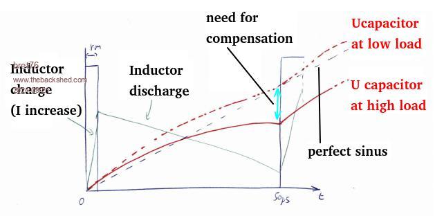

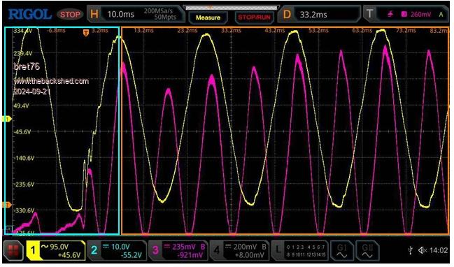

Let's say blue rectangle is before PWM modification (PWM at idle) and orange during big load (PWM increased).
Dit the arduino send the new PWM signal at the top of the sinuzoide where the blue and orange touch ?

No, that's hardly half cycle from the trigger point: TP = "slight increase in DC current to the power stages".
It's more an indication of the quality of the capacitor banks on each power stage, plus the stiffness of those twin "three stack" Toroidal transformers, and the efforts to minimize "unwanted" loss at every point from the Power stage outputs through to the AC output from the Toriods.
However there is some design loss due the the purposeful use of a smaller gauge wire for the 4 chokes.
After that you are seeing the very low loss between the Battery banks and the DC feed to each power stage as that initial current discharge from the caps is picked up fully by the DC supply.
I would think by the 2nd or 3rd cycle, the Controller could have started to regulate the AC output.
I would have to go back and look at the amount of filtering and design attack time for the VFB signal to the Nano. I simply don't remember.
This is why there is not the slightest indication that we are running on the Inverter when an even bigger DC input surge of almost 600A starts up, it does not blink the lights.

How I interpret that waveform display is as follows. The violet DC current waveform just after the idling first 2 left hand side small peaks is where the load was introduced.
The DC input current reached a maximum at the point where the blue and orange touch.
The voltage of the yellow waveform (AC volts out) has started to sag and continues to sag further for the rest of the next half cycle. The input current dip after the first maximum peak I assume is because the capacitor bank was initially supplying most of the current. However the next few input current peaks are increasing along with the output voltage so it appears that the feedback voltage is starting to correct now by increasing the PWM over these cycles.
About 6 current cycle increases after the first minimum it appears the voltage and current have now settled and the sudden load has been corrected for.  This indicates that from the point where the blue and orange coincide within about 3 complete cycles the load has been corrected for.
EDIT: Whoops I started the reply before tea and finished it afterwards in the meantime KeepIS has responded to your question similarly.
Edited 2024-09-21 19:39 by wiseguy
Cheers Mike
bret76
Joined: 03/02/2023
Location: France
Posts: 19
Posted: 10:25am 21 Sep 2024
I'm just interested in the small ripples in the blue square.
These appear just when the big load is switched on.
I understood that the Arduino code calculates an error (following the trigger point? I don't have the code, just the picoverter code), then corrects the PWM of the sinusoid every 100Hz. So depending on the trigger point position, the PWM update may be delayed.
If I rephrase my question in more adequate terms:
did these ripples disappear when the Arduino adjusted its PWM or is it a coincidence?
Sorry if I'm not clear enough or if I misunderstood / misinterpreted. I'm trying to understand the overall operation, but between my mind and the Austrian translation, bits are lost!!
wiseguy
Joined: 21/06/2018
Posts: 1338
Posted: 12:37pm 21 Sep 2024
The chokes have a resonance formed from their inductance and the output capacitor reflected back through the Toroid. Looking at the first cycle of resonance immediately after the turn on event I will guess that is around 0.5 to 1 millisecond for a complete cycle. This translates to a resonance of somewhere between 1 & 2 KHz.
I did see this effect very early on in my inverter investigations. It is not a fault and it is not the Arduino doing any corrections just an artefact of the inverter output stage configuration.
I believe the capacitance reflected back is 4.7uF, but it is increased by the square of the 1:8 turns ratio or 64 times. the inductor is ~ 40uH when loaded heavily, this all calculates to around 1.45kHz resonance when using 1/ (2 x pi x square root of LC), I believe this is what we see on those ripples.
I think the resonance became apparent due to the sudden step change that occurred as the load was energised and the resonance started but as a decaying "ring" that settled after 6 or 7 cycles of a decayed ring.  I hope this makes some sense even with the translation issues.
Edited 2024-09-21 22:44 by wiseguy
Cheers Mike
bret76
Joined: 03/02/2023
Location: France
Posts: 19
Posted: 01:46pm 21 Sep 2024
I have the same feeling, although I express it in a way as I can :
- I am talking just about the first 50µS of the sinusoid for simplicity. At the beginning, the capacitor is discharged, the inductor discharged. I assume that there is no PWM regulation at the moment.
- during "Ton" of the MOFSET, the inductor charges (current in the inductor increases). The inductor always charges with the same energy (because it charges for XXµs).
- during "Toff" of the MOFSET, the inductor transmits its energy (current of the inductor decreases) to the capacitor which charges, but also to the load.
- the capacitor during the charging stabilizes the voltage and the discharge current of the inductor.
- at the end of the 50µs period, the voltage must have "risen" to follow the theoretical sinusoid. Something like sin(n x 2 x PI / 400) x Ubatt
- If the load is low, the inductor will discharge only into the capacitor. The PWM is set for this value, everything is ok. But if the load becomes larger, this energy will have to be distributed between the capacitor and the load. The capacitor will therefore receive less energy. So the capacitor voltage will vary according to the importance of the load (so at each step, we will deviate from the theoretical sinuzoid).
I have the impression that this is what we see here.
Then the controller increases the "Ton" and therefore increases the energy that the inductor will store and everything will be good.
- putting a larger capacitor would improve stability, but would imply a smaller inductance which would require more current to charge, therefore more losses. So it seems that there is a trade-off to be made between losses and stability (in electronician words: to choose the resonance frequency ).
This is what I'm trying to understand little by little....don't hesitate to tell me if I didn't understand anything.
According to the calculations I'm trying to do (L, U, R in parallel), KeepIS seems to have found a very good compromise on its inductance value! And unless I correct the sinusoid every 50µs, I don't see how to do better!
I'm adding a diagram for clarity.
I feel like I'm not playing in the same league as KeepIS, which will soon be speaking in megawatt !
analog8484
Joined: 11/11/2021
Posts: 255
Posted: 05:24pm 21 Sep 2024
Generally more capacitance can help to a degree with tradeoffs as you mentioned.  The case here is just one of many possible examples of distortions due to load disturbances.  A large phase-cut load can cause even worse disturbances.  Given the slow control loop update rate relative to disturbances, the most straight forward (but costly) solution to general load disturbances is to oversize the entire power system not just the capacitance relative to loads.  That's basically what the grid is.  Otherwise, an inverter or active power filter with much faster point-on-wave control loop scheme would be required to compensate for general load disturbances.

KeepIS
Joined: 13/10/2014
Posts: 2294
Posted: 11:38pm 21 Sep 2024
I switched the PC off after my last post last night, I see some great information has been posted, thanks to all.
This info may have been missed on my first post of this waveform.
  Quote  This is the worst case startup waveform I've managed to capture for the Bandsaw, depends on where in the cycle it starts.
I believe that analog8484 was alluring to this, from months of real world testing, some of these disturbances are altered by other loads running on the Inverter and especially the point in the Cycle where the load is started.
Out of dozens of captures of this startup cycle, this is the first time I've captured it quite like this.
The Bandsaw seems to be the only induction motor load that does this, I'm wondering if the Belt slipping (drives the lower flywheel) right at power on (high frequency chirp) and very fast load variation, might be showing up in the AC waveform.
I could start the same load again and the ripple would be hardly seen, normally it's a single glitch or two in the waveform, and it appears to be mainly in the Bandsaw, and it only slips when cold, and it was for that startup capture.
FYI Here is an ever bigger startup from another machine at almost 600A Peak input:
Below: The Bandsaw zoomed in at power up from a previous startup capture.
_
