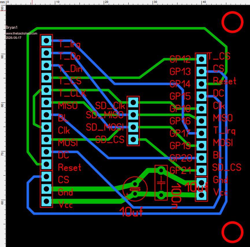

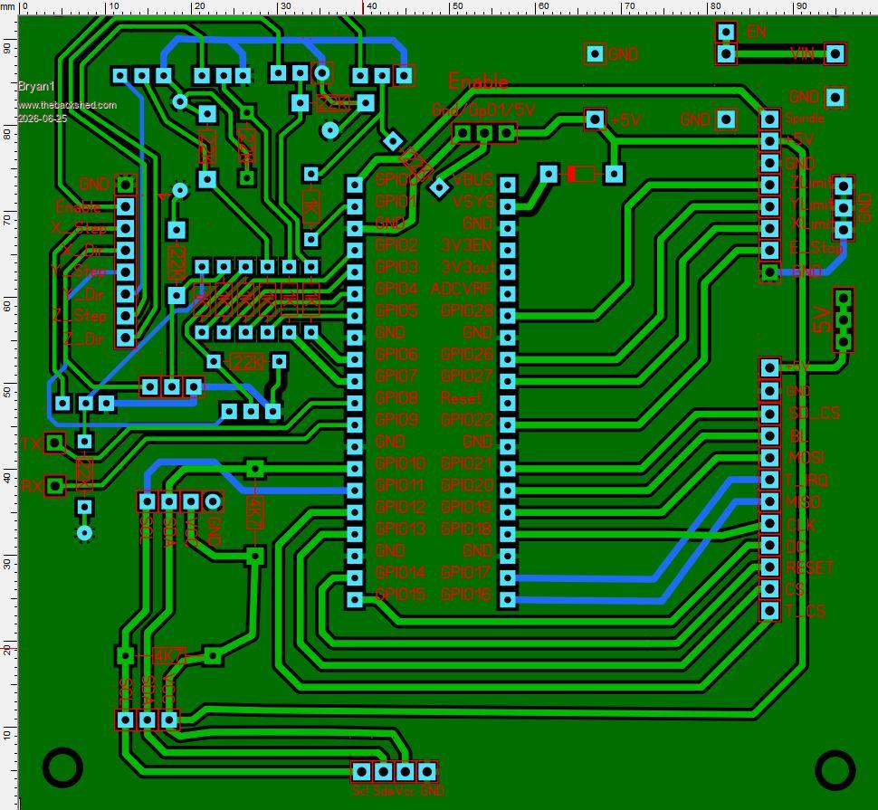

Quick observation: Did you run the DRC?
The square pad looks a bit close to the track.
Also, if the pad remains green, it's not thru-hole (TH) which might be what you intended, dunno.

If you are making changes to the PCB's, a couple of suggestions:
If possible, change GP16/GP17/GP18 on the LCD PCB to match the main PCB, keeping the order of both the same makes fault finding easier. Could also use IDC cable or plug direct while testing.
Add 10uf / 100n bypass caps to the LCD board 5V to GND
Put options for both pull up and pull down resistors on GP1 (enable) for different applications.
Just a few thoughts.
Hard to believe they can produce the boards for that cheap, almost makes making them at home expensive. Can't beat 2 hour turnaround though
Regards, Lyle.

yea I nearly caught myself out today with the missmatch as the CLK is labeled differently so in the morning I will take all this onboard when I revisit  Sprint Layout.

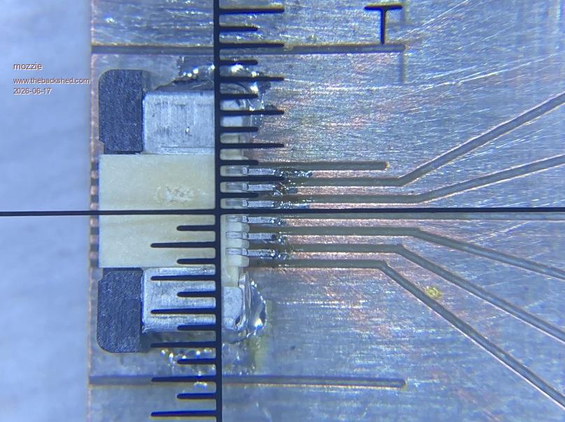

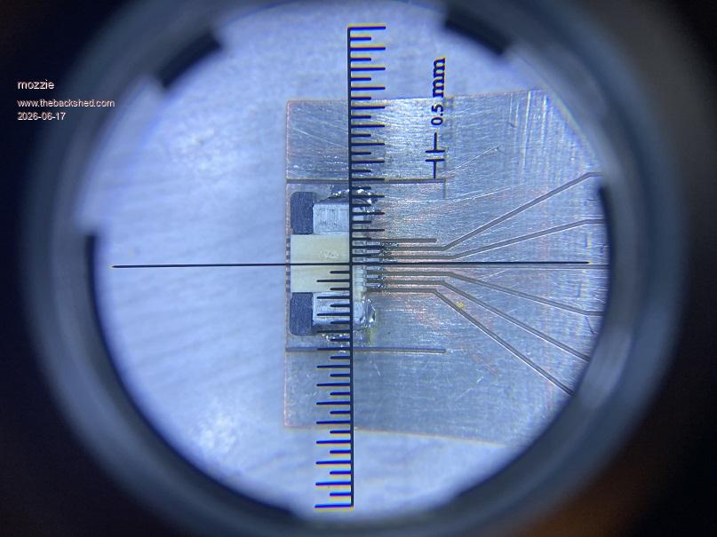

As most of the PCB's used here are more of the "Power" than "Motherboard" variety they have been designed on an ancient CAD package (WIN 98) and cut with a CNC engraving machine, results have been surprisingly good:
This is 0.5mm pitch connector for GT911 touch screen. Considering a PCB can go from idea to finished product in 2-3 hours its hard to beat. just don't look too close at the soldering

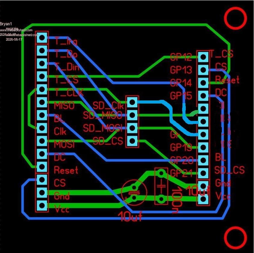

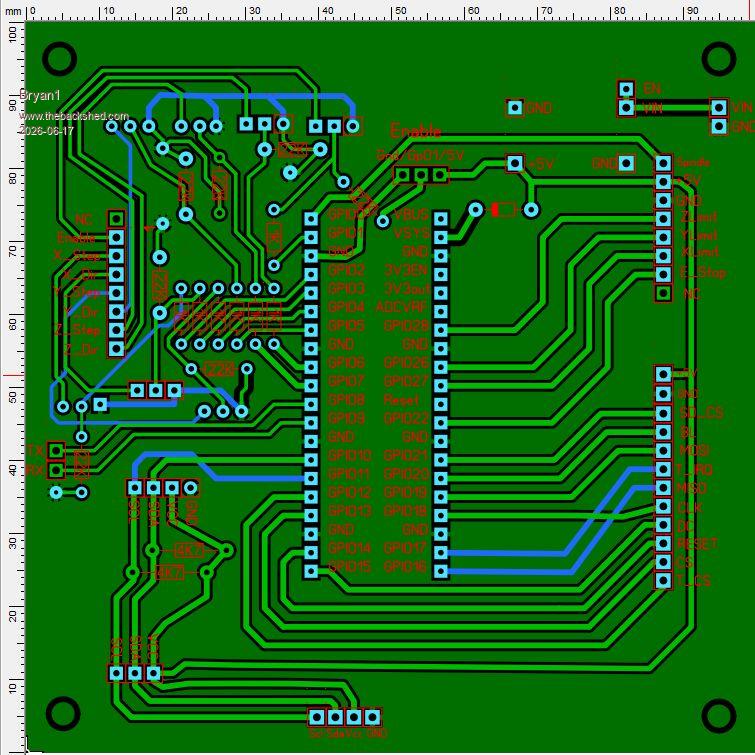

Morning Guy's   Lyle I took on all your suggestions mate and found it was easier to change the stepper board LCD pin assignments to suit the LCD Board. Now above the pico 2 is a 3 pin header so GP01(Enable) can be pulled up to 5V or Gnd and I moved the I2C breakout so it is clear of the RTC, did a DRC and made sure all my changed did confirm and like usual the S1 silkscreen pads seem to cause errors where simply deleting the offending one's with a new componet does fix the problem.
Peter I do get what your saying where when one designs a new project a schematic should be done first so I did have a look at EDA this morning and it went straight over my head as I would need to be ontop of all the new components etc.
Now with this stepper board for example Lyle did give a schematic of the step/direction outputs and yes the Enable(GP01) should of had the pullup/pulldown option put in. Then a LCD output and why I didn't make the LCD outputs the same one can put it down to grey cells
Well for my first attempt one could expect something to go wrong but the board did work nicely and just a few hacks were needed. Like with the LCD board getting the MISO/MOSI pin wrong was an easy fix to get it working.
Now at $3.50 for 5 boards it's not going to break the bank for a V2 revision and now you have done the GUI addition for LCD screens I'm sure this 4" LCD will become obsolete

I guess its up to you mate but I would prefer to keep the I/O in order and change the LCD PCB to suit, could be my OCD kicking in

Lyle the edits I did to the stepper board now confirm with the LCD board and the pin assignments didn't change also now I do have the LCDBoard working with the touch SPI hack I did best not to change it I think.

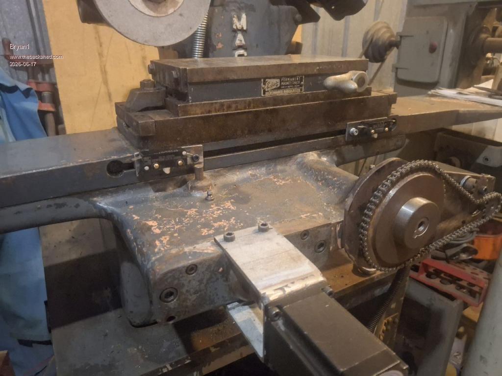

Now I did find some old limit switch's to use for the X Axis   So cut some 3mm plate to 75x25mm and using some 8x7 key steel the 8mm is right for the slot so adjustment can be kept inline.
Found some M3 x 12 socket head cap screws for holding the key steel so dialed in the vice on my bridgeport mill so it's nice and square. Now for securing the limit switch I need some M3 x 20 bolts and the search is still on but lunch is in the way so time for a break.

I was more thinking of trying to keep the I/O in order on both boards to make fault finding easier, GP12-GP21 as on the original Main PCB and change the LCD PCB to suit as its already been modified.
It'll work either way so no real problem
You could also make an adapter board for VGA/DVI output using the same pins, this was the reason for specifying them

Well finally got the limits mounted   also last week gave the surface grinder a bath to clean it up.
So in the morning I will make a strike plate that sits on that centre post so the limits can gently close and they fully adjustable too
I am pretty happy I got this far today and setting them up in the morning will be a fun task.

Anyway as we need 3 pullups for the DM556's added a 3 pin header also put in a 3 pin header for the limit ground connections. Also changed all the pads over to square as I have found they are easier to solder
Anyway it is time to get these boards off to JLCPCB so with the changes it may just actually work

If you haven't already sent off those PCB files, can I ask you to consider changing the main PCB back to the original layout with GP12-GP21 in order and change the LCD PCB to suit, I do similar kinds of things as a "Shortcut" now and then and it comes back to bite me on the ass every time, particularly during fault finding.
Once again, its your project so up to you. Otherwise its looking good
A VGA adaptor board could be made and it'll be a lot easier with those pins in the correct order.
