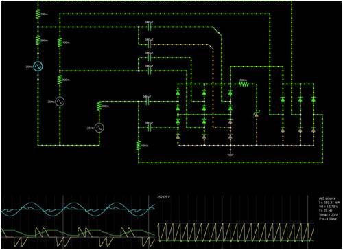

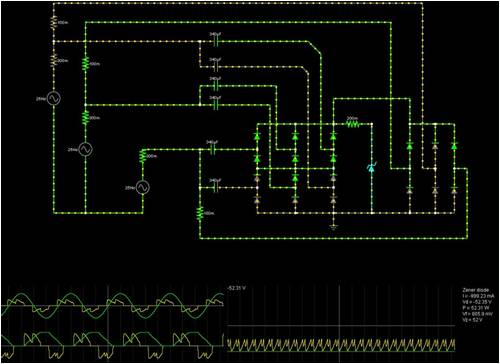

Some good news for readers.
Sparweb has found a neat program simulator that can show us non engineers visually the goings on with the cap voltage multiplier.
Here is a link to the program. link.
Here is the code needed to be imported that shows a typical cap doubler with normal rectifiers.
$ 1 5.0E-6 9.384708165144016 39 15.0 45

This App is an interactive unit, and frequency and voltages and capacitor sizing can be altered, etc.
Multiple components can be graphed to show related interactions.
Well done Stephen, finding this. I think we are free to download and use it.
Here is a pic of typical display. App is good on a large, high res monitor.
I will run some numbers through and see how it compares with my system.
Gordon.
become more energy aware

Hi Karl, this is only a simulator.
All the components are variable! Use the mouse to get the edit menu on a component.
There is no battery simulator. A resistor limits the current, and the zener simulates a constant voltage sink, like a battery.
Am still looking at confirming my measurements.
Gordon.

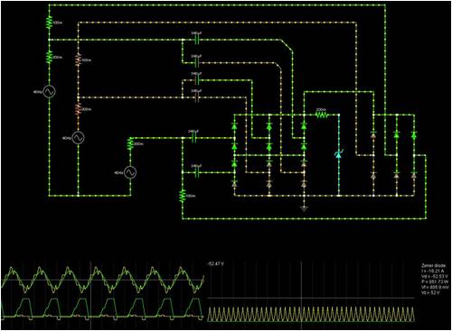

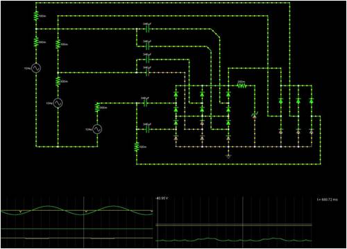

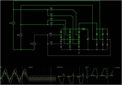

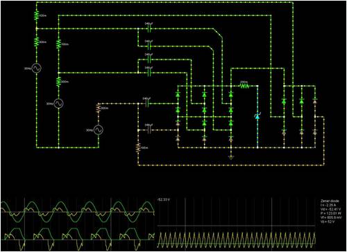

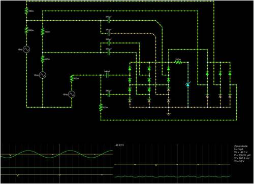

Have run some frequency figs through the simulator, for 340uF caps on my setup with the loading at 52V. I have only done the sim with a doubler and normal rectifiers on my AxFx mill.
There are graphs from 13Hz, 15Hz,20Hz,25Hz,30Hz & 40Hz. This corresponds to 130-400RPM on my mill. The 13Hz, is just below cutin, with no current. The 15Hz is just on cutin, with just the peaks pushing through the rectifiers. At 20Hz[15W], current peaks are showing on the caps[lower RHS graph]. At 25Hz[52W], current starts flowing through the main rectifiers, and this reduces the power through the caps. At 30Hz[123W], current through the caps still reducing, and more power through main rectifiers. At 40Hz[850W], most current is through main rectifiers.
These are the pics of the sim.
13Hz.
15Hz.
20Hz.
25Hz.
30Hz.
40Hz.
The simulator produces results , but not real close to my measurements.
A tool is now available for others to test rough cap sizing for their own windmills.
As long as the reader can work out the AC frequency for a particular rpm, and the output voltage at those rpm, and the system voltage, and the power, a range of caps can be tried to see how they go, without spending any money.
I may get to look at F&P numbers, but someone with a F&P mill would be more suited.

Hi Gordon!
I knew this would catch your eye!
I made my diagrams a bit more compact, so anyone who is having trouble with yours can try this on a 1024 pixel wide screen:
The code to generate this is here:
Link to text file for this circuit.
I've run lots of versions so there are different capacitor values in certain circuits - I keep changing them to see what happens.
I put two switches into the circuit so that I can "shut off" the caps to check the difference. Usually the current through the normal recitifer becomes a few milli- or micro-amps. When on, the current goes up as the capacitor value goes up. With extremely high values for capacitors (1000's of uF) I can get several amps.
As it is, the circuits model a Star-connected generator with 15vac on each phase. Across the line wires you'd measure 25.9 Vac peak. This is just below cut-in for the 26VAC battery, meaning the capacitors are successfully providing a charging current when normally there would be none.

Gordon, why do you think there is no battery?
Left-click, select input/output, and in the list is a "voltage source (2-terminal)" which is the equivalent to a battery.
Naturally, it does not have the subtle characteristics of a flooded lead acid battery. This model will "clamp" the voltage perfectly. Likewise, the AC voltage sources have absolutely no inductive reaction to current.
This is just a computer model, after all - but a dammed fancy one! And that's its real value: illustration of the concept. I'll go back to Spice when I want real figures.

Hi Sparweb,
I get convergence failed errors when switches are closed.
Simulator seems to handle simple stuff OK.
Is there a reason for not having your 3phase all 120 degrees apart? phase B is at 300 degrees, not 120.
My arrangement starts to get problems when I add series caps to the normal rectifiers inputs as well.
may be just better to simulate individually, and add manually. The ccts are in parallel, so this should be OK. just a bit more work.

I faced the problem of not having quite enough caps to complete a doubler for my new windmill, so I went thinking of a solution.
I had thought that considering the number of readers who had viewed these pages that a bright spark may have come up with a this and posted before me, but not to be.
The key should be in the way I drew my original cct. I will leave this open for the moment and see if anyone else may have a similar solution.
I will be confirming my idea in the next few days, with some real world testing.
It is late, so I won't spill the beans until I can draw up some pics as well.
Gordon.

You should be able to cut your bridges back by half as well.
I would think by reducing the number of capacitors by 1/2 per phase you would need to double their value to receive the same result.
Just a wild guess.
Pete.
Sometimes it just works
GWatPE
Joined: 01/09/2006
Posts: 2127
Posted: 11:44pm 03 May 2010
Hi Pete,
The bridge count stays the same, and the AC cap count for a doubler would be halved.
I am in the process of confirming things, now I have logging and the real time and historical power vs rpm available at the click of a button. Just need a bit more wind.
Gordon.
