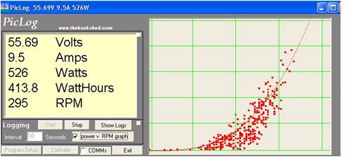

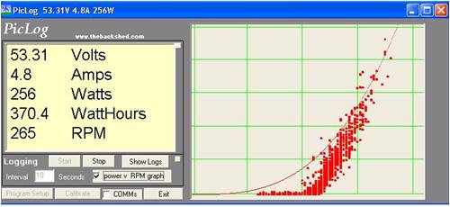

Here are some graphs of with and without the cap doubler today.
firstly without.
and with new simplified cap doubler
You can see a bit larger spread in the data set, but it is clear that the cap doubler has reduced the cutin to approx half the rpm. This is not optimized yet, as I just used 6 caps I had on hand.
There were no mechanical changes to the windmill, and these readings took approx 10 or so minutes to obtain. The windmill does sound a little different at the low windspeeds, with a slightly lower [loaded and producing output current] rpm. The swish/swish noise that occurred with the essentially unloaded mill has gone.
I did not have to use any data manipulation tools, and this was essentially obtained in real time. You will note that the windmill needed to produce approx 44Wh of power to confirm a better output loading curve.

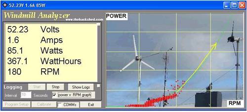

The spread in the data in the graphs above turns out tobe related to the measurement of rotor rpm.
I have some new graphs of without and with caps performance in light wind conditions.
The scatter at the higher recorded power levels are the peaks of the wind gusts recorded at the time. These are low wind speed data. [< 5m/s] The power range on the Y-axis is from 0 to 1000W, and the RPM on the X-axis ranges from 0 to 400RPM This is a 3m rotor windmill, with an Axial Flux alternator.
First is a measurement on the windmill without a cap doubler.
you can note the cut in at just over 200rpm, with some scattered data points above cutin.
The next is a chart with the cap doubler turned on.
The caps clearly allow the windmill to produce more power at the lower rpm, with a cutin at around 100 rpm.
I have added a yellow line where the output power curve of the windmill would be expected to follow, in comparison to a calculated theoretical.
It should be noted that this is not an exact science, but allows an individual windmill to be modified and see how the mods affect its performance. This is not intended to be a scientific windmill performance evaluation tool.
There is a fair bit of area under the green line where the windmill without caps would be producing less power at the lower windspeeds. The caps do not hinder performance at higher power levels.
The main benefit with this arrangement is that a windmill can be wired with less turns of thicker wire and still produce power at low windspeeds. The thicker, shorter wire results in higher winding efficiency at the high power levels.

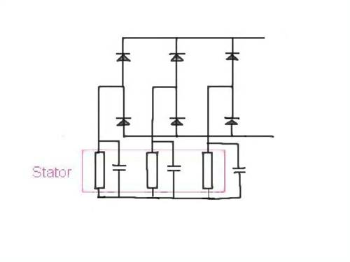

The caps have almost concluded now, with the latest phase of my testing. The last change means, that I should be able to further reduce the cap count by half again. this is due do the now polarised effect of the cct, on the caps that are left. This now means that a 3phase cap doubler should only require 3 caps, and 3 3phase bridge rectifiers. The caps should only need a power rating sufficient for the maximum AC ripple, at approx 1/8 of maximum windmill power, with a voltage rating of approx 2x system voltage.

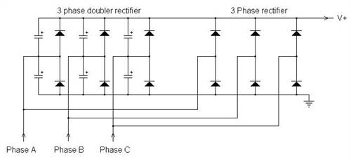

I reckon Gordon's new 3 phase rectifier + 3 phase voltage doubler could look like this:
Only 6 Cap's in total!!
I was trying to remember where i'd seen this kind of circuit before, then i remembered, the input stage on a computer PSU: The 220V - 110V selection switch just connects the AC side of the bridge rectifier to the midpoint of the capacitor string.

Nice guess but i think he is down to only 3 capacitors now, and 3 bridge rectifiers.

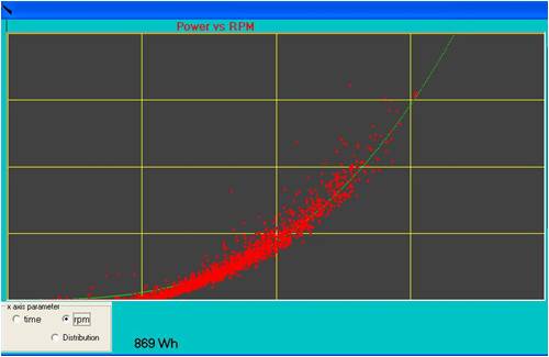

I have just run off a plot of part of a days operation of my windmill with the new cap arrangement. This was just under 0.9kWh produced, and the wind was light to medium, as is seen from the power distribution dots. The power was up to 1000W, on the Y-axis, and the RPM was up to 400 on the X-axis.
This is the power vs windmill rpm. The close relationship between actual power dots and the calculated green line power curve is evident.

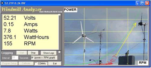

By using my windmill analyzer, that will soon be available as a software component that will only work at the moment with a new logging kit, I was able to visually see how my windmill worked, and I was then able to build a cap cct to suit. Anyone with a windmill and access to a computer would be able to use the analyser to measure actual windmill performance. The shape of the output curve will determine if the windmill is corrrectly loading, and the windmill analyzer can be used to check the loading following corective measures. I should say that the performance of any windmill change, say for an AxFx windmill, be it blades, stator, air gap, capacitor multiplier, etc can be verified. The real time setup of an electronic MPPT is possible as well. Even a commercial windmill can be analyzed, and corrective measures determined.
On this note,
The task of working out what to do has become a lot easier now I have my analyzer.
I would think that there are many readers with a windmill, who could benefit from this type of tool, and who should make a positive effort to pass on their interest, either to Downwind or me. The amount of interest will determine what is offered.

I think this says what you are asking, so no the windmill analyzer part is not free. The kit would contain all the components and cct board, and the programmed picaxe chip. The software works fully with the supplied kit hardware and programmed chip. Those users with a piclog, who may wish to access the windmill analyser aspects would need to have the picaxe reprogrammed. The original piclog code will still function as a logging unit with this program. The software knows what hardware is connected, and configures as a logger only with the piclog firmware, and as a windmill analyzer with the windmill analyzer kit hardware. If the supplied picaxe is reprogrammed then the windmill analyzer function would be lost, and a fee for reprogramming would be charged. Existing piclog chips could be reprogrammed to work as well, for a similar fee. At the moment the picaxe code would not be supplied.
The Comm port detection and Auto selection, and the user selection of system voltage, maximum system amps, maximum windmill power, and the click select file to view and the zoom within zoom of the logged data, and other additions are free. I am still to add some user personalization touches and the auto creation of prog.cfg and settings.cfg files at startup, if they don't exist. This is additional to the auto creation of logs, excel, and html folders that is already implimented. This will make the moving of the program to a different folder on multiple logger systems more manageable. It can be confusing with which window is which without individual program personalization.

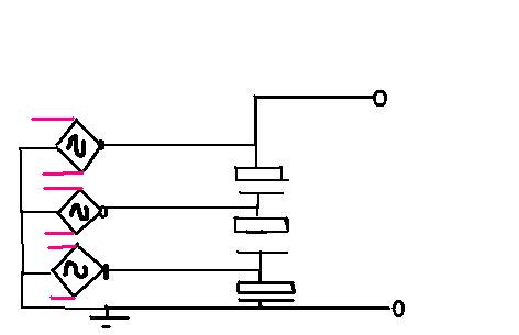

With only 3 caps, there aren't that many combinations possible
I would have a guess at this one
cheers
niall1
Joined: 20/11/2008
Location: Ireland
Posts: 331
Posted: 02:08pm 14 May 2010
ermmm....with 3 caps and 3 seperate rectifiers this would be kind off like rectifing
each phase...then using the caps to series up the dc outputs and bump up the voltage ?
