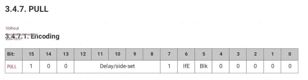

Hi Peter,
I did not want to pollute the release thread, that is why I post here.
I have questions about the PIO assembler.
1/ There is 1 PIO program memory per 4 state machines. In the PIO assembler you can use the directives .WRAP and .WRAP TARGET that can be used as addresses in the PIO(EXECCTRL)
But for 4 state machines, I would need .WRAP0, .WRAP1, .WRAP2, .WRAP3 and associated targets because each state machine has it's own wrap_target and wrap addresses.
Is that implemented, and if yes, then how can I use it ?
2/ In the PIO instructions there is a possibility to use side_set. The side set bits and the delay bits share 5 bits in each instruction (bits 12,11,10,9 and 8.)
When using 1 side set bit (by using PIO ASSEMBLE n,".side_set 1") bit 12 is the side set bit, and bits 11,10,9,8 can be used for delay. The assembler correctly processes this. When  using side set it is brute force (each instruction uses it).
While implementing a PIO UART, I need to use the SIDES_SET_ENABLE bit (only execute side set when explicitly stated in the mnemonics). This is enabled by setting the bit in the execute control register (correctly implemented in 6.00.01). But the assembler also needs to know, because the 5 bits in the side_set/delay field get another destination: bit 12=side set enable, bit 11 is the side set bit, bits 10,9,8 are delay.
What is the assembler switch that enforces this change ? I tried ".side_set_en", ".side_set_enable", ".side_en", ".side_enable", but all give errors.
I currently use a work around by "simulating" the side_set_enable as a second side_set bit. This is to enforce the assembler to generate the correct codes.
example code:
 ' note: side enable is implemented as the msb side_set bit since assembler
 ' does not support .side_enable directitive AFAIK.
 ' instruction bits   12        11       10 9  8
 ' official         side_en   side_set     delay
 ' here             sideset_m sideset_l    delay
 ' this works because when side set not in menmonic, 0b00 is used, and enable is off
PIO ASSEMBLE 1,".program uart_tx"
PIO ASSEMBLE 1,".side_set 2"            'PIO ASSEMBLE 1,".side_set 1"
                                        'PIO ASSEMBLE 1,".side_enable" ??
pio assemble 1,".line 0"
PIO ASSEMBLE 1,"set pindirs, 1"
PIO ASSEMBLE 1,".wrap target"
PIO ASSEMBLE 1,"pull block side 3 [7]"  'PIO ASSEMBLE 1,"pull      side 1 [7]"
PIO ASSEMBLE 1,"set x, 7   side 2 [7]"  'PIO ASSEMBLE 1,"set x, 7  side 0 [7]"
PIO ASSEMBLE 1,"bitloop:"
PIO ASSEMBLE 1,"out pins, 1          "
PIO ASSEMBLE 1,"jmp x-- bitloop   [6]"
PIO ASSEMBLE 1,".wrap"
PIO ASSEMBLE 1,".end program list"
Please advise,

Posts: 11828
Posted: 08:37am 31 Dec 2024
  Quote  What is the assembler switch that enforces this change ? I tried ".side_set_en", ".side_set_enable", ".side_en", ".side_enable", but all give errors.
.side_set n opt
As per the sdk
Directive must appear before instructions
NB: the MMBasic assembler only allows a single program to be specified this is a limitation of the implementation. The full specifications says
  Quote  .program <name>
Start a new program with the name <name>. Note that that name is used in
code so should be alphanumeric/underscore not starting with a digit. The
program lasts until another .program directive or the end of the source file. PIO
instructions are only allowed within a program
Edited 2024-12-31 18:44 by matherp

Posts: 11828
Posted: 08:51am 31 Dec 2024
Its in the sdk manual
.side_set <count> (opt) (pindirs)
If this directive is present, <count> indicates the number of side-set bits to be
used. Additionally opt may be specified to indicate that a side <value> is
optional for instructions (note this requires stealing an extra bit — in addition
to the <count> bits — from those available for the instruction delay). Finally,
pindirs may be specified to indicate that the side set values should be applied
to the PINDIRs and not the PINs. This directive is only valid within a program
before the first instruction
Posts: 6100
Posted: 10:16am 31 Dec 2024
Hi Peter,
The ".side_set 1 opt" worked. Thanks.
But I am still trying to find out how one state machine can use side set pins, and the other state machine not, or different.
Also the text you listed from the SDK says a program is  valid until a new ".program xxx" or an ".end program"
Well, a new program ".program xx" can not be assigned. Therefore it seems all defines (as ".side_set x" and ".line x") are global defines, for all state machines. That feels wrong.
Posts: 11828
Posted: 10:21am 31 Dec 2024
  Quote  B: the MMBasic assembler only allows a single program to be specified this is a limitation of the implementation.
You will have to assemble as two programs and then concatenate the hex
Edited 2024-12-31 20:22 by matherp

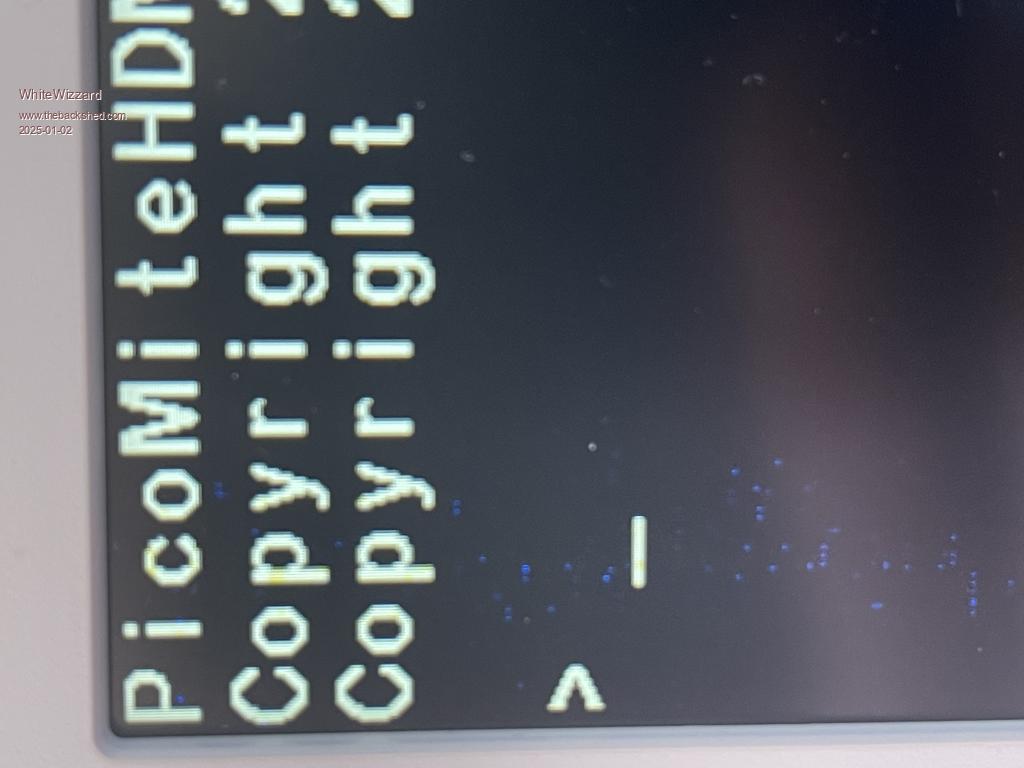

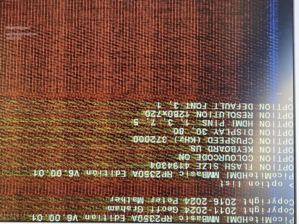

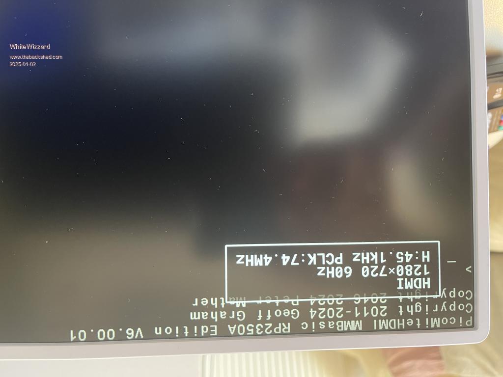

Posts: 2991
Posted: 11:16am 02 Jan 2025
Hi Peter,
Using a genuine RPi Pico 2 on an Olimex carrier (for HDMI output - and for SD card when ready to configure).
I am seeing ‘noise’ on the screen and am wondering if it has anything to do with potential track length differences for the video signal-lines - your thoughts suggestions welcome…..
Screenshot shows version number and OPTION settings (not sure why it is upside down!)
Note that placing my finger near/on the pins will affect the amount of noise displayed - this is the extreme shown immediately below.
Here is the best I can get (but still shows a column of noise).
Tried various leads, good power sources for monitor and laptop - Pico/Olimes powered via USB from laptop for monitoring via TeraTerm.
Edited 2025-01-03 06:56 by WhiteWizzard
Posts: 9115
Posted: 11:32am 02 Jan 2025
Have you tried a different monitor? I have a AOC which, although HDMI and will work with everything else I've tried will not work properly using the DVI signal (which is what it is) from a Pico. A different monitor, older and with a poorer spec, works perfectly at all resolutions.
From my own experimentation I don't think the track lengths are making as much differences as we first expected, at least not at 640x480. Even my Alpha board would run that resolution once I'd found the monitor issue and I'd paid no particular care to equalize trace lengths. My own suspicion is that having to include over 200R on each leg of each loop completely ruins everything to do with signal termination. It's absorbing all the junk on the loops. We have to have it because the Pico's outputs can't safely produce enough drive current for the cable and monitor.
Posts: 11828
Posted: 11:34am 02 Jan 2025
No idea - works fine for me
"OPTION RESET OLIMEX" will configure the board correctly
Make sure the HDMI 5V out link on the bottom is connected
