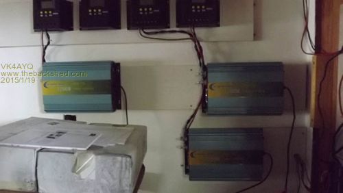

Swapping bits of electrolyte from one cell to another will not solve the problem as you would need to drain around 25 % of the electrolyte to achieve and it is hard to monitor results a bit of concentrated acid is much easier as it only takes a few days to get the effect.
I only found out your batteries where Fork Lift batteries from reading your other forum entries and I agree that the fork lift batteries do take more punishment than normal deep cycle batteries but it does shorten there life cycle my battery man in Brisbane told me that the life of fork batteries is about 5 years where as the same batteries in a solar use are good for 15 years These are good batteries but suffer the same limitations as any lead acid battery.
The heating of the battery does help remove sulphate from the plates but does it in the mechanical sense not the re conversion to acid as it should be, this results in the grunge that builds up in the bottom of the battery and can eventually kill the cell. The sulphate is boiled of the plate rather than recombining with the electrolyte.
You have boiled the battery enough to get rid of the sulphate and still the same SG so it is most probably low acid.
The old 2 volt cells on the 32 volt systems where about 30 inches high with around 4 inches of space above the top of the plates so a similar situation to yours but as they where glass containers you could see what was happening in the cell and the bubbling went from bottom to the top while charging and to a lessor degree when discharging this natural convection prevented stratification unless the temperature was very cold or they where left sitting without use for a long period.
I have used desulphators for the last 40 years in various forms and found them very effective reviving many batteries and saving some real basket case ones providing the cells are intact.
If it was not for the desulphators my battery banks I have been salvaging would be in the scrap yard so that is proof enough for me, I use infinity desulphators as i found them to be gentle but effective and can be left on the batteries all the time without any problems, some of the monster desulphators I have seen on the forums are good for a desulphation in quick time but they can't be left in the system.
If you have sensitive electronic devices near the batteries you can put some ferrite beads in the battery leads to reduce any pulse energy going down stream, I have never had a problem with any of my stuff but the pulses can be seen on a cro so they are there.
It is true that gell cell batteries are more fragile than lead acid but I have found that using the desulphators on a number of them that they do respond, for example my UPS from the office sat in the shed for ten years after closing the office and was at 0 volts a week on the desulphator had it working again and a month later it was to nearly full capacity as it would run the computer for 30 minutes.
So I believe the secret with Gell cells is to use the lowest recommended float voltage and leave the desulphators on to take care of equalization, while I have done this with old batteries that where US before I got them I haven't tried it on a new battery, but do believe the result would be the same.
They do suffer badly from dehydration as do all types of lead acid batteries so equalizing charges is going to shorten their life span, while they can be rehydrated it is a slow process as once the gell dries out it is very hard to get the moisture back into it.
The Infinity desulphators are about $50 on fleabay so 4 of them is not a big investment compared to the cost of your battery. Your battery should last 15 or more years if you stop worrying about it and boiling the guts out of it.

I have the same trouble with the TV wife puts it on and then not watch it so it is going in the background most time. It will have a failure one day when she isn't home and will be replaces with a more economical one.
On your loading problem you could put a water radiator on the HWS and a small circulation pump, in winter it would help the heating bill.
A couple of the plug and play GFI units could return excess power from the panels to the grid and run your meter back a bit, when connected across the panels the GFI draws only a few milliamps until the regulator shuts power to the batteries then the panels increase in voltage because of no load and it fires up the GFI 55 Volt ones in your case, I use 28 volt ones on my system.
You could do the same with your turbines feed them through a solar regulator for the same effect. Better than wasting all that excess power and gives you a bit up your sleeve from the grid when needed.
