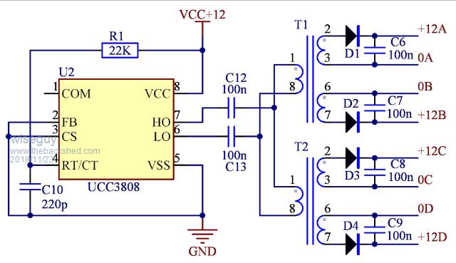

  Tinker said
Why the 4R7 series resistors in the 12V supply for the opto & gate driver chip?
I like having some impedance between high current noisy parts of the circuit and the control board environment. The resistors can be replaced with axial inductors if noise is an issue. Also for the Lower FETs of the two half bridge PCBs any imbalance of currents will not force high currents through the low energy connector and wiring.
In theory, a difference of 0.1V and 1 milliohm of resistance can cause 100A to try to flow. Now repeat with 4.7 ohms and it becomes 0.1/4.7001 or 21 milliamps. The resistors have essentially no effect to the current levels required by the drive circuits powered from the isolated 12V supplies.

  Tinker said
I'm also curious which isolated 12V supplies you chose. Warpspeed suggested to use AC to DC supplies and I bought some. Much to my surprise I could get the full rated 2Amps @12V when powering them from 50V DC.
I rolled my own it is an RM6 core using a power bobbin (8 pins).
Primary 18T of 0.2mm 3 x secondaries each 20T of 0.2mm done !
Add5 parts for a couple of dollars finished !
Its 2.00am Im too tired to redraw this properly - only T1 is used and pins 4 & 5 will have the third winding, it is a fairly simple & efficient circuit.

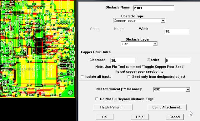

Tiny, may I suggest something about board routing. When drawing a PCB (or autorouting) to avoid entering most of RF disturbances trough the air from outside world in to circuit itself, and also transmitting out any internal RF noise, it is important to have a wide Faraday cage (connected to GND or "-" level) all around PCB on each layer, if there is multilayer PCB to be designed.
Something like here on my boards: sample 1 , sample 2 , sample 3
... English is my second language Edited by brac321 2018-11-24

  brac321 said   Tiny, may I suggest something about board routing. When drawing a PCB (or autorouting) to avoid entering most of RF disturbances trough the air from outside world in to circuit itself, and also transmitting out any internal RF noise, it is important to have a wide Faraday cage (connected to GND or "-" level) all around PCB on each layer, if there is multilayer PCB to be designed.
Yes, that is what I will do. In orcad layout, they call it copper pour, like this:
To keep the cost down, the board will have only two layers.
This is good, people from other countries are contributing.
I am not an expert in pcb designing, so I will need all the help to make this successful.

My boards are all manually routed, I do not trust autoruters. Sometimes is the length of tracks and their capacity important, sometimes their position and layout. Autorouters don't do that properly at all.
Tracks need to be wide enough for expected currents, vias too. And in case of Nanoverter there won't be any special designing rules required like for PCB's that operate on a RF (high frequencies). If I guess, you are already familiar with all those basics needed to design Nanoverter PCB's.
