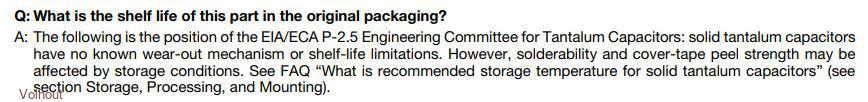

I'd be tempted to rig up a simple oscillator (an inverter gate, feedback resistor and a capacitor driving another inverter which drives an LED) (or use a 555 if you have one around). Then leave one flashing for several hours.
You know they are bad if they won't work in an oscillator.
Posts: 6104
Posted: 01:26pm 22 Jun 2022
Vishay comment on shelf life of tantalum capacitors:
You may check them on leakage, but good chance they are still good after 40 years.
Posts: 4398
Posted: 01:27pm 22 Jun 2022
  Mixtel90 said  I'd be tempted to rig up a simple oscillator (an inverter gate, feedback resistor and a capacitor driving another inverter which drives an LED) (or use a 555 if you have one around). Then leave one flashing for several hours.
If you will draw me a schematic (either one, the other or both of what you suggest) then I'm happy to go and have a play, pretty sure I bought some 555s during my component accumulation phase ... probably shonky Chinese ICs .
Posts: 4398
Posted: 01:29pm 22 Jun 2022
  Volhout said  Vishay comment on shelf life of tantalum capacitors: ...
Well they look shonky to me, my component tester won't read them consistently (22uF is out of range for my multimeter) and one of them is 1/3 blackened .

Try here.
R1=1k
R2=10k
C=22uF
3Hz 1:1 mark-space. Play with R2 to change the frequency. :)
