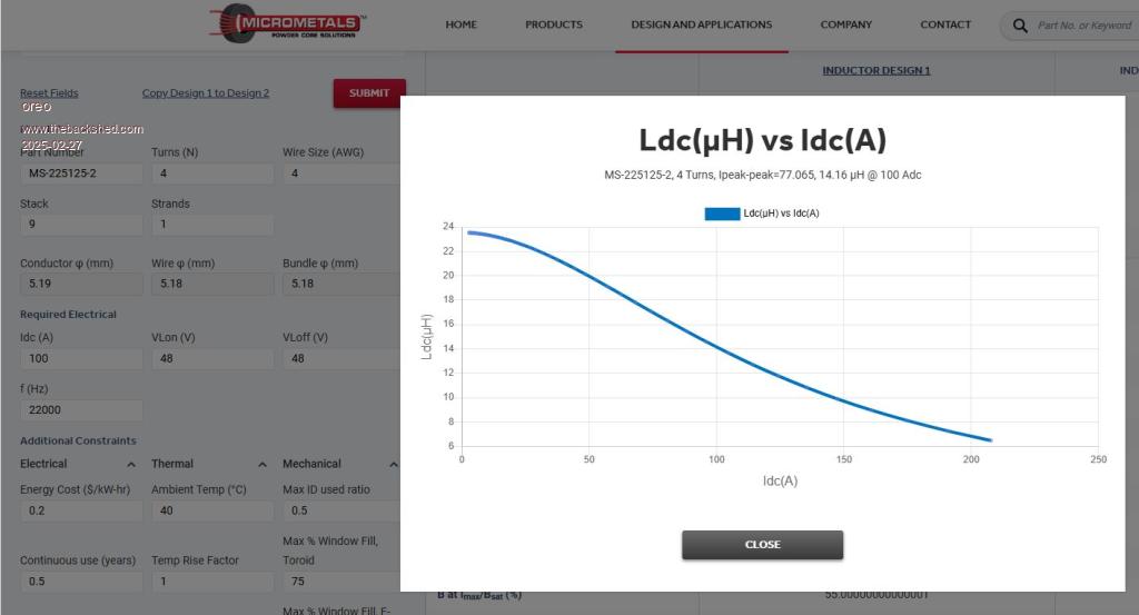

oreo
Joined: 11/12/2020
Posts: 138
Posted: 01:59am 27 Feb 2025
Thanks for the link for the Sendust cores.  In Canada, the price comes up as $6.60 plus $9.45 shipping (CAD), but as you add more cores, the shipping just goes up by $1 each.
(until you hit 12 cores when the shipping goes up by an additional $60)
So to order 11pcs it works out to $8CAD or $8.84 AUD each which is the best price I have found around!
I tried ordering this size core earlier off an EBAY vendor, but they ended up not actually having the advertised cores and sent me MS184040-2 cores instead.
They refunded me, and I may use the cores for something, but obviously not ideal.
On another note, when I enter a stack of 9 pcs of this core (MS225125-2) with 4 turns in the Micrometals inductor Analyzer,
I am not seeing the inductance at the higher currents you are mentioning.
On my previous builds using 3xMS157060-2(Sendust) and 4xT250-40(Iron Powder) the inductor Analyzer numbers were surprisingly close to the numbers
I measured using a storage scope and high current source.  Obviously what you have is working well, so just wanted to confirm that you are using
these cores with just 4 turns.
Here is the current vs inductance curve generated for a stack of 9 MS225125-2 cores with 4 turns.
I have double checked the core weights and sizes between the Micrometals core and the Aliexpress core and they match.  So I am a little stumped with why the difference.

KeepIS
Joined: 13/10/2014
Posts: 2294
Posted: 02:23am 27 Feb 2025
That's interesting, I'm measuring them with a current source of up to 700A and a DSO, while they are not "quite" as good as the meatier 6 core stack (not available) they are close.
These are measured with a high current hall effect sensor and confirmed against a resistive shut for Hall Sensor transient response and indicated current.
Two chokes have been repeatably subjected to almost 600A daily for over a year, and as you say, they are working well, in this dual inverter they now see 600A peaks across 4 chokes.
It's a shame that we can't get the original cores, and cores in general at a decent price.
Edit: From memory I calculated around 9uH at full current for a single 9 core choke with original thicker cores, if the Sim is correct then I was close, 7uH @ 200A single choke, two chokes would be round 14uH at 400A, over 20kW input surge.
Edited 2025-02-27 13:36 by KeepIS
oreo
Joined: 11/12/2020
Posts: 138
Posted: 04:02am 27 Feb 2025
Are you seeing inductance go down when the DC current goes up?  If not, then these must not be Sendust cores.
Greg
KeepIS
Joined: 13/10/2014
Posts: 2294
Posted: 04:52am 27 Feb 2025
Of course, why would they be 23uH at zero current and 9uH close to saturation.
They are Sendust, the correct mix is stated.
