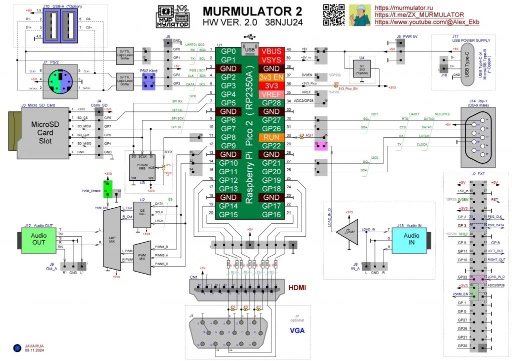

Posted: 10:12am 24 Nov 2024
  matherp said  here are updated versions of RC17 for all variants
OK! With this latest update using the OPTIONS settings I was able to fully configure PicoMiteHDMI for my new MURMULATOR2 HW ver.2.0 board
Thank you very much for your work and attention!
PicoMiteHDMI MMBasic RP2350A Edition V6.00.00RC17
Copyright 2011-2024 Geoff Graham
Copyright 2016-2024 Peter Mather
> option list
OPTION FLASH SIZE 4194304
OPTION KEYBOARD US
OPTION PS2 PINS GP2,GP3
OPTION CPUSPEED (KHz) 315000
OPTION HDMI PINS  1, 3, 5, 7
OPTION SDCARD GP5, GP6, GP7, GP4
OPTION AUDIO GP10,GP11', ON PWM CHANNEL 5
Edited 2024-11-24 20:14 by javavi
