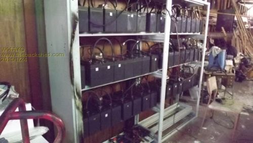

Posted: 01:05am 24 Jan 2015
Progress Report
Hi All
Battery pack 1 now assembled and fited with desulphators and balance straps at 12 volts now hooked to the 2 float panels and floating at 27.5 volts 5 amps as the panels are floating the three banks the input current to each bank is around 1.75 amps, enough to float but not to cause excess gasing.
Several of the other suspect batteries have collapsed due to leakage between cells it seems that the sulphating had ruptured the cell dividers and there is a slighr leak between the cell electrolyte one to the other, while the cells are reasonably OK the heating caused by the charging is noticeable and now they are acting like a 2 cell battery showing 4.8 volts on resting,I may cut the side out of them and try a reseal as they are mechanically OK.
Next Monday holiday I hope to finish the new cables isolation switches to the new inverter and start load testing Bank 1 and 2 bank 3 is on a charge wire only at the moment so will need a shift and new cabling for a proper test, the charge wire is good for 80 amps only but that will work for initial low draw testing.
The desulphators are working across each 24 volt shelf, the leads are a bit long but they are working. I plan to put a desulphator across each 12 volt section when I get the rest of the parts to make them.
Bank 3 will be transferred to the lower shelf s of bank 1 and 2 now there is some room but cabled as a separate bank.
All the best
Bob

VK4AYQ
Joined: 02/12/2009
Posts: 2539
Posted: 11:18am 24 Jan 2015
Hi Gww1
It sure is there was originally 64 batteries but when I first got them some where US and now with this last event I have lost 8 more so that's why the two vacant shelves.
You can see why it has taken me a while to treat them all, I hope now that they are re hydrated I will get a couple of years out of them to allow me to save for a NIFE cell set.
Just doing the cabling on this lot is a major contract.
All the best
Bob

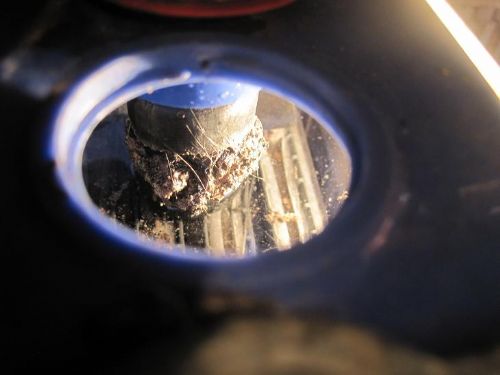

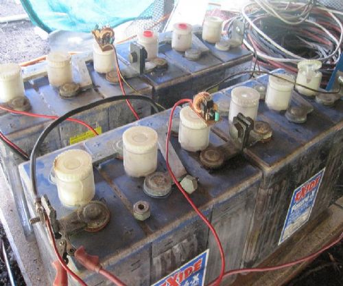

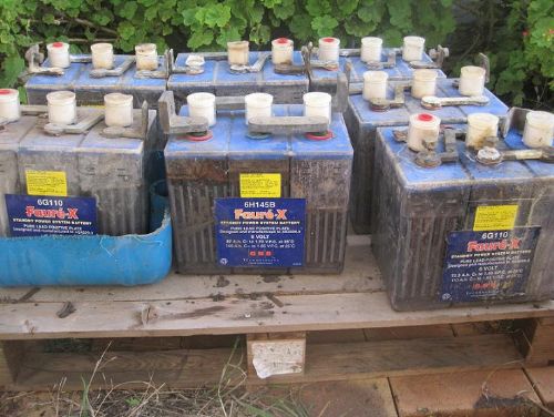

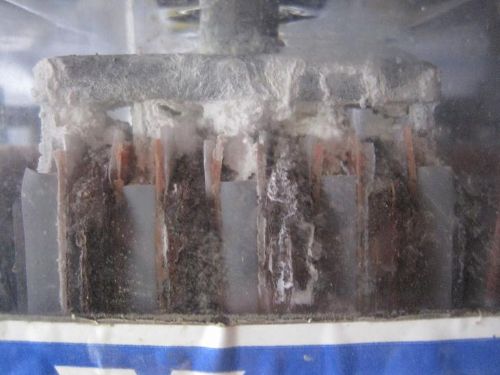

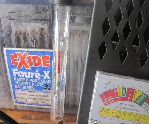

Posted: 01:24am 01 Feb 2015

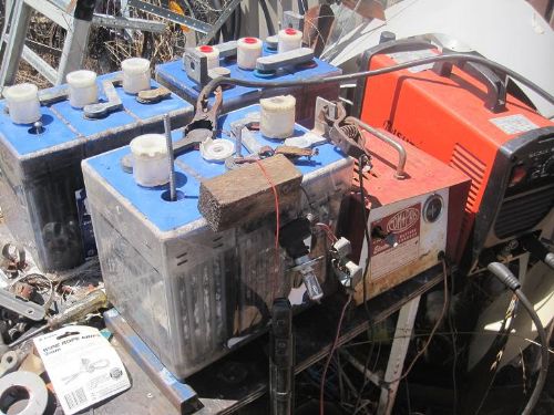

The 6 volt desulfator is still singing/working on another battery.
I ran it for 2 weeks on the big 6 volt truck battery which has been standing now for 2 weeks and is holding its voltage and amps
Runs the vibrator radio
I do not believe it is completely sulfate free
I will attend to it more in the future

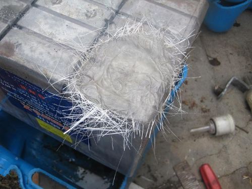

Meanwhile back to the old 32 volt bank of batteries. (see earlier post page 33)
photo 1
photo 2
4 of the batteries, coupled as 12 volt and in parallel. The volt meter shows 1 volt (no load) and the liquid level in the hygrometer is 20mm above the red, all cells the same. Note sulfation in cells
photo 3 Close up of sulfation
photo 4
I have made 2 more desulfators as per the parts I selected from Jaycar (shopping list page 34)
I can actually hear them oscillating and vibrating when I put them on the vent caps
Site of the sulfator article;- http://www.thebackshed.com/forum/uploads/VK4AYQ/2014-12-13_2 24229_desulfator.pdf - to save you going looking for it
I have no working oscilloscope only an audio tracer to hear the oscillations, so I do not know what output they have or what actual frequency they operate at.
These have been on charge for 2 weeks. AND NOTHING almost
The battery voltage is now 6 volts, The hygrometer = no change, No Gassing
The only amps drawn from the charger is what the desulfators use, About ½ amp each

The newer two of these 6 volt batteries have charged up and are holding
I charged them at 2.5 amps for 2 weeks and they have been left 2 weeks
I used a commercial desulfator
Did the desulfator help or the old magic stuff help? Or were they not so bad. As I said I got them at a different time to the others
I can see there is a lot of sulfation on the plates
No discharge/recharge cycle tried yet
I will attend to them more in the future

This the 7th battery, the one in the tray
I fibreglassed the split in the bottom and put the old acid back

(The batteries at the back are the goodies and one has negative terminal gone also a positive lug off)
photo 6
The negative terminal has fallen off; I tapped a ¼ rod into it for a test.
This nearest cell has charged and is holding.
The center cell had high resistance so I turned the welder right down and connected it through a thin wire (red) for a fuse.
A lot of rotten egg gas/smoke came out. I switched it of and ran away until the smoke cleared
(Believe me I had a brand new battery blow up in my face as I was leaning over it once (long story)
First time I was ever glad that I wear glasses)
The last cell in this battery, I connected a 12 volt charger through a 12 volt 60 watt headlight bulb which will limit the charge to 5 amps.
The light was quite bright for a few minutes then it had gone out
It never gassed
Observation
I think there was a charge going into the cell. E.g. the bright light
I think the bridge post to cell tie bar joint has burned through in the corrosion and is now open circuit. E.g. NO light
As the terminals are falling off, so, I suspect the way the manufacturers attached the plates tie bar to the bridge posts has broken down and corroded away
This failure is only on the negative joints, all positive joints are clean and sound
I think the cells are OK only there is no negative connection to the outside bridges/terminals
photo 7, Inside the cell, corrosion between negative plates tie bar and bridge post
The plate assembly tie bar is visible in the background and is quite clean and solid
(See photo 3 where the 5 plates are joined solidly and the bridge post in background)

I believe I have good cells. The failure is on the negative joint between the plate assemblies and the bridge posts
If I was desperate and out on Mars or The Strzelecki Track I would drill a hole in the case directly above the plate assembly tie bar, screw in a new lead bolt? and bypass the other manufacturers joint.
So this battery is a 2 volt with a missing negative terminal ---- Useless.

You have been a busy beaver and it sounds like your desulphators are working, with that amount of sulphation it will take a long while to get results though, mine have been worked on for three months and still going, these desulphators are a slow and steady low power device designed to be left on rather than a King Hit one that puts a lot of energy in a short time.
I use my welder to get a non conducting battery moving, it is a Inverter type and I set it at 10 amps and it goes up to 50 / 60 volts and then when the battery starts accepting charge the volts drops back, just do it outside and switch on from a distance it saves running as I am not good at that anymore. An old bag over the battery helps to contain any fallout.
By the look of the construction of these batteries you could cut the top of each cell and lift out the plate pack to work on but I think you would need to fit bolt as you describe to see if they can be got moving first, before going to all that effort. If the plates can be salvaged you can make a new top from some acrylic sheet and reseal as the cases look to be reasonably sound, I suppose it depends on what you have in mind for the pack if it is revived, is it going to be put to use or just an exercise.
All the best
Bob
