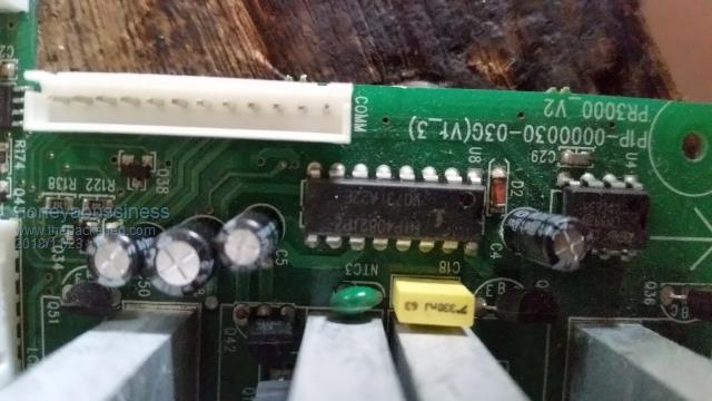

noneyabussiness
Joined: 31/07/2017
Posts: 527
Posted: 07:47am 23 Nov 2018
  poida said   noneyabussiness: Hip4082?
I am not so sure. If I read the datasheet correctly, you will need a NOT gate as well as a HIP4082. Two ICs anyway.
The IR21844 can drive 4 or 5 MOSFETs directly.
I intend to drive my home inverter board directly using this design.
Cost savings are small compared to the cost of everything else in my view.
Mouser shows $5 each. so you save maybe $7.
The outlay is almost 2 ir21844's together.. the inputs are all separate( "not gate" not needed but shown in datasheet), single resistor to set global dead time, and a short circuit current of 2.5 amp ish.(solar mike i don't understand the " no parallel issue you stated).. ive seen them happly driving 5+ mosfets ( similar to ir4110s etc.) In ups's that i dismantle quite regularly. .. it was purely a suggestion to simplify things..
I think it works !!

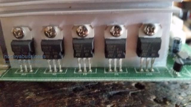

noneyabussiness
Joined: 31/07/2017
Posts: 527
Posted: 07:55am 23 Nov 2018
Just to confirm what i said, in a cyber power 3kw UPS i pulled apart today...
I think it works !!
noneyabussiness
Joined: 31/07/2017
Posts: 527
Posted: 07:56am 23 Nov 2018
The 5 per bank ( 4 of obviously ) mosfets it driving... sorry for blurring, stupid phone camera quits sometimes . Markings are p80nf10...Edited by noneyabussiness 2018-11-24
I think it works !!

  noneyabussiness said  (solar mike i don't understand the " no parallel issue you stated).. ive seen them happly driving 5+ mosfets ( similar to ir4110s etc.) In ups's that i dismantle quite regularly. .. it was purely a suggestion to simplify things..
Hi noneyabussiness, that chip has pullup\down current of approx 1.4 amps according to its spec sheet. Yes this will drive some multiple low gate charge mosfets in parallel but not very well, the limited amperage capability means the switching time will be unduly long resulting in high power dissipation in the parallel devices.
Many here are using the HY4008 mosfets, these each have approx 60 more nCoulomb's gate charge than the mosfets in your photo, this will make the situation much worse and switching times will be excessively slow.
That manufacture is pushing the performance envelope using the chip as shown, unless there are some other hidden gate driver chips or totem pole driver transistors we cannot see.

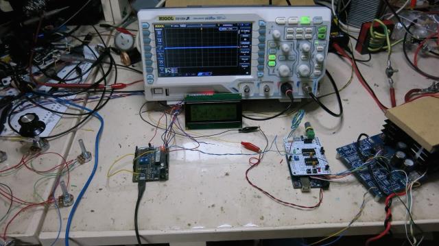

First, some answers:
I asked Tinyt to accommodate 2 x IR21844 and one HIP4082 in the circuit and PCB.
That way, either can be used on the same board.
I have had some progress with nano2 code. So much so that I have a running prototype.
It has fake AC volts, DC V, DC I and heatsink temp inputs which are driven by potentiometers.
During testing I found a wrinkle. nano2 when booting pulls D7 down, low impedence.
This is connected to nano1, D8 which is the on/off input.
This means, during booting, nano2 will start the inverter, and nano2 code will think the inverter is OFF.
What an awesome start to proceedings.
So a change has been made, nano1 D8 pin will be:
HOLD LOW = stop
HOLD HIGH = run (the inverter)
This now lets nano2 boot up without kicking the inverter into life unknowingly.
I added a simple message displayed on the LCD on boot, for 2 seconds, to show
it is booting and give me a cue to look for issues.
I need to code some timeouts for the AC low level. Maybe later on tonight.
No point in having AC output low level cut off active as soon as you start the inverter since the soft start will always trigger. And we won't get anywhere.
I think a timeout of about 10 seconds after start will be suitable.
I plan to permit either the old momentary push button or the current hold on/off
to be used, switchable via #defines
yet more video, do you find these worthwhile? I know I like to show
the behavior of the code, to drive discussion of function and features.
I have added support for toroid temperature, but since I have only Uno boards, I do not have access to ADC channel 7, where that temp sensor will be connected.
It shows rubbish data now.
Events in the video:
start, DC V cut off, restart, heat sink temp increase, fan on (shown by star appearing), fan off (star disappears), increases to force cut off,
restart and current increase to cut off.
Values chosen are arbitrary. I do not care if they are wrong or poorly chosen.
They are test values. Anybody can chose their own, and choose if any cut offs are active or not.
mains sync was not active in this test.
video
code versions used:
2018-11-24_165611_nano2_1.ino.zip
2018-11-24_165638_nano_1_v3_sync_pid.ino.zip
