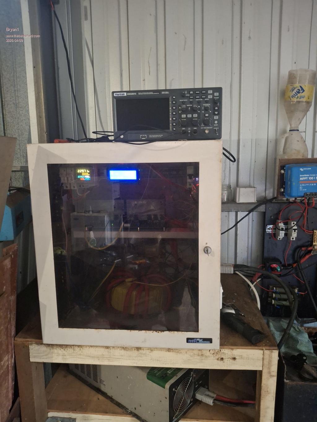

Well Guy's it's pouring down with rain here so what better time to change over the inverters
So I am one Happy Camper this project is finished
Regards Bryan
Bryan1
Joined: 22/02/2006
Posts: 2297
Posted: 12:22am 09 Apr 2026
Just went for a look and L02 is where the HS sensor is placed and it's sitting on 40C where the L01 heatsink and the rear ones are cool as so not out of the woods just yet me thinks.
It just hit 45C and the fan came on so I will keep an eye out.
Just put infra red temp change on the L02 mosfets and the second from the end is the problem.
So looks like I'm starting my genset just to power a soldering iron to see if that fix's it.
Edited 2026-04-09 10:31 by Bryan1
Bryan1
Joined: 22/02/2006
Posts: 2297
Posted: 02:24am 09 Apr 2026
Ok resoldered the offending mosfet and the heatsink is still heating up on L02, I set the starting temp to turn the fan on at 35C and found I did have the fan backwards.
So rather than keep using the genset hooked back up the Kipoint and found as I shared the AC output even with the Anderson connector off line the energy meter is on and the inverter is in the off postion.
So still got to sort out why L02 is heating up, now I have put isolation pads behind both L0 sides so I am wondering if they even need to be isolated.
