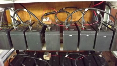

I am still waiting for some bits to finish the desulphator mentioned earlier, but from what I understand of the design it is a low to medium impulse suitable for leaving on the battery all the time, the guy that designed / adapted the circuit had that in mind when he built it.
Looking at the design of the unit the intensity of the output is governed mainly by the charge capacitor and inductor combination in the output stage and the rating of the fast recovery diode, most designs use the 555 as a driver, some with an extra driver stage before the Power FET I believe this would give a higher output and be more suitable for desulphation on a one of basis rather than being left on all the time.
I personally would use one per battery to minimize losses in the bank and be sure that each battery gets a good signal, that is why I am going to make a number of these units to go across each 12 volt pair of batteries, at the moment I am using one across each 24 volt shelf in the pack, it is OK but I think it could be improved on with more units. To do what I want would mean buying 24 units @ 12 volt and at over $60 each now our dollar has done a nose dive I decided to have a go at making some. Suffering from AIDS ( Acute Income Deficiency Syndrome) also known as Pension.
Note the desulphator across the 24 volts at the moment these are commercial units Infinity brand that have worked well for me and are rated for 1000 AH.

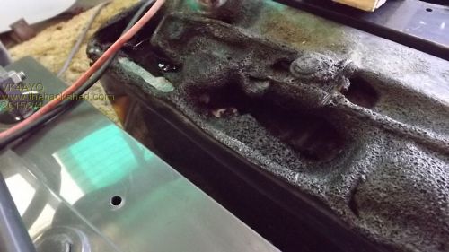

I have a battery that the top burnt out of in a fire in my shed several years ago and it sat under the bench flat for two years, after I cleaned all the ash and melted plastic off the top of it, I decided to have a go at reviving it.
The lead connectors in it where covered in white sulphate once I cleaned the burnt an melted plastic off and the top of the plates where a mass of sulphate, now several months later it has all cleaned up back to nice grey lead on the connector and no sulphate on the top of the plates, proof that they do work contrary to what a lot of the USA experts say. Note the sulphation on the connector on the left side of the picture.

I have done a light load test on the batteries over the last week with a 500 watt inverter running 24 / 7 and voltage is staying between 26 volts and 28 volts, just connected to the 400 watt boost panels.
Hope to fit the new inverter this week after doing the brakes on the wife's car and finishing the mowing, got some 250 amp welder cable for the new cables to the inverter, so will make the terminals for that this afternoon. Still haven't got around to shifting bank 3 yet, but I have finished re hydrating it, it wasn't as bad as the other two as it is only 10 years old, the batteries are not as good quality as bank 1 and 2 but seem to be holding up alright.
I am going to use bank 3 as the workshop supply using the old inverters that are lossey when left on all the time, they are OK for short term use and as I do not do allot of work in the workshop in the heat at the moment. They run all the 240 volt things including the welder and plasma cutter so are very useful.

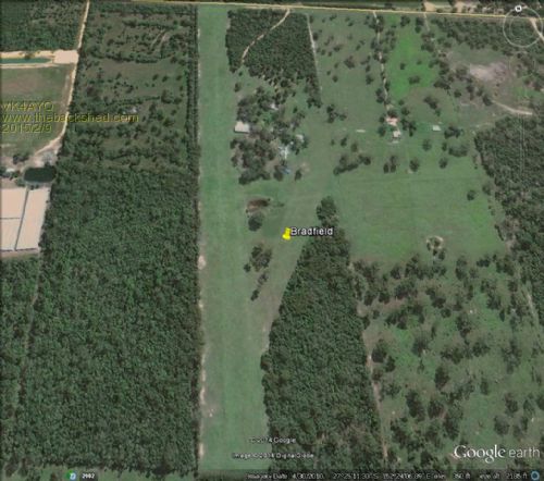

My place is a airfield so that's why I have so much mowing.
We have had a drought here for last year and only mowed once but now it is catching me up.
I had the neighbors cows in for a while but they did more damage than good, destroyed my fruit trees and dug dust baths in the runway so now back to the hard slog of mowing.

Hi George
I found that it slowly soaks down and the trapped air comes to the top along with the light gassing from charging but it is a slow process as the water has to combine with the electrolyte and then recombine with the sulphate powder that has formed due to dehydration some of the real dry cells took 3 months to stop absorbing water even though they where still working as a battery on the remaining moisture in the pack, it would have been at a much reduced AH capacity though.
I do not think that you need to get a vacuum to aid the process as the slow part is really rehydrating the sulphate so it can be broken down into acid and lead again. A light tapping of the case sides brought some bubbles initially but it took time to soak into the matrix, which I presume was nearly dry as I added nearly 1 liter of water per cell over the two months, one cell with the top burnt off is still absorbing water, but it had sat under the bench for several years as well so was really sick.
Not all cells have responded and I have had to discard 8 batteries due to case leakage internally allowing the electrolyte to be on contact with two cells, I may cut the offending side of and recharge to see if the cells can be salvaged by resealing the side with a piece of lexan just for the exercise, I wouldn't trust them back in the bank but may be useful for something else or to prove a point.
All the best
Bob
