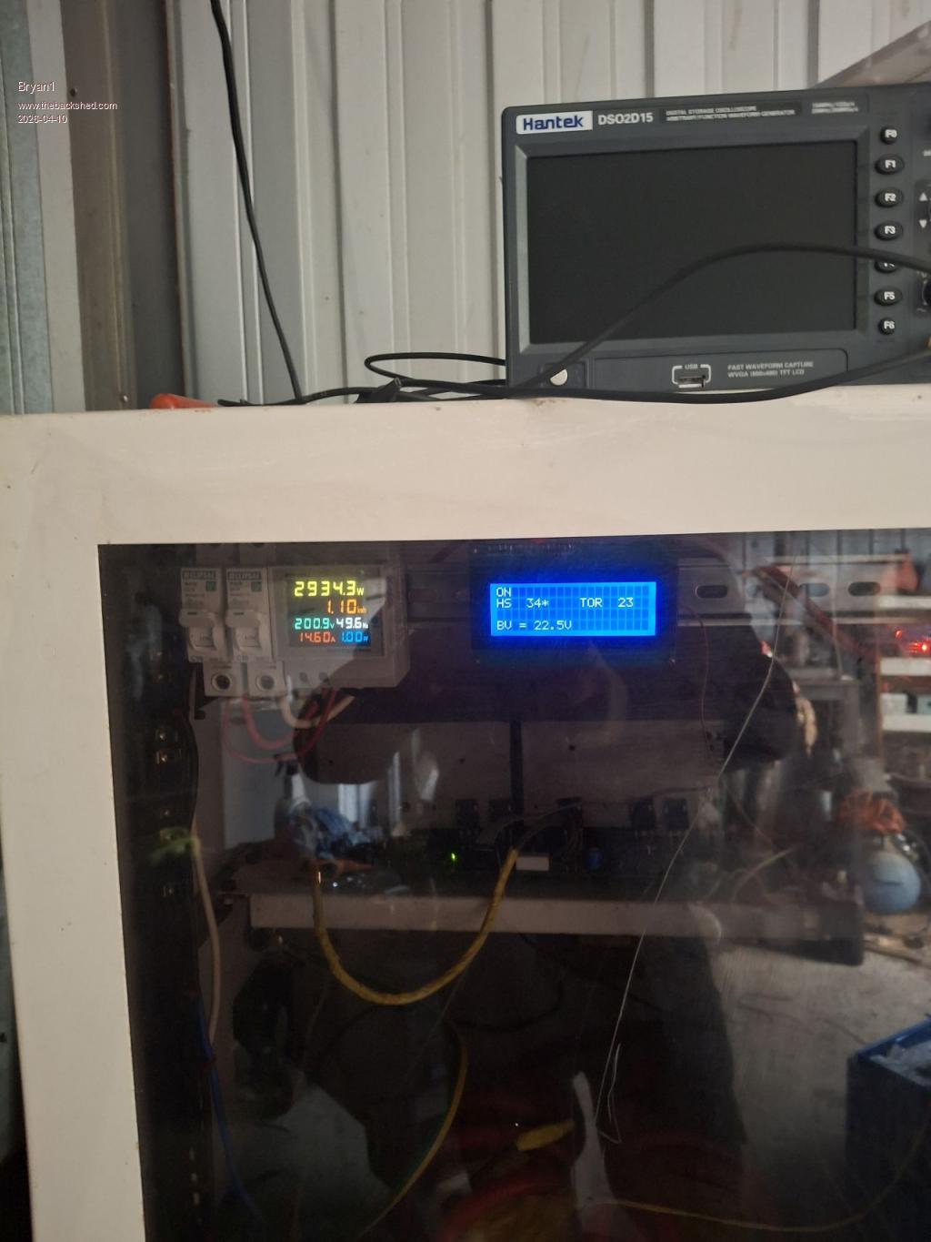

Saw the HS was sitting on 29C and the TOR 23 so turned on the shed for a average 200-300 watt current draw.
Now I have a single and dual old heating elements so decided to use those for the fist load test.
So 3Kw so far
Now the HS and TOR have around 6 to 11 C difference and watching this morning the HS came on after 25 minutes and ran for 4 minutes, so I do think it's best to leave it and see how it goes.

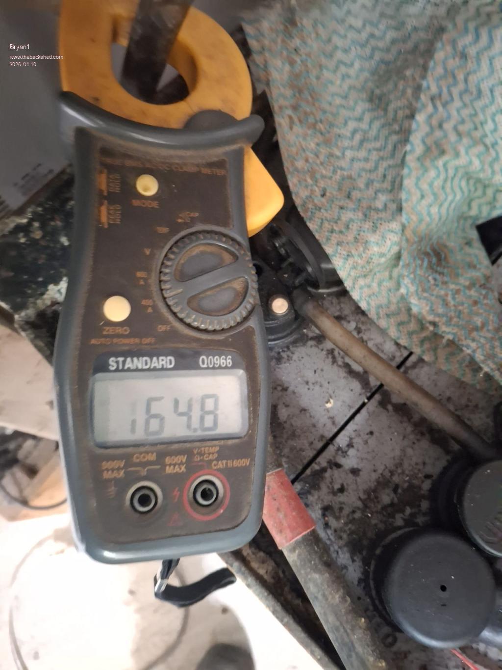

Ok ran the test again and saw 3.4Kw load then it dropped to 3Kw so thought best to know what the DC current is at 3Kw

Hi Bryan, sounds like the inverter is working, the current at 3kw load seems a bit high. That would mean the inverter is only running at 76% efficiency.
Are you sure that there aren't other loads on?
As your loads are resistive I would not expect the inverter to be pulling 3900 watts to run a 3000 watt load.

Hi Pete the single element is 1.5Kw and the dual element is 2.4Kw so yea of the element ratings it is 3.9Kw
Also I do have the shed power load going so with the shed fridge going that may count for 300 watts.
Now I do have an electric 1800 watt oven here so decided to put all 3 elements on
The DC current draw

Yes Pete the LCD shows the temps and with the HS temp it will rise to 36C then the fan turns on and cools it down to 29C then the cycle repeats. The L02 heatsink is the only one warming up but these load tests do prove the inverter can handle the big currents so although there is a problem I'm going to see how it goes long term as it just works

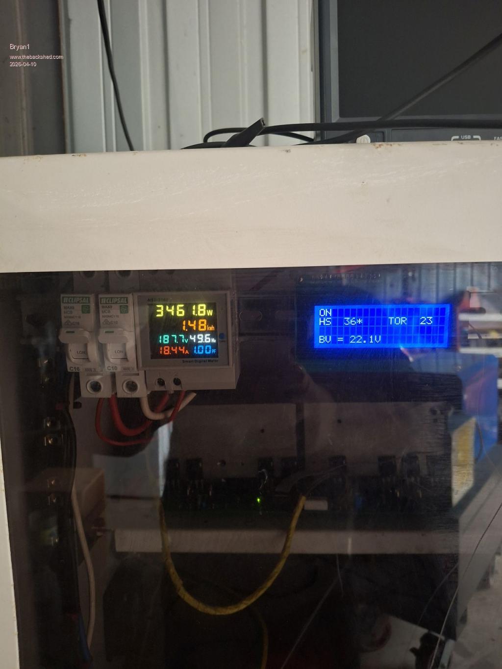

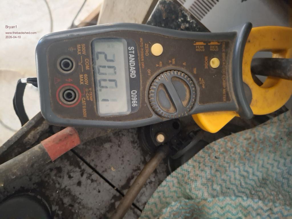

Observations:
BV = 22.1 volts (from picoverter)
DC current = 200.1 Amperes (clamp meter)
Inverter Input Power draw = 22.1 x 200.1 = 4422.2 VA or Watts
AC load = 3461.8 Watts (from Multi-Function meter, pF = 1)
Difference = 4422.2 - 3461.8 = 960 Watts.
Edited 2026-04-10 13:21 by tinyt

Keepis I left this inverter running overnight where that multi function unit said 4-5 watt and it was still the same this morning. Over night when the fridge run didn't make a huge difference in the over night low of the batteries. In fact it was good 1/2 a volt higher using the app for the Victron MPPT than the last few days and yes I do use SG as a reading of battery charge.
Now I just took some temp readings with my infrared temp gauge where the mosfets on L01 are about 2C lower than L02, now looking at the 32C I saw on the mosfets on the outer mosfets the inner mosfet that used for the test is the same as the L01 mosfets.
I am thinking of making the lower temp cut off for HS to 33C as from several temp tests do confirm that 32-33C reading.
4.4Kw so far is a good sign I think too and seeing 18.5 amps on the AC side does make me want to see 20 amps
Also while doing these test I see the AC voltage drop under the load now the 49.6Hz shown on the multi function used didn't budge under load so I do think that is a good sign this inverter is working correctly.

The Nano frequency will not shift with load or regulation, the AC on that Mains monitor should not drop more than a volt or two, depending on the quality of the PF factor calculations for a given load with AC monitor quality.
The picture showed 187v on the AC meter @ 3.4kW, that is a nothing load, AC should not drop unless, wiring, toroid or VFB regulation are not working correctly.
Or - due to toroid design or very low DC input, causing close to 99% PWM drive at low power, leaving no headroom for higher load current regulation.
Or the photo is wrong?

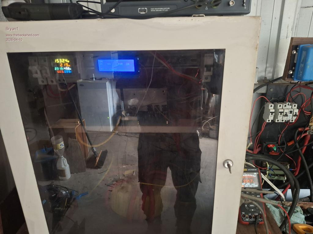

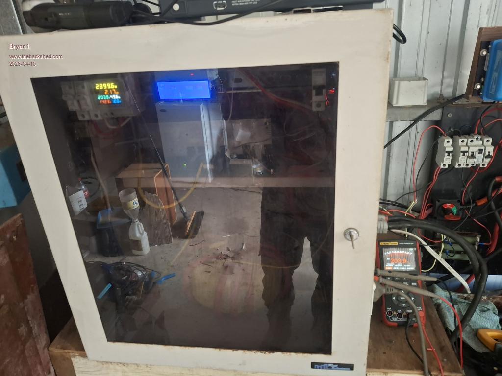

Ok just had to try another test
With the single element
Now with the single element and the toaster oven
So at 1.5Kw no voltage drop but at 2.8Kw the voltage drops so yes a new problem to try and solve.

Those energy meters are quite accurate, I've used many of these over the years and currently have 3 in the Inverter switchboard panel, all are within 500mV of each other. Try testing with purely resistive loads when comparing them against a True RMS DVM.
EDIT: I wrote this while you were posting your photos above, so you have now confirmed
the accuracy of the Meter and the problem you have.
