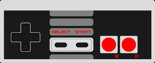

I added NES Style Controller on port A (the Left port) of Mixtel90s PicoGAME VGA Board
pet24an.zip
Controlls are translated like on Game*Mite
But         Returns Key  Action
"DOWN "         Chr$(129) 'down
"UP "           Chr$(128) 'up
"LEFT "         Chr$(130) 'left
"RIGHT "        Chr$(131) 'right
"BUT-A "        "m"       'Move
"BUT-B "        "z"       'Search
"START "        " "       'Start
"BUT-A & BUT-B" Chr$(9)   'Tab
"BUT-A & DOWN   "s"       'Fire Down
"BUT-A & UP "   "w"       'Fire Up
"BUT-A & LEFT"  "a"       'Fire Left
"BUT-A & RIGHT" "d"       'Fire Right
"BUT-B & UP"    Chr$(145) 'F1
"BUT-B & DOWN"  Chr$(146) 'F2
"SELECT"        Chr$(27)  'ESC
FOR GAME*MITE SET
Const nesPG1=0 'Nes Controller on Port1 Pico Game Board
at the Start of the Program
Have Fun
Edited 2023-11-14 02:54 by Martin H.

Posts: 5998
Posted: 06:03pm 13 Nov 2023
@Martin,
- chair in door: fixed
- game_end music: fixed
- trash compactor: only sprites (overlay) implemented now, and atm player is excluded. (easy change, but I though this was a nice twist.. you can outrun a chasing hoverbot into the TC, run to the end, you will not be harmed, but the bot is crushed..
I will investigate changes. Problem: chair=tile showing chair with floor element (blue). hard to use as sprite to overlay. May need chair with magenta background. Same for each other moveable item (chair (4 rotations), canister, box open, box closed, small box open, small box closed, hocker) or we need to accept that floor element is also copied into the trash compactor.
I will look into the NES controller changes.
Looks good, will try with controller soon on PicoGameVGA

On pet24b the NES controller on my PicoGameVGA does not work.
In the startup menu I can press UP/DOWN and START, but in the game it does not work.

  Volhout said  On pet24b the NES controller on my PicoGameVGA does not work.
You just missed one of my changes
change
   'player input through keyboard, clearing buffer, check loop time
   k$="":Text 290,0,Right$("00"+Str$(Timer,3,0),3)
     tmp$=Inkey$
     If tmp$<>"" Then k$=tmp$  'keep last valid key
   Loop Until Timer>h_beat
   Timer =0
   If Game_Mite And k$="" Then k$=c2k$()
to
     tmp$=Inkey$
   Timer =0
   If k$="" Then k$=c2k$()
Function "c2k$()" (the translation of Controller Input to Keypress) should now allways be called, if there is no Keypress.
