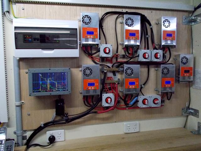

The last Solar charger arrived, now another two sets of 4 x 450W Solar panels to be Installed, one old set of panels is being replaced and this 7th charger has to be wired in with an Isolator switch and fuses, then connected to the 2nd new set of panels, along with another set of 6 gifted 300W panels for charger 6 which currently has no panels due to the rebuild of the solar controller wall and the redistribution of the existing panels.

Posted: 04:25am 18 Apr 2025
My God that's a crapload of Solar Controllers!
It's very neat and nicely organized too!

Posted: 04:46am 18 Apr 2025
I'm a really big fan of redundancy in emergencies, and by having 4 panel per Controller they run de-rated, shading effects can be reduced as they are only 2S+2P sets of panels per controller. I bought most of these years ago when they were around $96 AU, the last one cost me $114 to my door.
