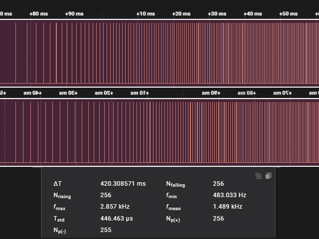

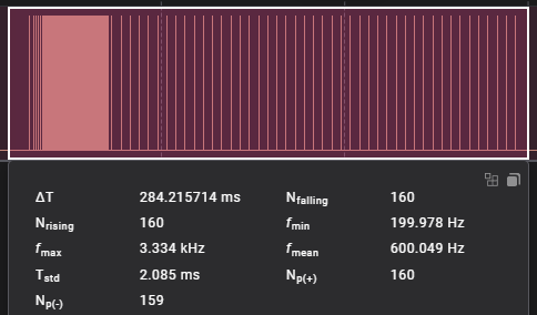

vegipete
Joined: 29/01/2013
Posts: 1180
Posted: 05:54pm 18 Jun 2026
My tests of the above firmware are good. I'm seeing the correct number of step pulses for every value I've tried from A0.0625 (1 pulse) and up. If I request a move of A100, I actual get it, both in the number of pulses, and the reported A position afterwards. And it works fine even up to a 50kHz pulse rate. (An actual motor has other ideas, what with resonance and all, but that is a different story.) The rogue pulses at sub-system start-up also seem to be gone.
The pulse pattern looks like a brute force fix at the end of the pulse train, with a few pulses at 5ms intervals added to get the correct number.  ;-)
With an S-Curve accel profile, this is very noticeable. 44 of 'em in this capture. (Accel = 50000 in this example.)
