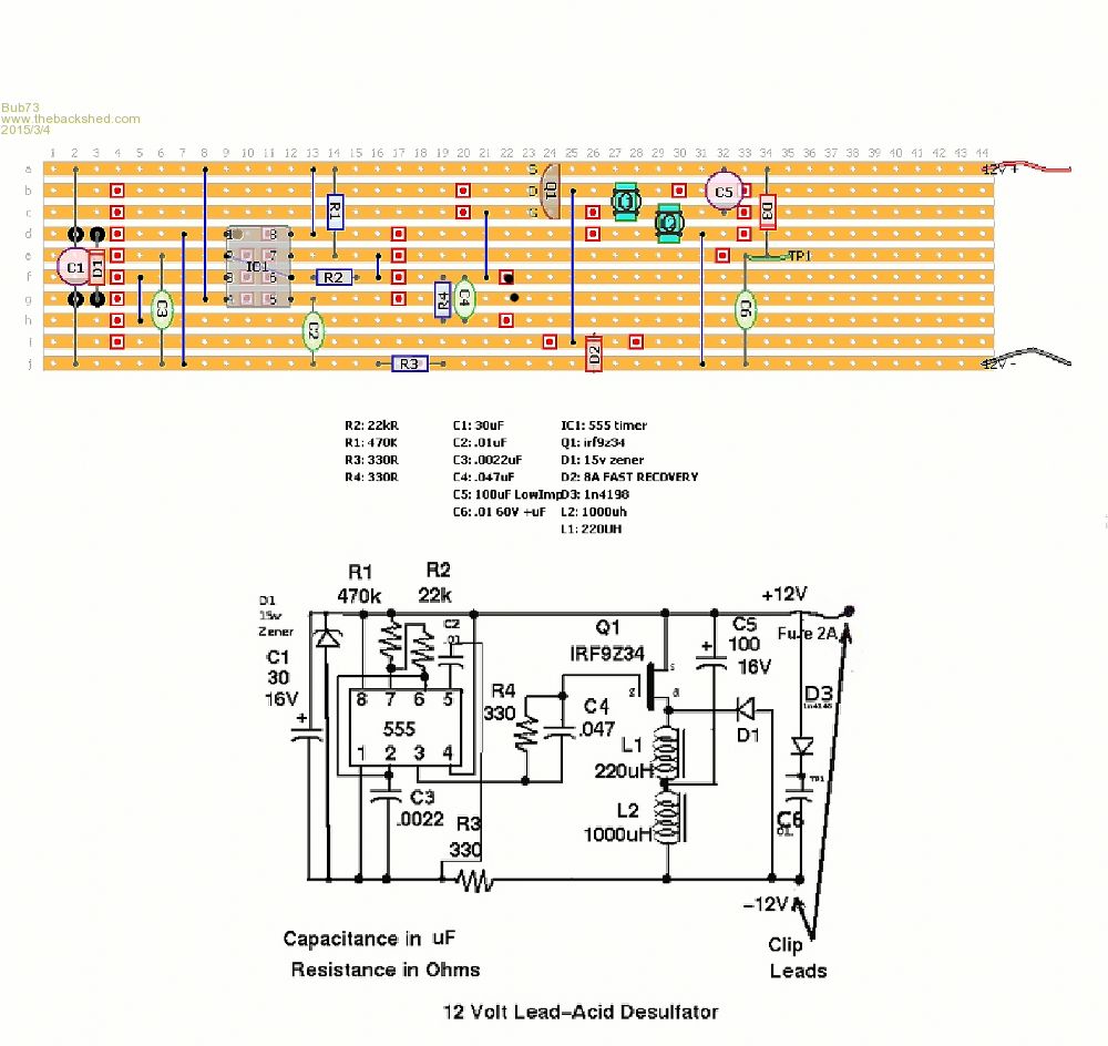

Hi All,
That wants to be a fast recovery diode over 6 amps continuous.
Here is a image for strip board that may help some.
Bob

WOW THANKS, That is exactly the citcuit I am doing, except I had squashed it and turned it around as I had not seen that picture before.
What is the difference between a SUPER HIGH SPEED SCHOTTKY BARRIER RECTIFIER (15SQ045)and the FAST RECOVERY DOIDE (GI826CT) or the BY229 ?
Oops 15 amps/ 45 volts I got that back to front in my last post, Sorry.
I have found some of the data sheets and now my eyesight has gone all fuzzy.
Seriously, I simply don't understand data sheets.
I can solder any parts together and hope the smoke stays in, like putting bolts in an engine and hope the parts stay in.
I have never understood how someone can take a handful of bits and design a circuit, even design the "bit", increadable. I think they are the greatest. I just copy it.
PS. The parts list refers to the strip board not the circuit diagram

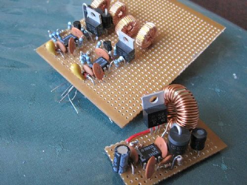

rustyrod
Joined: 08/11/2014
Posts: 121
Posted: 06:25pm 04 Mar 2015
Thanks Bob,
I gotta go bush next week then I hope to get back to see you soon after that.
I went and made a new one, since lunch.
I used a IRF1404 and a 15SQ045
The big choke is 100uH
The 555 is sounding fine.
The diode almost melted on connection.(The smoke stayed in)
In the back ground is 2 doublers, I am waiting for the caps.
Always Thinking

Hi Gorgen,
Only the IC, the Diode 2, Low esr cap and the Fet are polarity sensitive.
If you follow Bub73's strip board it should be easy.
Take your time.
I did not have this picture so I set up my own.
The fet pins (if you lay it down on it's back) should be "g d s"
I don't have the zener or fuse, D3 and that cap.
I do not know if Jaycar have a kit. I see on forums the premade Jacar units are not so good. I have never had one.

Hi rustyrod ;
The zener was added to protect the 555 from over voltage; voltage will sometimes soar if a charger is applied to a sulphated battery.
The junction of D3 and C6 just make a crude test point so you can monitor peak voltage with dvm or crow.
The fuse just helps to limit the amount of magic smoke in case of a malfunction.
Bob

Posted: 01:02am 09 Mar 2015
This yellow board on previous page looks easy, but what happens on the invisible side?
Are all horizontal rows connected together?
Also what red small squares mean?
George
rustyrod
Joined: 08/11/2014
Posts: 121
Posted: 01:39am 09 Mar 2015
The red squares are the cuts in the rows on the invisible side.
You can put a small wire through each red marked hole so when you turn it over you can find it.
Perhaps do all the cuts first before soldering any parts. Use a 1/8 twist drill in your fingers to cut the strips.
Mark each cut on top with a spirit pen and then compare to the yellow board.
If you are using an old piece of strip board - polish the strips shiny before you start.
The heat needed to tin a dirty board will lift the strips.
WATCH OUT - there is a bunch of those red dots under the IC 555!Edited by rustyrod 2015-03-10
