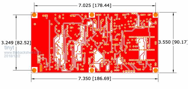

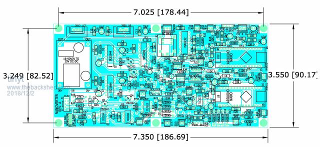

Since there are no more change requests, here is minor revision on the schematic now locked at Rev A. 2018-12-02_035039_nanoverter_Rev_A.pdf
1. Placed values on resistors that are TBD or SEL.
2. Changed Q5 to BJT.
3. More informational notes.
Finally a PCB file(s). Connections were auto-routed, it is the only one I can do. I think it is OK since the operating frequency is low (23kHz). I tried to match PCB outline dimensions and corner mounting holes with those on the Clockman/oztules control PCB.
Will post live files next.
Edited by tinyt 2018-12-03
tinyt
Joined: 12/11/2017
Posts: 564
Posted: 06:48pm 01 Dec 2018
Here are the live gerber files.2018-12-02_044343_NanoverterPCB.zip
1. Schematic pdf
2. Gerbers (zip)
3. Fab notes.
4. BOM
No guarantees that it is error free. Those who have the courage can order the pcb to experiment. Maybe for now have it made using 1 Oz copper.Edited by tinyt 2018-12-03

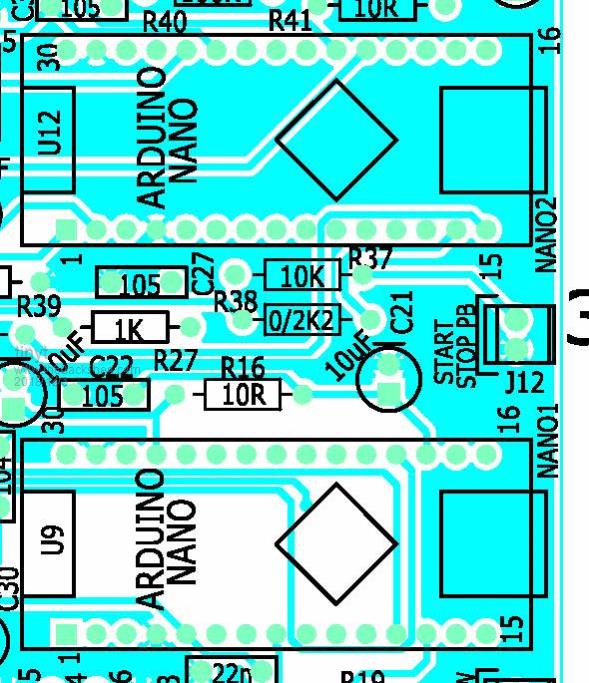

Tinyt and all, I have discovered a problem.
It relates to the displayed AC output voltage.
Nano1 is designed to increase or decrease PWM % to maintain the AC output
to equal the set point. The set point is approx 3.0V.
So nano1 program tries to make VFB = 3.0V.
So far so good.
We adjust AC output voltage by changing the voltage divider R31 trim pot on page 2 to suit the desired AC voltage as measured on the toroid secondary.
VFB signal is connected to nano1, for driving the AC output.
It also is connected to nano2, used to display the output voltage.
The problem is, no matter what calibration we give nano2 for displayed AC voltage, we will always see the same displayed voltage FOR ALL AC OUTPUT VOLTAGES SET BY R31 trim pot.
Nano1 does a good job of doing what is needed to make VFB = 3.0V
It will always = 3.0V, all things going well, no matter the AC output voltage as measured on the toroid secondary.
Solution:
We need a separate AC input for nano2, it can not be the existing VFB.
Could I suggest we run, from positive terminal of C30, a line to a 1/3 voltage divider, then RC LP filter, then into nano2 ADC channel 0, pin 19.
Maybe aim to produce 4.0V here when the output voltage is 240V AC.
This will be a fixed voltage divider, giving a fixed fraction of the AC output voltage. We will continue to use the variable divider (R31) to set the inverter output set point as usual.
I don't know if we need to bother with opamp buffering this.
It's up to you. We call this VSAMP for voltage sample?

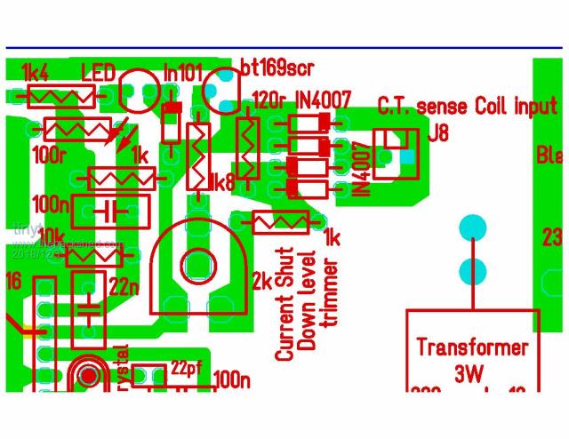

A comment or two; should R23 (120R) not be located directly across the CT terminals?
It may be helpful if nano 1 and nano 2 are clearly marked so on the PCB to avoid confusion. They were referred by that throughout this topic, making the U9 & U12 identification meaningless.
Also, the 6 little boxes (M1 - M6) on page 1, bottom right, have me wondering what they represent?
The connection of the 120R burden resistor is a straight copy from clockman/oztules gerber:
But I think your suggestion is better, it eliminates the current flowing thru the 120R from heating the diodes and affecting the trigger voltage of the SCR. Rev B schematic/PCB will have the change.
The picture of the pcb top is probably not too detailed, here is a close up showing silkscreen "NANO1" and "NANO2" close to the USB connectors at the PCB board edge:
But I think you are also correct, the arduino nanos are not chips but modules. Rev B schematic/PCB will have the change.
M1 - M6 are mounting holes (3.8mm hole, 6.6mm pad), I add them in the schematic to account for all footprints. I will add the info in the rev B schematic.

poida
Joined: 02/02/2017
Posts: 1497
Posted: 11:29pm 02 Dec 2018
Correct:
It is a closed loop system.
Right now, with my test system using a cheap Uno clone for nano1,
the latest nano1 code results in the inverter maintaining the "3V"
as 2.78V
This is not and never will be a problem. I can adjust one line of code
in nano_1_v3_sync_pid to bring it up to 3.0V
look for
ac_setpoint = 0.56;
and change it to
ac_setpoint = 0.604; // 0.56 * 3.0/2.78
If we are using a 12V AC transformer, this will put something like
12V RMS on it's secondary, or nearly 17V peak to peak.
This then is rectified by the bridge, and allowing for 2x diode drops
of about 1V, we probably will see 15V DC across C30, a 4.7uF cap.
Wiseguy proposes putting this into the TLC2272 opamp.
The specs for this opamp say max supply voltage is 8V and inputs must be
within supply volts and -0.3V
I don't like that.
Maybe replace R31 trimpot with a fixed voltage divider, to take 16V to 4V.
Maybe a 6.8K and 2.5K combo, to give 4V
This 4V goes into the opamp input, and it also becomes VSAMP, to lead into nano2 ADC channel 0.
We produce VFB via a trimpot placed at the output of TLC2272, pin 7
which will trim down the 4V to approx 3V. This gives us ample scope to
set the AC output voltage to anything we want.
This is my preferred change to the circuit.
Can we assume the opamp will never get more than 5V input into pin 3?
It is an important question to answer.
Should the opamp get an overloaded input, will it survive?
The inverter then may or may not get a useful VFB with a now compromised
opamp and so PWM duty cycle % will go to maximum or minimum.
This will be a bad thing, and depending on your toriod turns ratio, you will
have 260V AC or higher powering the loads. Probably not a lot higher since
the toroid will become close to saturated and become a near short to the MOSFET bridge.
If I was doing the circuit (after thinking of the above failure mode)
I would not use an active filter on VFB, to remove this risk completely.
Since it is there, could I add a 5V TVS across the opamp input, to opamp ground too?
