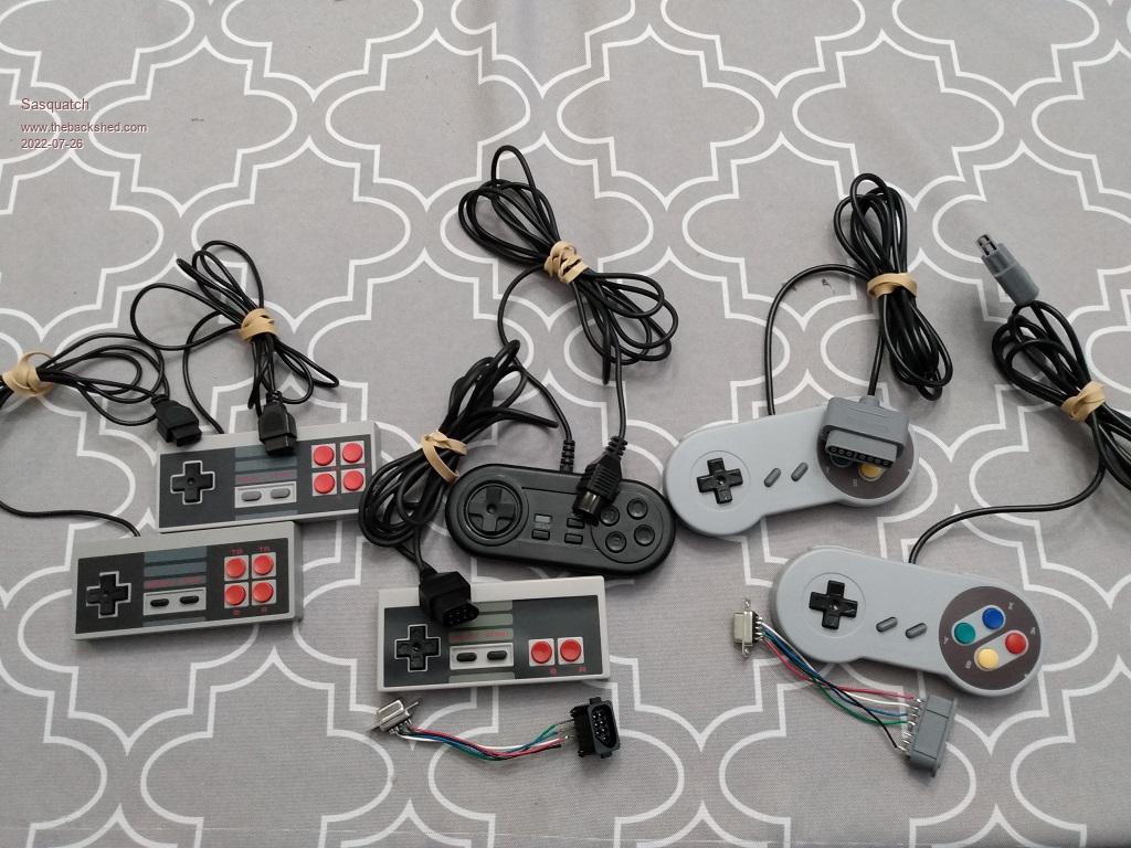

Below is a photo of my growing NES/SNES game controller collection.
I finally got around to making some temporary adapter cables from parts I had at hand to do some testing.
The two on the left are the Famiclone controllers with the 9 pin D connectors.  These have the epoxy-blob chip and exhibit the Right = 129 issue if they don't receive the "extra clock" pulse.  They work fine reading 16bits (16 clocks) with or without the extra clock pulse reporting only the first 8 bits of data.
The two in the center are old Chinese clone NES controllers with the odd shaped 7 pin NES plug.  They also have their chips obscured under an epoxy blob.  They do NOT exhibit the Right = 129 issue.  These work fine at 8 or 16 bits read with or without the extra clock pulse.
The two on the right are newer clone SNES controllers from AliExpress with the flat 7 pin SNES plugs.  They also have an epoxy blob chip.  They do NOT exhibit the Right = 129 issue.  These work fine at 8 or 16 bits read with or without the extra clock pulse.  These ARE true SNES controllers and report all 12 bits of data correctly.  Note that the buttons are mapped slightly differently than the NES controllers as shown in the post by @thwill above.  The most annoying change in button mapping is that the bits for the "Start" and "Select" buttons are reversed.
I also noted that about half of these cheap clone controllers have a wonky D-Pad where it is difficult NOT to press multiple directions at once.
Edited 2022-07-26 13:09 by Sasquatch

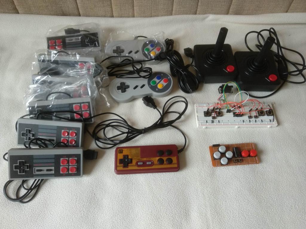

  Sasquatch said  Below is a photo of my growing NES/SNES game controller collection.
Lighweight!
   - at the far left are the AliExpress 9-pin "NES" gamepads. These all have the Right=129 issue and 25+% of them have the wonky D-Pad issue. I have so many because they were very cheap and I can afford to just give them away.
   - top middle are the AliExpress 9-pin "SNES" gamepads that turned out to have "NES" internals. They don't have the Right=129 issue and have "so far" good D-Pads.
   - front middle is a "New Old Stock" 9-pin Famicom gamepad that I got with my Gigatron kit several years ago. It's a bit unresponsive, possibly because I've had it in pieces so many times.
   - top-right are AliExpress Atari joysticks. They seem to work fine.
   - middle-right is my solderless breadboard "NES" gamepad with a discrete 4021. It works great, though the ergonomics are poor .
   - bottom-right is my perfboard "NES" gamepad with a discrete 4021. It works great, though again the ergonomics are poor .
  Sasquatch said  The two on the right are newer clone SNES controllers from AliExpress with the flat 7 pin SNES plugs.  They also have an epoxy blob chip.  They do NOT exhibit the Right = 129 issue.  These work fine at 8 or 16 bits read with or without the extra clock pulse.  These ARE true SNES controllers and report all 12 bits of data correctly.  Note that the buttons are mapped slightly differently than the NES controllers as shown in the post by @thwill above.  The most annoying change in button mapping is that the bits for the "Start" and "Select" buttons are reversed.
I have a pair of what I suspect are these in the post ... that's annoying about the Start/Select buttons, I've checked my previous post and I'm reasonably certain it is correct.
  Sasquatch said  I also noted that about half of these cheap clone controllers have a wonky D-Pad where it is difficult NOT to press multiple directions at once.
This is as far as I am concerned the biggest problem with this project, it is simply not clear what reliable "new" gamepad can be recommended. There are some "new" gamepads on AliExpress that look like the maroon Famicom controller in the above picture, I might order a couple of those at some point.
Edited 2022-07-26 19:45 by thwill

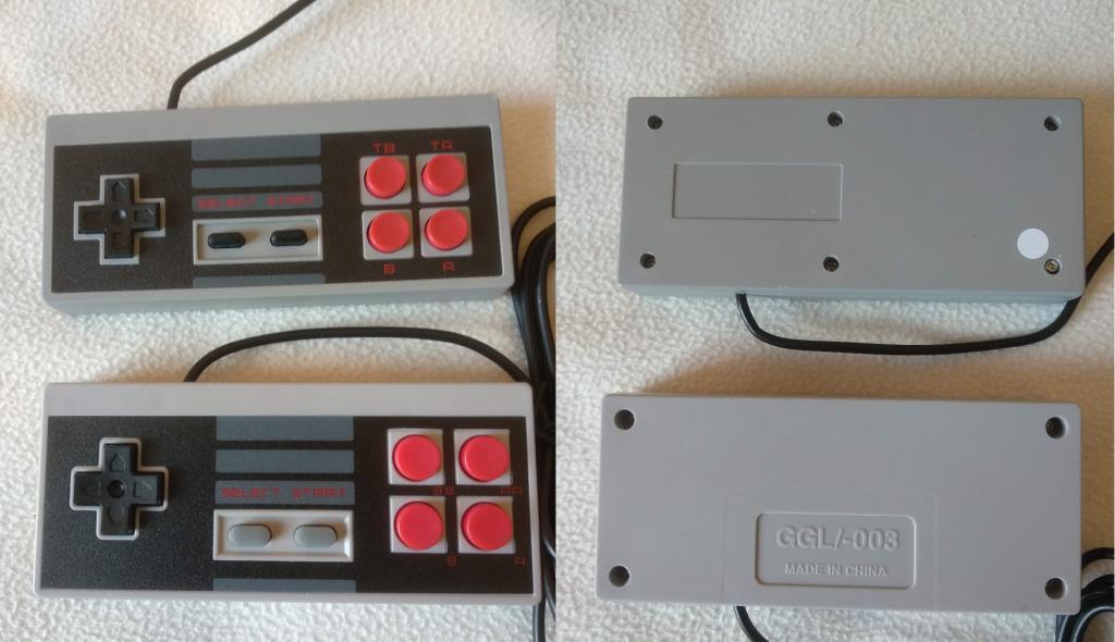

Me again.
I obviously hadn't been paying much attention before, but I was sorting out a couple of gamepads for @Volhout and actually there are significant cosmetic differences between the "NES" gamepads with the "sloppy" D-Pad and those that are actually useful - both sorts display the Right=129 issue though:
The top one is "bad" and the bottom one is "good", differences are:
1. Good ones have grey start/select, bad ones have black.
2. Good ones are a slighly lighter grey colour.
3. Good ones label the red buttons in their bottom-right corners as A, AA, B, BB whereas bad ones label them either top or bottom centre as A, TA, B, TB
4. Good ones have a "model number" GGL/-003 embossed on the back, bad ones just have an empty space where some text is meant to go. Note that I added the white sticker, it will get a black X in it later.
5. Good ones provide more resistance to button pushes - I suspect this is the key difference; I haven't dismantled them but I bet they have better quality rubber/conductive domes under the buttons.
6. Good ones are very marginally thicker.
7. Good ones have a marginally more matt finish on both body and buttons.
The good ones also just feel slightly better made, but that may be psychosomatic because I know they work.
Alas I can find no items on eBay or AliExpress advertised with pictures of the "good" ones, even the listing I bought them from has a picture of the "bad" ones ... and to make matters worse I bought both batches good and bad from the same listing !
So interesting, but basically of no bloody use.
@Mixtel90 - I'm afraid I think you got "bad" ones.
@Volhout - You've won the $5 jackpot as I will send you some of my "good" ones.
Edited 2022-07-27 04:20 by thwill

My perfboard controller with the big chunky (Chinese) tac switches rather than a D-pad feels very satisfyingly clicky, but the trimmed component leads on the underside make it is a bit uncomfortable to use for very long. I'm sure it would be very acceptable sandwiched between two rounded rectangles of acrylic though ...
Hmmm ... can you get (cheaply) PCBs with the corners rounded off, if you could then a controller could be made from a sandwich of three PCBs, the bottom would be a blank, the middle would be the actual PCB and the top would be another blank with holes cut out for the tac switches to poke through, the problem might be getting the correct spacers for between the middle and top PCBs.

These are "bad" but they did what they were intended to do.  :)
I'm having fun with a controller design. Did away with the disc-with-stem idea and simply glued a 25mmx5mm thick disc onto a 30mmx3mm thick acrylic disc (both available from ebay). The hole in the box is 25mm clear (could be 26 dia). With 0.8mm tactile switches I would need to pad the pcb with a 0.3mm washer to get it to line up on the pcb pillars in the box. O.5mm washers might actually be realistic. The tactile switches are through-hole 2-pin Alps Alpine at £7.10 for 10 incl. VAT, but I've just grabbed some that looked right. There are cheaper ones. This design of pad leaves an area of open PCB under it, which may come in useful when I get to the electronics.

  thwil said  Alas I can find no items on eBay or AliExpress advertised with pictures of the "good" ones, even the listing I bought them from has a picture of the "bad" ones ... and to make matters worse I bought both batches good and bad from the same listing !
I received one of each in the same batch with a single order!  On closer inspection they are exactly as you describe.
  thwil said  I have a pair of what I suspect are these in the post ... that's annoying about the Start/Select buttons, I've checked my previous post and I'm reasonably certain it is correct.
Yes, your button mapping is correct.  I was thinking the select and start buttons were different between the NES and SNES controllers, but after checking again, I was mistaken.
After further review, the AliExpress SNES controllers with the flat 7 pin SNES plug are slightly larger, have rounded ends, the D-Pads aren't wonky and they don't have the Right=129 issue.  Overall I like the feel of them.  They are slightly more expensive but the quality seems much better.  I think my current solution will be to transplant some 9pin cables from the wonkier NES controllers to the SNES controllers that came with the 7 pin SNES plugs.  This might not be the ideal solution for everyone.
I'll be interested to hear your impression of them when yours arrive.
