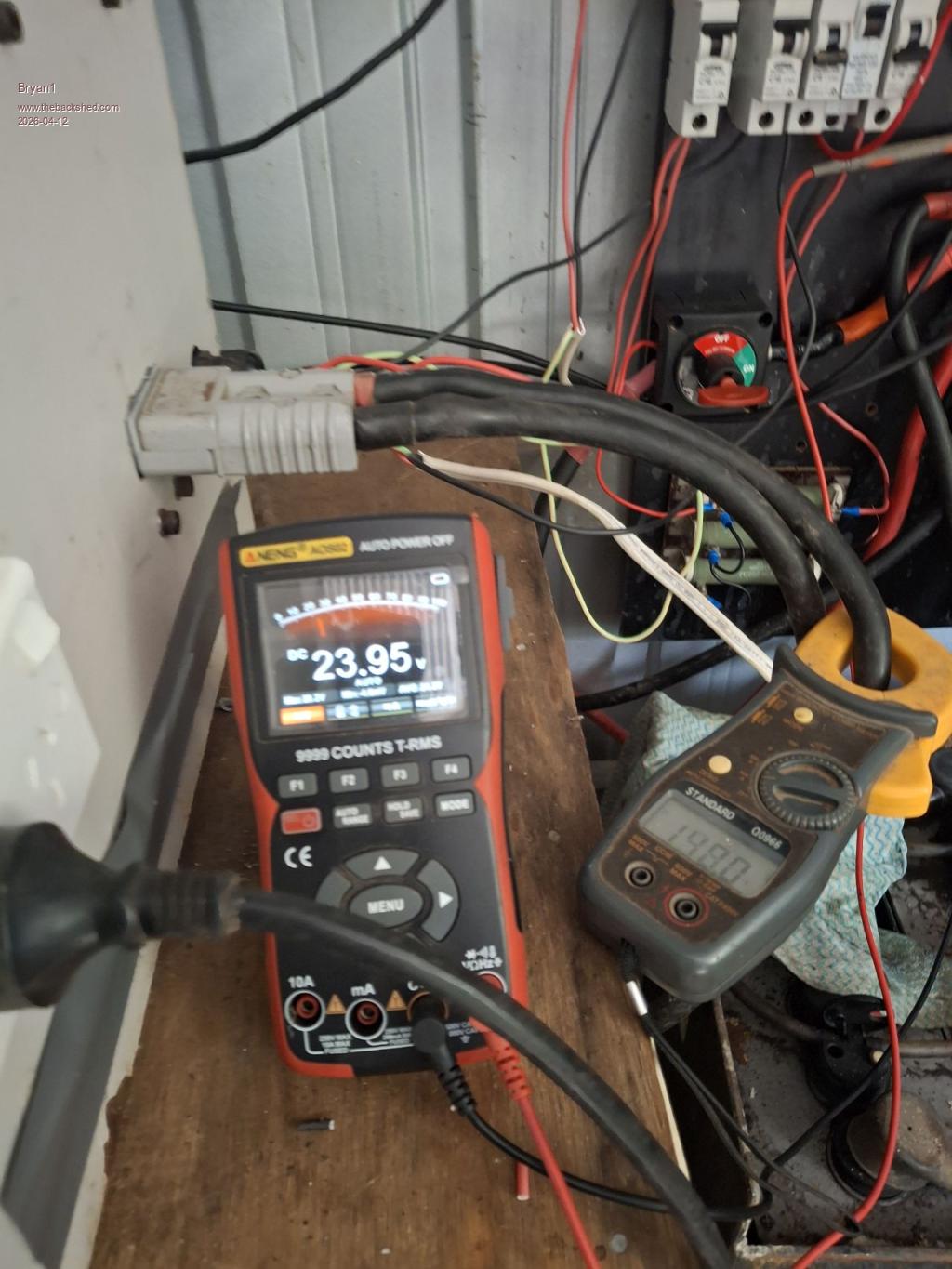

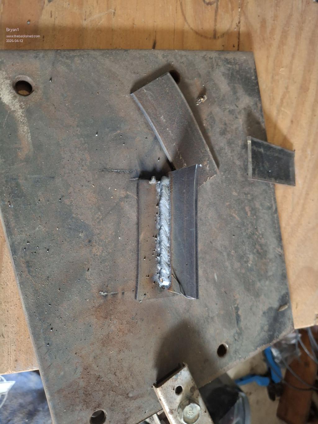

Well decide to test my mig welder out and did a 75mm fillet weld @110 amps and 18 volts and it just worked
Now I need to talk nice with my missus so she can come up to the shed and take a pic of the energy meter .
Bryan1
Joined: 22/02/2006
Posts: 2297

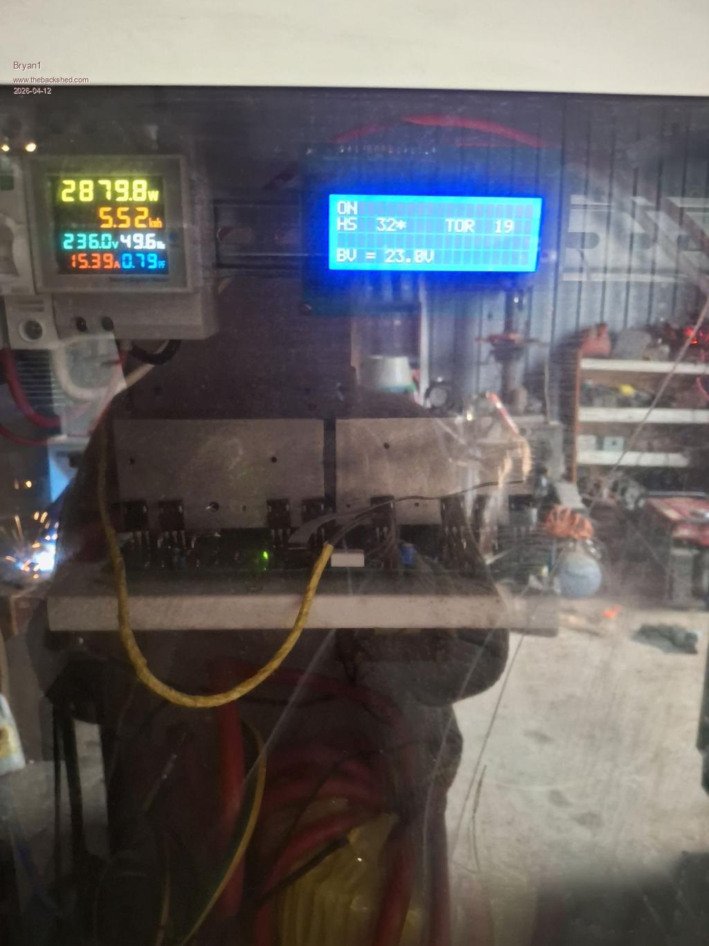

Posted: 01:23am 12 Apr 2026
Ok seems I did talk nice enough
Now of course the fillet weld
Now Vbat 23.95 volts and with a 148 DC current draw
148 x 23.95 = 3544.6
The energy meter 2879.8
So 664.8 watts difference.
Also the AC volt voltage dropped to 236 AC volts which is 5 volts under the VFB so much better regulation than with a non resistive load I do think
Regards Bryan
Edited 2026-04-12 11:33 by Bryan1
Posts: 3412
Posted: 01:37am 12 Apr 2026
236V at almost 3kW with a reactive load looks good enough to me.
Unless others who have built this design say otherwise perhaps leave the secondary as it is.

Just dialed in the setup to get a much better weld and welded around 200mm of scrap and no complaints from the inverter
So finally got my mig welder going
Well as the mig is drawing around 3Kw that would be the biggest load and to see it just work has me one happy camper

tinyt
Joined: 12/11/2017
Posts: 564
Posted: 01:56am 12 Apr 2026
  Bryan1 said  Ok seems I did talk nice enough
Regards Bryan
81.2% Efficiency

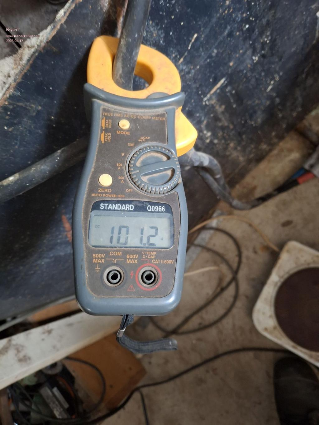

Posts: 3412
Posted: 04:00am 12 Apr 2026
I have my doubts about the DC clamp meter reading. The high frequency ripple on the DC may be giving a false high reading.
The lost Watts don't just disappear, they get converted to heat. Check the temperature of everything between the battery and the inverter with a load of 2kW or more.
80% efficiency would mean 500W is being turned to heat (2.5kW in x 80% = 2kW out). That would make the cables, connectors, toroid or heatsinks too hot to touch, perhaps hot enough to melt the cable insulation.
If they are just warm then you are not loosing that much.

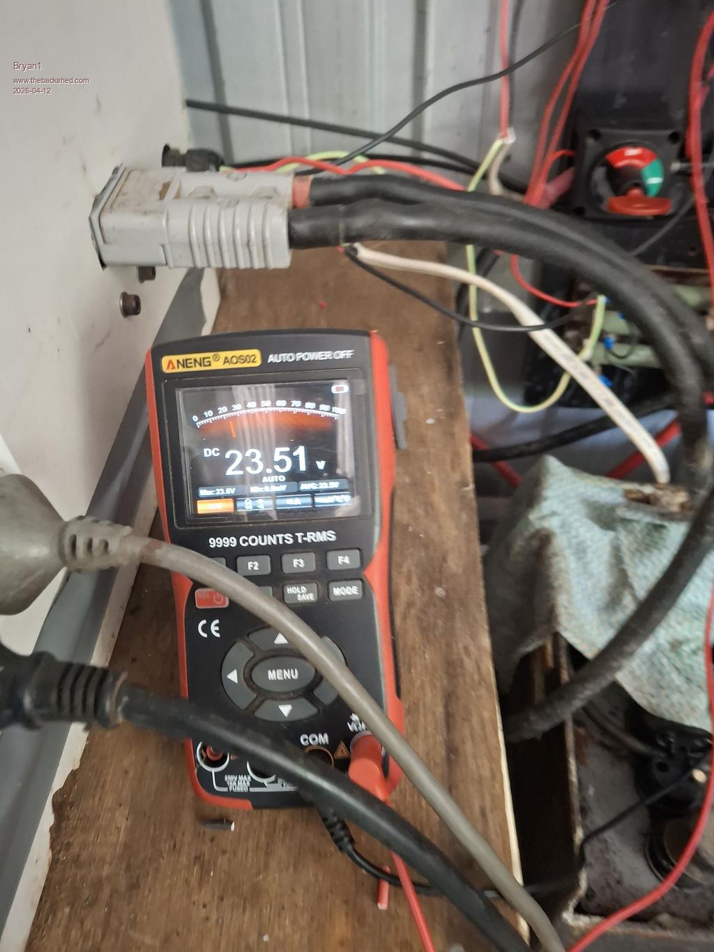

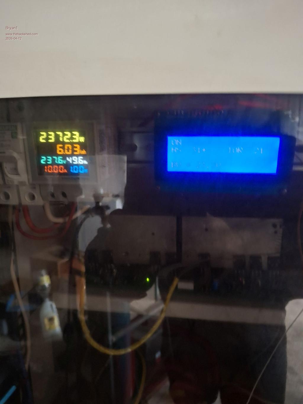

Bryan1
Joined: 22/02/2006
Posts: 2297
Posted: 04:21am 12 Apr 2026
Ok this time I put the clamp meter close to the negative battery terminal, turned on the toaster oven and one element.
Now 23.51 x 101.2 = 2379.2
The energy meter 2372.3 so that a lot better, now the AC voltage was 235 volts and I did notice turning on a 2nd element caused the voltage to drop to 215 volts.
Also while I was doing this test I did feel all the cables and no heat was felt.
Now with the primary it was 14 turns and with one turn taken off the regulation was much better, now with these resistive loads going above 3Kw does cause the voltage to drop off so maybe taking one more turn out so 12 turns may be a better match.
This would mean I will need to rewind the primary so the output cables are close to equal then I could bury the temp sensor better to get a true TOR reading as I did notice the toroid was warm to the touch this morning.
Edited 2026-04-12 14:37 by Bryan1
