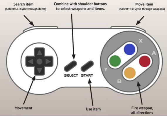

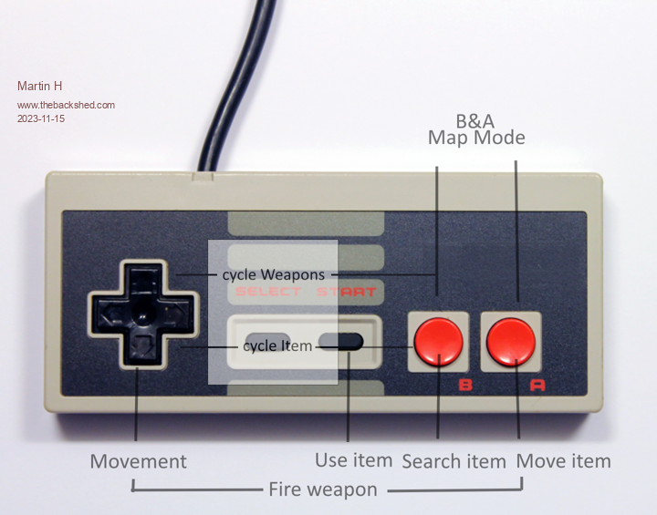

Joined: 04/06/2022
Posts: 1547
Posted: 05:43am 15 Nov 2023
the goal would be the SNES Controller,which I dont have right now.
source: PetsciiRobots user Manual
if they work with 3.3V The way it is connected is identical to the NES, only the software has to evaluate 12 bits instead of 8,
The controls on the GameMite or NES controller are already a compromise, as there are too few buttons, but they are still playable
(Control via a single Atari joysticks is not provided because they simply have too few buttons)
for control, you can always use the keyboard instead of the controllers
Cursor Move
A W S D  Fire
Z        SEARCH
M        Move
SPACE    USE
TAB     cycle Map Mode
F1       cycle through weapons
F2       cycle through items

  Volhout said
I checked the NES controller, and it works in this version (set nesPG1=1 in line 5).
Happy gaming....
somhow the changes in the c2k$ Function didn't made it to the D Version?!
so the combination of buttons didn't work
NES delivers the output in a different order, so the possible combinations have to be queried at the moment. It's not elegant, but it was important to me that it works at all. so for Using NES Controller it should be like this:
Function c2k$()
 Local c$,tmp$
 If nesPG1 Then
   c$=nes_input$()
 Else
   c$=contr_input$()
 EndIf
 If c$<>"" Then
   Select Case c$
       Case "DOWN "       : c2k$=Chr$(129)'down
       Case "UP "         : c2k$=Chr$(128)'up
       Case "LEFT "       : c2k$=Chr$(130)'left
       Case "RIGHT "      : c2k$=Chr$(131)'right
       Case "BUT-A "      : c2k$="m"      'A
       Case "BUT-B "      : c2k$="z"      'B
       Case "START "      : c2k$=" "      'Start
       Case "BUT-B BUT-A ","BUT-A BUT-B ": c2k$=Chr$(9)  'Tab
       Case "DOWN BUT-A " ,"BUT-A DOWN " : c2k$="s"      'Fire Down
       Case "UP BUT-A "   ,"BUT-A UP "   : c2k$="w"      'Fire Up
       Case "LEFT BUT-A " ,"BUT-A LEFT " : c2k$="a"      'Fire Left
       Case "RIGHT BUT-A ","BUT-A RIGHT ": c2k$="d"      'Fire Right
       Case "UP BUT-B "   ,"BUT-B UP "   : c2k$=Chr$(145)'F1
       Case "DOWN BUT-B " ,"BUT-B DOWN " : c2k$=Chr$(146)'F2
       Case "SELECT "     : c2k$=Chr$(27) 'ESC
   End Select
 EndIf
End Function
'no comment
Posts: 6103
Posted: 07:17am 15 Nov 2023
Oops.. Will be in the next release.
I just checked walking around and not the button combinations.
I used the NES controller depicted in the post above. It was send to me by Tom, to test for the "9'th clock" that some controllers need.
Good that you found it...
Edited 2023-11-15 17:19 by Volhout
Martin H.
Joined: 04/06/2022
Posts: 1547
Posted: 08:10am 15 Nov 2023
  Volhout said  Oops.. Will be in the next release.
I added it here and also changed the Start menu for better responding on controllerinput
Now "Select MAP"and "Difficulty" are much better usable with Controller
pet24ds.zip
Edited 2023-11-15 18:24 by Martin H.
