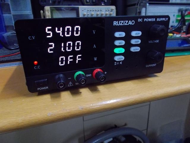

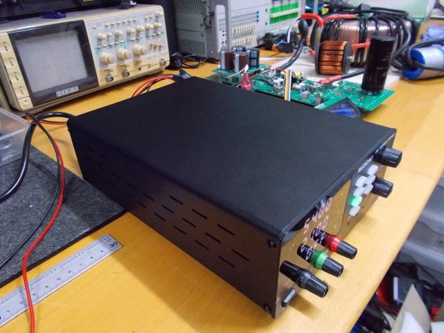

FYI: A new toy, 20A @ 60V 1.2kW SMPS.
Now I can run some real power on the bench when testing various projects, and also use it as a LiFePO4 20A charger with CC and an OV cutoff if ever needed.
I hummed and harred for a few days over purchasing the thing, it's a lot more than the standard 5A SMPS PSUs. But with overnight delivery from Local (Azon) Stock, and at a lower cost than the other big three from overseas, I gave in, closed my eyes and hit the pay button.
I'm glad I did as I really like this unit, it's only 2.8kG, compact with a nice BIG display, good sized knobs and button and nothing fiddly or cheep about it, and it has a thick metal cabinet.

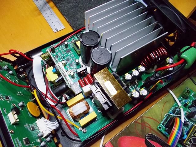

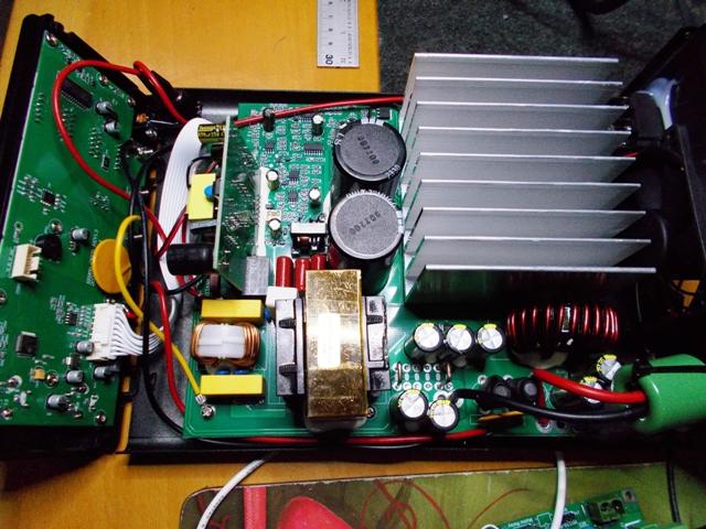

Really nice circuit board with a big internal heatsink. Front connectors < 5A, large rear connectors for high current. Three memory settings and fast/fine voltage and current adjustment encoders, push to select the digit to increment with, and it remembers the last digit position selections.
Adjustable over voltage and over current settings on top of the normal CC, CV and the 1.2kW is a continuous rating. It took ages to find a few any sites that had tested these for noise and stability, one had tested extended time running high power class A equipment, they appeared to be impressed.
Also No unplugging leads to change settings as the OUTPUT button isolates the load. So far it has run cold and reportedly the Fan does only start with long runtime at high power.
This unit with optional memory and OV / OC protect is a bit more than the standard unit, but I'm glad I went with it.
wiseguy
Joined: 21/06/2018
Posts: 1338
Posted: 03:22am 19 May 2025
I saw that power supply too and am considering buying one, I think it was around $360AUD from memory - thanks for bench testing it :).

The PSU: For what it's worth, under the cover of the Power Supply, all IC and components have part numbers, most parts appear to be quality items.
