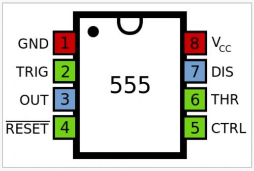

Great timing Bob with web-page reminder.
Looks that LM555 number 1 pin is marked with little dot on reverse side.
George
Georgen
Joined: 13/09/2011
Posts: 462
Posted: 07:54pm 13 Mar 2015
Found answer here:
http://en.wikipedia.org/wiki/555_timer_IC
George
