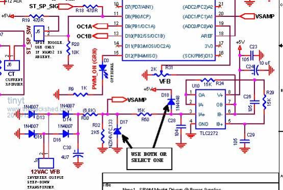

  poida said
If we are using a 12V AC transformer, this will put something like
12V RMS on it's secondary, or nearly 17V peak to peak.
This then is rectified by the bridge, and allowing for 2x diode drops
of about 1V, we probably will see 15V DC across C30, a 4.7uF cap.
Wiseguy proposes putting this into the TLC2272 opamp.
The specs for this opamp say max supply voltage is 8V and inputs must be
within supply volts and -0.3V
I don't like that.
So why are we bothering with 12V transformers when this puts out worrysome voltages.
My EG8010 based inverters have been running perfectly fine with a 6V transformer for the VFB source. It just requires different voltage divider values.
Aliexpress has a heap of suitable PCB transformers like this.

  Tinker said
I don't like that.
If Im going to get quoted it would be nice if least my words & context were used - as I did not say that at all I actually said
etc "The input of the filter would be a normal voltage divider ~ say 12V in 3 or 4V out. The pot connects to the filter out & drives the VFB pin" etc
Edited by wiseguy 2018-12-04

If we can just chose a VFB source which will not blow up the opamp's input and
presents approx 3V DC to the nano ADC input I'd be grateful to all.

OK guys, how about this.
As in rev A, VSAMP is also connected to nano2 pin19 with a 105 cap to gnd. VSAMP connection to nano1 is there as an option to code for or not.
Please review and comment. Thanks.Edited by tinyt 2018-12-05

  tinyt said   OK guys, how about this.
D18:
IN4148 specs Vf = 0.6V at near zero current, rising to 1V at 10mA
Having this clamping input to 5V + diode drop still permits
the TLC2272 to receive inputs exceeding supply voltage.
T.I. specs have on page 5 the max input pin voltage limit = supply voltage.
I suppose this tight upper limit is due to the rail to rail design?
When I build my board, I will only use the zener.
this 4.8V NZD series probably
Edited by poida 2018-12-05

Poida is correct to be cautious, and depending on what transformer, Resistive dividers etc being used then an op amp with same pin out but higher voltage capability on its inputs could be substituted, LT1638, I have used both in these filters with same measured results. The Linear LT1638 is a rail to rail non-cmos micropower, with higher voltage and output, perhaps better suited if builders mess up the voltage dividers, or use a higher voltage transformer.

Here is the revised nano1 schematic with LT1638 opamp filters used for VFB and VSAMP. 2018-12-04_131058_SCHEMATIC1___Nano1.pdf

Correct me if I am on the wrong track, but the change to LT1638 opamps
means we no longer need to care if inputs are a bit over the chip's V+ supply.
The specs seem to read as up to 44V from V- will not be a problem.
If so, then that is why protection zeners/diodes have been omitted from the latest schematic.
I really like the idea of having approx (44-5)V headroom for inputs into the active filters. Bullet proof?

Solar Mike - is it a good plan to have a voltage feedback trimpot with no low side resistor to set a range. If someone powers up with or adjusts the trimpot to zero, effectively with no feedback wont it just drive the output to maximum ?
I also dont follow why there are 2 filtered voltage inputs on nano1 pins 19 & 20?

  Solar Mike said   You are on the right track Poida, the LT1638 has a much higher input capability albeit at a higher cost for the PDip versions. Actually it would still be a good idea to keep the silicon clamping diode in place between the input pin and +5v, I don't know what sort of transformer voltage people are going to use, and if they mistakenly use the wrong resistors in the divider then keeping the diode may save the op amps.
How fast does the Nano respond to voltage changes on the AC, seems we are at the mercy of the RC time constant of the bridge rectifier and capacitance + loads. With the Nano couldn't you just measure the P/P AC off the transformer directly to give a more accurate and faster measurement?.
Mike
  wiseguy said   Solar Mike - is it a good plan to have a voltage feedback trimpot with no low side resistor to set a range. If someone powers up with or adjusts the trimpot to zero, effectively with no feedback wont it just drive the output to maximum ?
I think the pioneers used the isolated transformer approach for VFB. Just following what others have successfully built. But if the EG8010 fig 8.1c datasheet is followed, the hardware will be simpler (or maybe not, datasheet fig 8.1c shows dual tracking trimpot and two identical chokes). And if EG8010 fig 6-6 datasheet is followed, then there could be lethal 220vac on the control board.
Right now I am just doing 'paper drawings' and incorporating what is being discussed. Here is the revised nano1 schematic for review/comments.2018-12-05_021315_SCHEMATIC1___Nano12.pdf
1. Restored resistor at the bottom of the VFB trimpot.
2. Restored diodes to +5V at the input of the opamps. (PN = TBD)
3. Restored zener diode between the top terminal of the VFB trimpot and gnd. (PN = TBD)
4. Added note for VSAMP connection to pin 20 of nano1 (this is for me to learn coding but I can remove the connection if it creates confusion)Edited by tinyt 2018-12-06

I would want low side resistors too, the inverter will go to 100% PWM if the trimpot is set incorrectly.
I suspect it would be best if before first use of the control board, the builder
applies 240V (or 120V, Tinyt) to the 12V transformer and adjusts output at the trim pot wiper to be about 2.7V
This 2.7V corresponds to the value (as seen in nano1 code) of
ac_setpoint = 0.56;
As for why 2 filtered voltage inputs, I am OK with this. It allows
nano1 to recognise when Vfb is improperly set or Vfb filter/opamp is bad, IF I code such a function.

Please review/comment/etc.
If there are no more corrections/changes, I will work on the gerbers. Thanks

I think R23 should ideally be located on the other side of the diode bridge as per the Oztules design, the circuit and values should just work as before. Maybe allow 2 pads for the input side of the bridge for evaluation.
As it is now the voltage applied to the sense circuit will be at least ~ 1.3V less than the original and any Vf temperature effects of the bridge are not compensated for automatically. During low currents the first 1.2V of current signal generated by the current transformer will be lost & only higher currents will be able to be measured.
Other than that it looks good to go.Edited by wiseguy 2018-12-06
