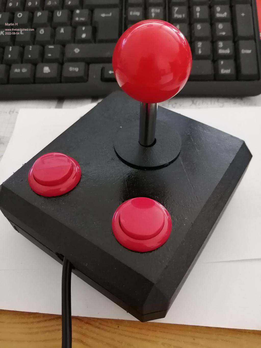

That looks like just a brick with no features, but one can take it for measurement to build a working gamepad.
Just Printed this one https://www.thingiverse.com/thing:2890310
because I had this 4 way microswitch arcade joystick lying around from a previous Ali Express order
I just had to adjust the diameter of the buttons before I printed the top.

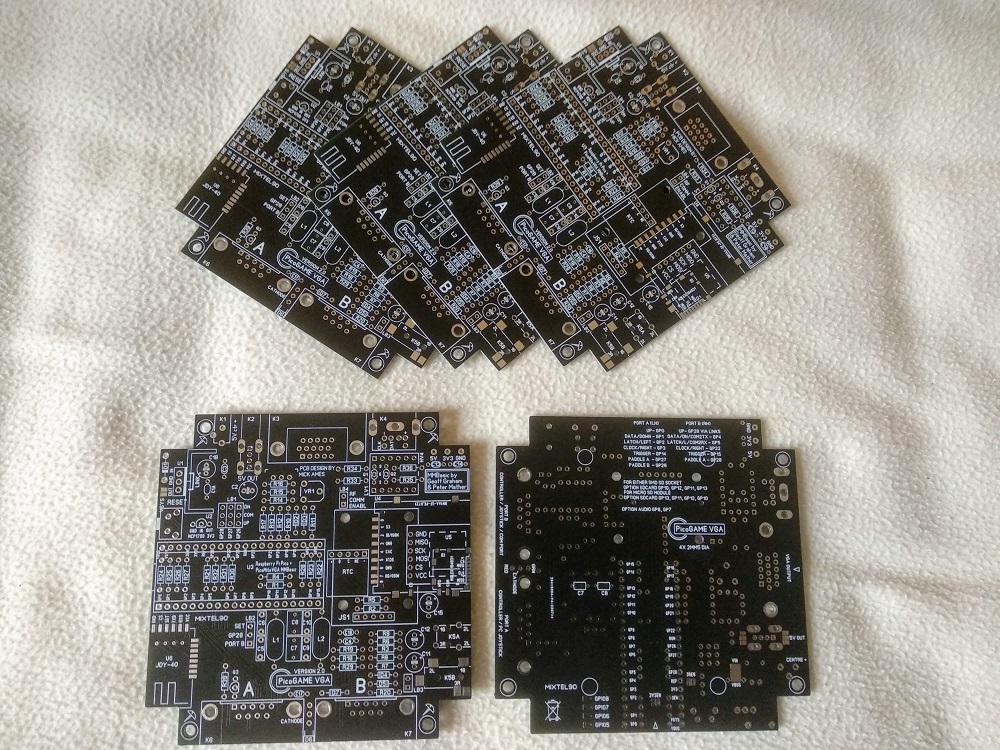

New deliveries from JLCPCB, some v2.0 PicoGAME PCBs:
One of them is of course yours if you want it Mick ?
Probably going to be a couple of weeks before they hit the workbench, but expect queries regarding the BOM in the meantime.

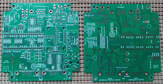

Crikey - did I design that thing with all those holes in it?
Yes please, Tom. :) That would be most kind of you.
I think I must be getting close to the ultimate design on this now. It's *possible* to fit more stuff on, but connecting it to the PicoMite is very difficult now. I almost changed the VGA output to the simplified one to fit four resistors to make phone charging more flexible, but it adds nothing to the game and removes the possibility of using it with monitors that have strange input requirements. I suspect the next version (if one is necessary) will only be bug fixes. We'll see. :)

Posts: 8978
Posted: 09:31am 30 Jul 2022
PCB has just appeared, Tom. Thanks!  :)

Posts: 3829
Posted: 05:37pm 30 Jul 2022
And mine arrived today--16 days after ordering them from JLCPCB. Slow boat shipping times back to pre-pandemic.

a little ot...
I soldered my 3d printed joystick yesterday.
It's just not entirely clear to me, which pin should be the corresponding one.
Plus 3.3 V (7) or ground (8)
