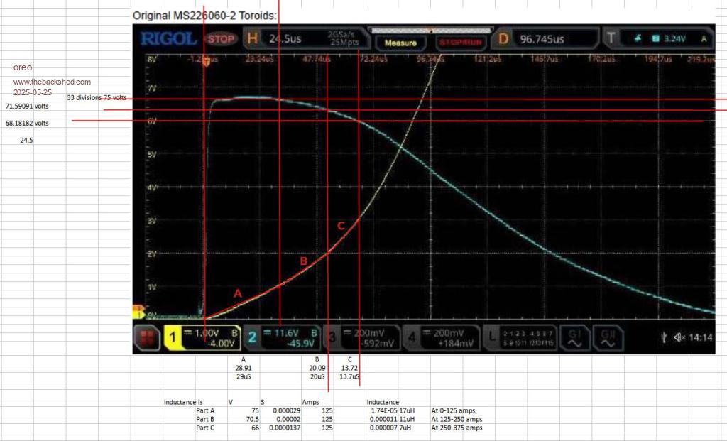

There is a difference in the Toroids, these New units are marked as FM571060A, the old Toroids are MS226060-2. I cannot find any reference to FM571060A.
They both give exactly the same Inductance for the Number of turns and are the same size.
The newer units look to have a much softer curve. I have repeated the tests many times and every run is identical.
Yellow: Current 125A per volt.
Blue: Cap discharge voltage from 75V.
Original MS226060-2 Toroids:
The New Toroids:
If you compress the time scale, the second image is virtually the same as the first, it's almost as though there is a small resistance in play? I rechecked the cable, both use the same cable, everything looks identical and the display for each as shown above is always exactly the same no matter how many times I swap them into the JIG.

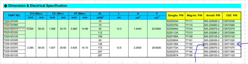

  KeepIS said  There is a difference in the Toroids, these New units are marked as FM571060A, the old Toroids are MS226060-2. I cannot find any reference to FM571060A.
Here is a cross reference I pulled from the Karson's website
Different manufacturers unfortunately use different part numbering schemes, however the FM part number seems to follow the same scheme as CSC part number.  However it is obviously not a standard sendust core material, because it saturates differently.
Let's run a few calculations.
Greg

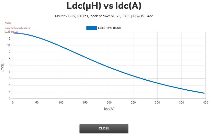

Using the curves from 6 MS226060-2 cores posted earlier by KeepIS.
Now running the same setup in the Micrometals analyzer produces slightly different results.  I do notice that KeepIS curves are a little funky in that the voltage is shown as going up for part of the curve, which is weird.
Typically the Micrometal calculations match my curve calculations but regardless we can use this as a guide.

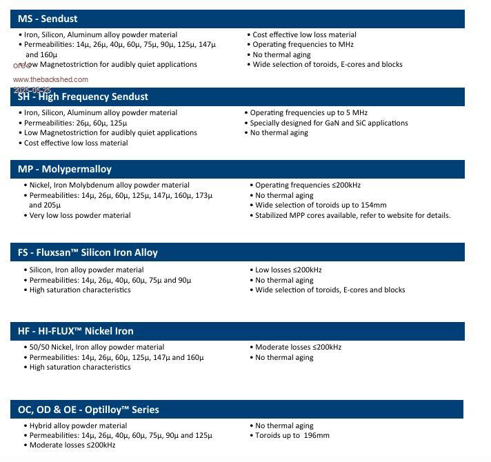

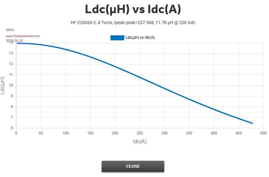

Now there are better core materials than Sendust.  Here is a list of the Micrometals (Arnold cores) materials.
Now if I plug in a HF type core into the Analyzer tool, this is the graph I get.
The FS type core produces slightly better results.
These cores saturate slower than standard sendust.
So it looks like KeepIS has discovered a core supplier that can supply cores with better characteristics than a standard sendust core.  That is good to know!
Greg

oroe thanks so much for that, I was going to ask you if you could run this through the Micrometal app as you did last time.
This confirms my calculations and the much slower saturation curve for the Latest toroids

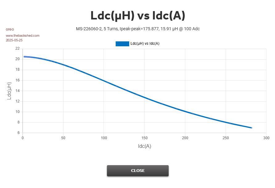

  KeepIS said
BTW the Micrometals Sim above is 4 turns, I have 5 turns in these @ 22.6µH @ 20kHz.
oops.  With 5 turns the simulator returns very similar numbers to the calculated numbers from your curves.
