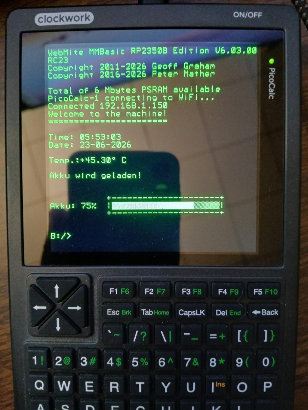

Okay, I loaded universal_flash_nuke and then RC24. Unfortunately, the behavior is the same. PicoCalc only starts up sporadically and very rarely. (No heartbeat)
toml_12953
Joined: 13/02/2015
Posts: 735
Posted: 09:55am 23 Jun 2026
  Frank N. Furter said  Something's not working right with the new version on PicoCalc.
I flashed my PicoCalc with "PicoMiteRP2350V6.03.00RC23.uf2" and loaded my mm.startup from SD card
Frank
I copied your code into my two PicoCalcs and they worked fine as shown below. Of course, I don't have a temperature sensor attached and it's warm here but not that warm!:
Frank N. Furter
Joined: 28/05/2012
Posts: 1156
Posted: 09:58am 23 Jun 2026
It's not the code. RC22 is still running smoothly for me.
Frank
Posts: 12051
Posted: 10:05am 23 Jun 2026
Frank, Given that toml_12953 is running his PicoCalcs on RC23 with your library startup (your original problem setup) then I don't know what more to suggest. You could try different CPU speeds when it does start but......

Posts: 6195
Posted: 10:42am 23 Jun 2026
Frank,
Is there a WEBMITE inside the PicoCalc ? toml_12953 uses a webmite.
You flashed "PicoMiteRP2350V6.03.00RC23.uf2" which is not webmite.
Could it be WIFI related ?
