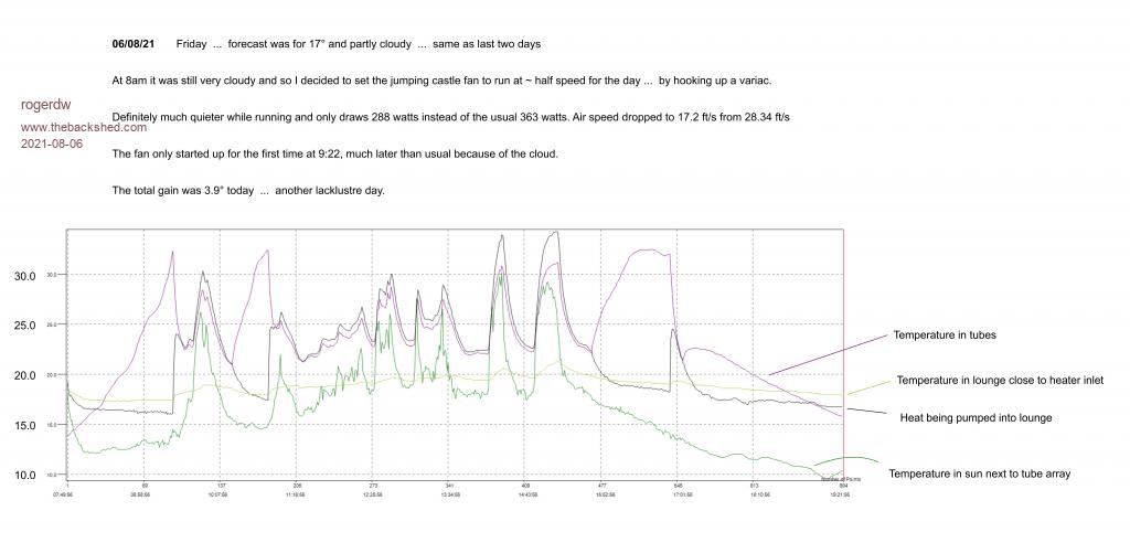

I picked up the duct work for the heater from the sheet metal guy today. Looks nice and heavy  ...  we may have over spec'd it  ...  but better than the other way around.
The top cover I ordered in brushed stainless  ...  but the inside of it is like a mirror. The outer has a plastic protection film on it, so I can't wait to see if that's as shiny.
Todays results were a bit ordinary again, with cloud and drizzle and virtually no sun.
I looked at the temps at around 4:45pm thinking it was all over  ...  and was amazed to see the tube temp was within a degree of turning on again.
The sun was behind a cloud and was already behind the trees across the road  ...  and it came back on for another 12 minutes. So it doesn't rely on direct sunlight  ...  it works quite well from just light. I was so surprised I went out and took a photo.

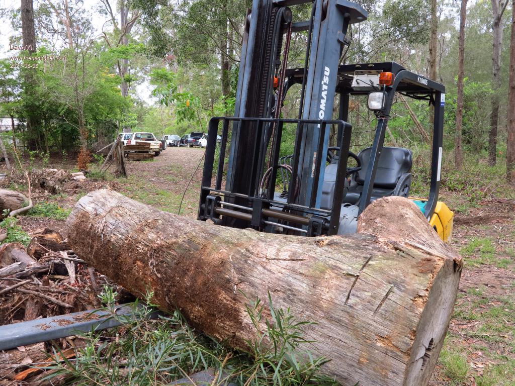

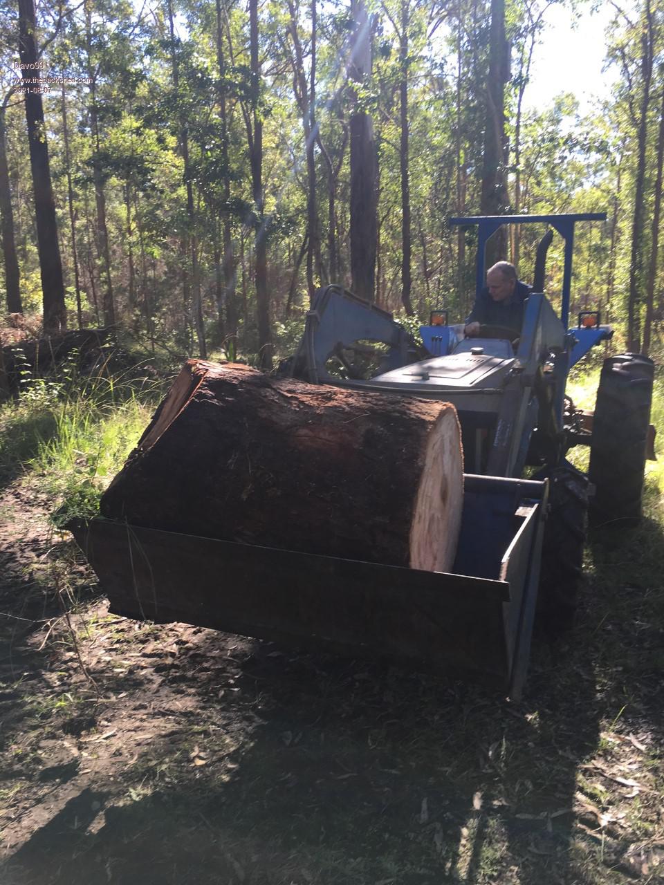

Collect wood?
Have I ever shown you what I have to " Collect" for my father?
That one weighed in at a touch over 900Kg.
You know your alive when you drop something this big and it hits the ground... or you may not be alive for very long if something does not go as planned.
He's very helpful in brining it up to the wood shed for me to cut and split.
Showed this shot to the guy at the local Bunnings. He asked could he have a copy to show people what these battery saws can do. Next time we went in there we saw another guy who remembered us and said how many of the battery saws they had been selling since they started showing people those Pics.

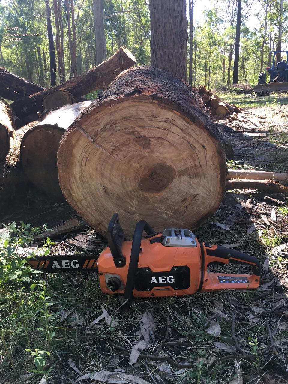

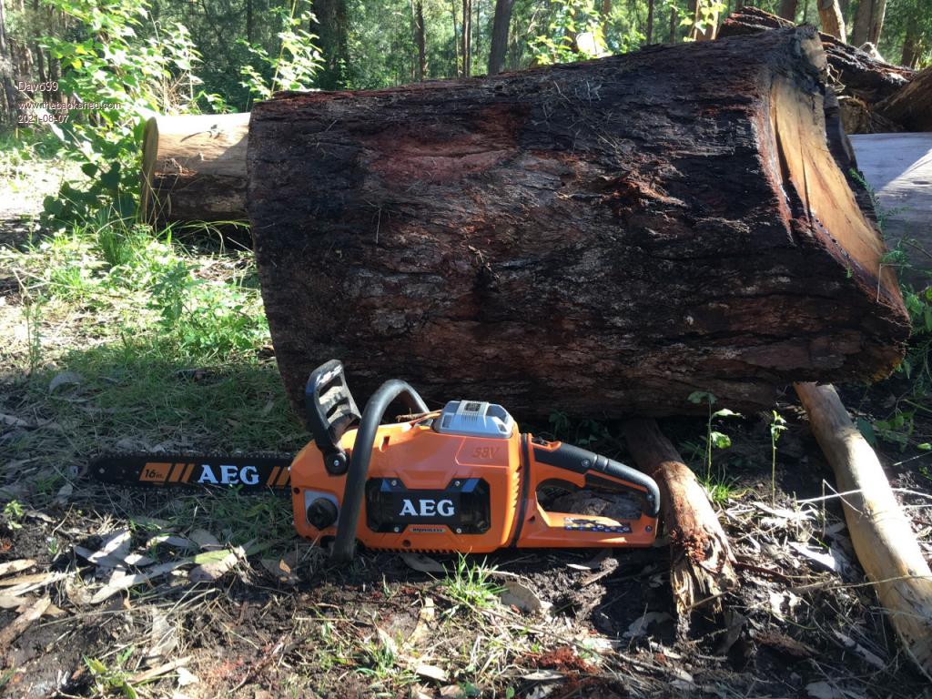

It did cut it up but it is faster to use the 92 CC with the 24" bar on that stuff.
Plenty more where they came from. He wants a couple more this size or larger dropped when I go back up.  Great!

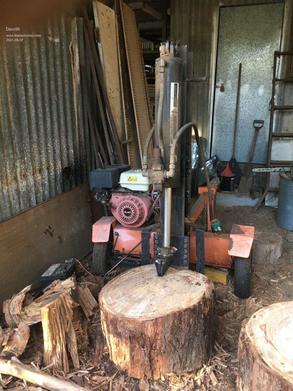

I bought him the biggest splitter I could find. I should have waited and found something bigger. Those rounds alone are around 120 Kg. the big ones I have done went 34". Madness!
I will say though, this Chyneese Knock off splitter has NEVER failed to split whatever was put in it and it's rarely run above a fast Idle. Will even go through knotted stuff. If it don't split it it just pulverises it. It's amazed a lot of people with what it will do, easily. Sometimes the hard, dry timber explodes especially if it's got knots but we have learnt to stand aside now after the Crown jewels have had a few brushes with excruciating agony narrowly avoided.
The end plate on this thing is 1.5 " thick and getting quite the curve in it now. You can see what the thing is put though and it's been doing it about 7 years.  I remember changing the oil once, might have to try and remember to give it another birthday.  New air filter may not hurt either.

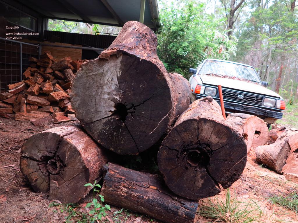

The effort required to turn this ironbark and other hardwood this size into little pieces is ridiculous  whether you have all the toys or not. It's what's there and what he wants so....

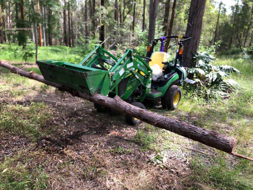

This is something Dad says isn't worth the time to cut up. What normal people would use and go after of course or what they could lift onto a splitter! Only need to split that in half but he'd go though that in a day if it lasted that long.

  Quote  Collect wood?
Far out!!!  If we had access to that sort of wood and that type of equipment  ...  I wouldn't be wasting my time with piddly little tube heaters  ...  I'd be burning more wood.
  Quote  The effort required to turn this ironbark and other hardwood this size into little pieces is ridiculous  whether you have all the toys or not. It's what's there and what he wants so....
You're right, still all hard work. We only collected about a ton, if that  ...  but it'll keep us going for a month at least  ...  and more as the weather improves and we need less.
  Quote  This is something Dad says isn't worth the time to cut up. What normal people would use and go after of course or what they could lift onto a splitter! Only need to split that in half but he'd go though that in a day if it lasted that long.
Yep, I'd take that stuff all day long  ...  would be perfect for us.

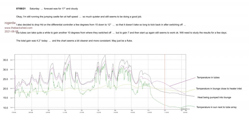

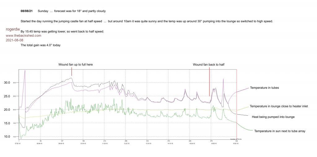

Here's todays chart. I reduced the Hd from 15 degrees down to 12, so it turns back on sooner after shutting off.
Chart looks nice and 'clean'.
Bit hard to understand how the temperature coming out the outlet is warmer than the temp in the tubes  ...  but it is consistent.
Cheers,  Roger

Was looking at those pics again last night and noticed there are 3 Trees in those Pics he wants me to drop which comparing in the pics and thinking of them, are probably bigger than the ones in those shots. That said, being so big and straight, He can probably sell them to the mill down the road.  At least one is probably worth about a grand atm. He's getting the tree guy in to quote on taking down a Couple of 150 Ft'ers I'm not game to do close to the back of the shed and point out the ones that would be worth something. If the tree guy puts them on the ground I'll do the rest.
Haha, I had no idea that either of them were available  ...  and yeah, I have to agree, there's a time when some of that stuff needs to be left to the young bucks.
The AEG in the pic is a battery saw. It's a ball tearer.  Will do anything a similar size Petrol saw will do and more. Dad has a couple in his collection so I can compare. I would say the battery lasts about double the run time of a tank of fuel on a comparable size saw. We have 3 battery's and for what I do, time the second one is flat you have dropped so many trees or cut so many rounds for fire wood, You need to clean up what youo have dine anyway. In the case of cutting rounds, you are tripping over it everywhere so need to get on the splitter.  The 1st battery because it will be hot from being run will take a bit longer to charge than the second battery will last but that's never been a problem and have the 3rd battery anyway.
Dad also has a little 18V battery saw which he has ordered a replacement. The thing is making some Noise, I think it's worn sprocket and was trying to get him to diagnose it but I got the excuses of couldn't be bothered stuffing round ( Umm, Take the chain off dad and run it and see if the noise is still there) but he was obviously hell bent on buying another new toy.  He pointed out in the kit with the batteries and the charger and the chain  that came with it all, the saw itself was only costing less than $100.
I pointed out that he already has 9 Batteries and about 4 New unused chargers in the cupboard but we all know the effectiveness or complete absence there of when we want a new toy.  I got the feeling I'll be inheriting the old saw, a new charger and a couple of suspect batteries to repack.
I have a 24" petrol saw which is a monster and I also bought a little 12" Battery saw for trimming round here as the big one has already gone though everything suitably sized.  Mine is a Ryobi and I am amazed with the thing. I have cut stuff with it way beyond it's pay grade and it did it without complaint. For what I want it for Trimming trees and hedges, it's fantastic!
The Fuel Injected one is too big for Dad to handle which I have pointed out several times and I'm still not that sure of the reason for the FI anyway?  It may just be the environmental concerns? Dad thinks it may be easier starting. I don't have any trouble starting the petrol saws although he has bought and sold some good ones because he can't start them. Keep telling him that's a sign but of course that does not register.
The fact the FI saw has been out some years now and not been copied I think is a tell tale in itself. If it was so much better they would have all gone that way. It's pretty exy for it's size so that may have something to do with it.
I'm also not sure how " Fuel Injected" it is? I have a feeling it may be more a play on words than anything and in any case it's probably a rudimentary system anyway.
I have lost a lot of weight recently and a Hell of a lot of strength and Muscle and I'm feeling it.  I'm going to feel it a whole lot more when I get up there and get back into that.  They made men so much Manlier in the old days. I could not imagine cutting and splitting wood by hand in Qty. I cut and split a Couple of Cubic meters in a day with every toy imaginable and that's an effort that has the sweat pouring off me. Getting it onto the splitter and stacking it is enough let alone everything else before that. Couple of Cubes lasts no time.  Cutting wood day after day because you relied on it would be a chore I could not cope with.
Then again, They wouldn't be stupid enough to even consider doing by hand the stuff I do.
I have ordered a little hand held Mill I'm going to give a go. I want some slabs to use here so see how that does.  I'm thinking  Dad is interested too. Wouldn't surprise me if the next thing he starts talking about buying is a proper Mill.Made the mistake of pointing out the people whom made the stump Grinder also make proper Mills.   He found what that raw edge timber is worth and I think he can see some investment $$. I can feel aches and pains because I know who'd going to have to do it.
The big problem with timber is the low heat value. You think a fire is giving off loads of heat which they certainly can, but when you look at the actual heat value of timber compared to Liquid fuels, like everything else it's pretty poor. Ton of wood is roughly 3000Kwh of energy.  You can get that in 300L, 240 Kg of oil or diesel.
Looking at the meter on the fan heater here in my cave, I have used 337 Kwh of power to heat in here so far this winter.  Sure I leave the door open so it's heating other parts of the house as well but that's still a ton of wood on it's own.  And, the fan is 100% efficient, wood stove is 70-80% at very best.
I'm sure if your tubes save even 1 ton of wood next winter it will be worth while and lets face it, we aren't getting any younger or more capable of this work.... although I am having great difficulty trying to explain that to my father whom refuses to take it into account.
It is what any sensible people would look for that could be handled without killing oneself in the effort to turn it to toothpicks to Burn.
I have been informed he's marked about 50 of those saplings for me to take down.... like I have argued with him for how long I don't know.
There is still so much of the big stuff I have dropped that's sitting there drying that I need to get rid of though.
I bought him a Big Chipper a few months back. I have been wondering how it would go to spread a load of the chips out to dry them and how they would go thrown into the fire like Coal?  I have my reservations due to the lack of air around them but in an air controlled environment?
Going to have plenty so might be more useful than throwing them back on the garden to rot.

Posts: 1586
Posted: 01:14am 08 Aug 2021
Roger, are you running the blower at half speed with a PWM or VFD or just restricting it?

Posted: 02:10am 08 Aug 2021
  Davo99 said  Roger, are you running the blower at half speed with a PWM or VFD or just restricting it?
I'm cheating, I'm using a variac and just winding the big knob backwards or forwards.
In fact I used a monster one I have to reduce the speed of my drill press when I cut those big holes  ...  the drillpress wouldn't go low enough to match the recommended speed, so I cheated there too.
It's nice and sunny here today at last and I've wound the blower back up to full speed
...  and it's maintaining around a 30 degree output.
Cheers,  Roger

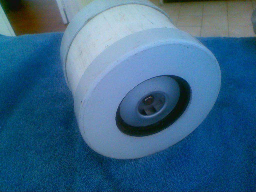

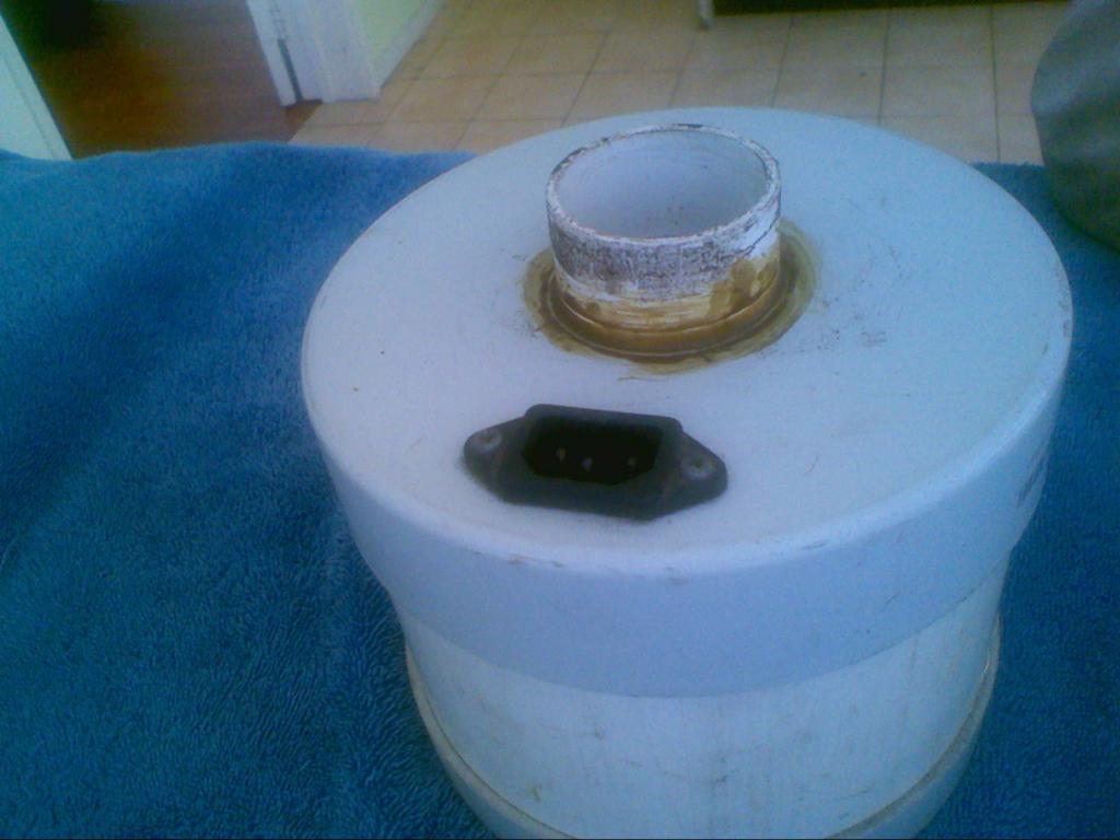

  Quote  none of them have the facility to put a hose on the outlet.
This is something I put together many years ago. So long ago, I cannot now remember what it was originally made for.
It converts a vacuum cleaner motor into an air blower with some PVC pipe fittings.

Posted: 12:46pm 08 Aug 2021
I thought today was going to be pretty good when it started off well  ...  but overall gains were ok, but not spectacular.
Cheers,  Roger
