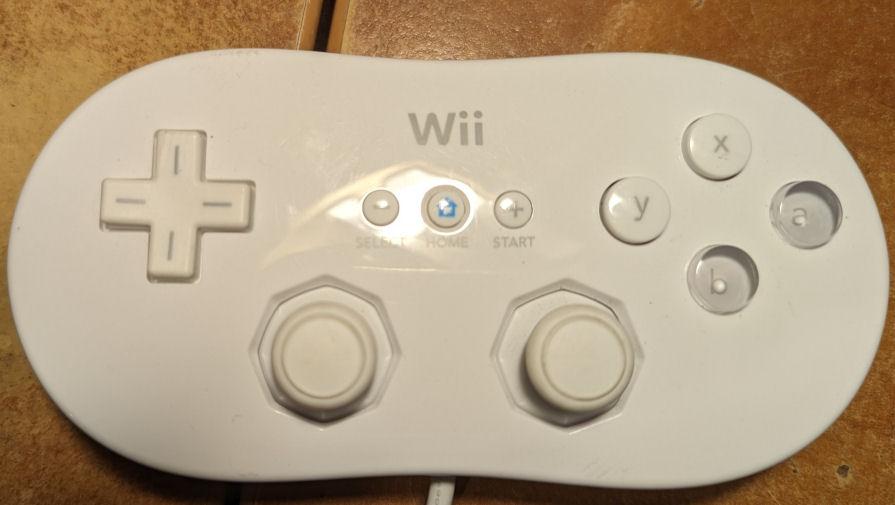

I've got a Wii classic wired to a GameMite and will post  I/F code sometime over the next week or so (traveling for the next three)

I like the idea of having the WII controllers on the PicoMite (or any I2C controllers for that matter). I just don't like using the PCB as a connector. Looks like I could get sockets from AE though.
I had reasonable success in using a RP2040-Zero as a I2C slave controller for both analogue and digital inputs. I never got round to testing it on a decent length of wire though.

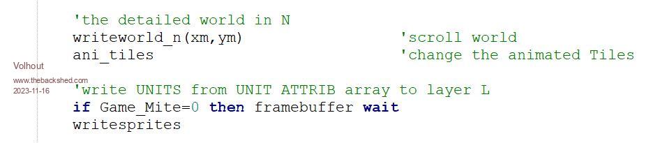

To answer your question, why does moving your world generation code to after your player/robot generation code. My theory!
When you redraw the world, lots of stuff is potentially changing, so plenty of scope for your eyes to catch any inconsistencies. When you redraw the player layer, most of it is transparent, the player doesn't actually move, is always on the same square, the only other movement is the occasional robot, gun shots, etc, all very small and very easy to miss any inconsistency, most of which may occur in the transparent tiles anyway.
So by doing the player plotting first, the chances of you seeing any problems because the LCD is still in the process of updating in the background, are almost nill, by the time the player/robots have been updated, the LCD screen will have easily finish refreshing, so now the world is regenerated and the new frame is then ready for the next background LCD refresh to start, etc....
So the problem is being masked, or something! ;-)

Thank you for your explanation. I was afraid this would be your reasoning, and hence my worries. Let me explain.
In the game loop there are functions and subs that work on background data, and subs that actually write to the screen. Sometimes the name of the subs can be confusing (due to my personal development in writing games, I sometimes changed the content (and thus function) of a sub. And it not always exactly does what it's name says (i.e. writeplayer does not actually write to ecreen anymore).
In the game main loop, all screen (either VGA or LCD) activity (block screen write routines) takes place here:
writeworld_n: copies section of the world map to N layer in the view window.
writesprites: clears L layer and redraws all sprites.
subs like "ani-tiles" and "writeplayer" prepare data for the actual screen writing routines, but do not actually write.
The only exemption to the above is the data that is written in the game border on layer N. The weapon/item/key/player face/comments are directly written to N, only when changed. And the loop time indicator in the top right, is written each loop.
Now about your change.
Since you have not changed the order in which writeworld and writesprites work, you have not fixed what you intended to fix.
But you did change the timing relation in the loop between the block screen write routines, and the "incidental" screen write routines that show weapon/item/player_face/comment strings and loop time.
P.S. I was able to lower the loop time by 10ms by re-organizing the "scan_units" SUB.

Ok I can see what you mean, in that case, I know what is happening, the LCD background update is started, at the end of the main loop, so by moving the writeworld_n and ani_tiles to after all the player and robot logic, it is allowing enough time for the LCD copy to finish in the background, before the next writeworld_n and ani_tiles are called, which in theory is even better, as long as no other problems.
Anyway, whatever the reason, I can't now see any problems with the LCD display. Before the code was moved, if the player ran along the side of, or towards or away from water, for example, you could see, the water offset, tear or only partially drawn, briefly, which to me didn't really matter, now, assuming you can't see any problems with the moved code we may as well leave it, because it seems to fix any screen tearing. :-)
I have tested Peters latest B19, with built in Framebuffer Wait, with both the original, pet24e, which is still tearing, I tried using both the full Framebuffer merge, and also Blit merge, there may be a slight improvement, it's difficult to judge, with the revised pet24emod, I can't detect any screen problems.
Regards, Kevin.

  Bleep said  I have tested Peter's latest RC19, with built in Framebuffer Wait, with both the original, pet24e, which is still tearing, I tried using both the full Framebuffer merge, and also Blit merge, there may be a slight improvement, it's difficult to judge, with the revised pet24emod, I can't detect any screen problems.
Hmm, unless I have mistaken what Peter was describing (or am being more than usually dozy) his latest changes should have just eliminated tearing provided ALL screen updates are occurring via a background merge.
Edited 2023-11-16 23:20 by thwill

Watch out: framebuffer wait is currently bypassed when Game_Mite=1

Hi Harm,
Peter has built it into the Framebuffer merge and Blit merge commands, for the LCD.
  Quote  FRAMEBUFFER WAIT now implemented for ILI9341, ST7789_320 and ILI9488 displays
note however that the
BLIT MERGE and FRAMEBUFFER MERGE commands both now incorporate this functionality automatically. Assuming these are run on the second processor then tearing effects should be reduced or eliminated
I have also noticed a difference between pet24e and Pet24emod, it seems to me, that with Pet24e when you hold down the move buttons and then release, the player always moves on one more square, however on Pet24eMod as soon as you release the move buttons, the player stops. This would make sense as the order of calculation now is key input, game logic, draw world and layer, so a button change is always instant.
Regards, Kevin.
