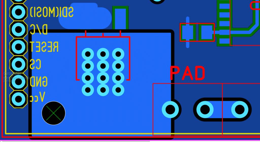

Posts: 10043
Posted: 11:15pm 08 Jan 2018
@ Phil23: Trust you to actually research that comment. "Clever girl."
@ redrok: I usually just provide a small-ish zone of insulated copper pour on top and bottom layers for heatsinks for these kind of parts.
Thermal vias are filled with solder during assembly, but I doubt I would even need the bottom copper 'heatsink', but if you have room, why not allow for it. I will add a 100k pulldown to the gate, and a 1k series.

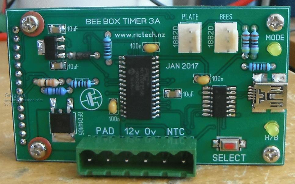

PCB's ordered, made, and on DHL to me now.(have arrived at Auckland Airport according to tracking)
Waiting on heating pad to arrive. I got two.
I will assemble the PCB while I wait.
The PCB is designed as a backpack to a 2.8" SPI LCD with touch, so I can add some basic touch controls to the LCD screen. Old design used a red LED display, but the SPI LCD's can be setup however you want - including red 7-segment if I want it.
Pad has NTC, but I have elected to use a couple of 18B20 temperature sensors, as they are much more accurate then a passive NTC would be. I have allowed for connection of the NTC to an ADC pin on the MM2 chip, just in case I elect to use it.
I will post back to this thread as I progress with the project.
Thank you for your interest.

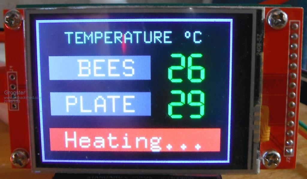

Here are a couple of photos of the assembled unit:
The last image is showing errors for the temperatures, cos I don't have any 18B20 sensors on it just yet, so the code is written to pick up on that and show an error message. The 'SYSTEM HALTED' message in red is actually blinking off and on. I will try to get some sensors on it later and post another image.
Posts: 10043
Posted: 07:13am 28 Jan 2018
OK, I have hooked up a couple of 18B20 sensors, and this is what it looks like under normal operation:

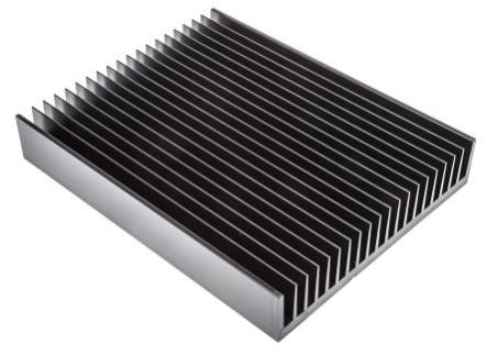

Posted: 09:51pm 28 Jan 2018
I doubt if bees could survive out in the wild if the day temperature exceeded what they could tolerate.
I still think that a large finned aluminium heatsink and a bolted on resistor would be the simplest way to have high thermal mass, with very good thermal coupling to the air.

Posted: 02:43am 29 Jan 2018
Look up metal clad resistor on e-bay. You can get any resistance value, and over a wide range of physical sizes. Just one resistor would work fine, the heat will spread pretty evenly over the heatsink. Two or three smaller resistors may be mechanically easier, but the heat should be pretty even only with one resistor.
First thing is to determine how much power you need. Suppose you assume a 40C incubator temperature, and the lowest outside ambient of say 10C.
We need enough power to keep the inside 30C hotter than the outside in this example.
Yesterday it was stinking hot, 40C here in Melbourne, but we could still test our incubator by finding how many watts are needed to keep the inside 30c hotter than the outside. Say 70C for the test if its 40c ambient.
So we need "something" inside to generate some test heat. Maybe some 12v light globes, or whatever odd selection of resistors you can scrape up. Get an adjustable dc power supply and feed in some power. We only need to find out the relationship of inside temperature rise to the watts we are feeding in. Leave it overnight to reach a stable equilibrium.
Your first guess may be way out, so try raising or lowering the power to get some sort of reasonable temperature rise.
When you know roughly how many watts are needed, you can then work out the required resistance with whatever battery voltage you decide to use.
Choose a resistor of much higher rated wattage so its not running flat out, but select the resistance value for the actual power required, plus a slightly more so it will heat up to final temperature a bit faster.
I would not place the eggs/bees or whatever, directly on top of the heatsink but on something like very fine wire mesh (flywire ?) that would allow a very free air circulation around both eggs and heatsink, even without a fan.Edited by Warpspeed 2018-01-30

The heating pads have arrived. They are a nice looking unit, and seem very solid.
Current @ 12.0v is 3.2A
Heating is slow, but very even across the entire pad, width and length. I'm pretty pleased with these things so far.
MOSFET get's warm, but not hot.
redrok
Joined: 15/09/2014
Posts: 209
Posted: 02:58am 01 Feb 2018
Hi Grogster;
  Grogster said   The heating pads have arrived. They are a nice looking unit, and seem very solid.
MOSFET gets warm, but not hot.
There is a ThetaJA, Junction to Ambient, speck for the RFD14N05 which is 80°C/W free air
and
ThetaJC, Junction to Case, 3.125°C/W heat sinked.
My measurements of the RFD14N05 with a 3.3V gate drive is 64mΩ, (here is the graph).
3.2A^2 * 64mΩ = 0.66W Assuming the MOSFET is on 100%
.66W * 80°C/W = 52°Cdelta rise above ambient free air no heat sink
or
.66W * 3.125°C/W = 2°Cdelta rise above ambient with heat sink
Adding in your ambient temperature:
52°Cdelta + 35°CAmb = 87°CJunc free air
or
52°Cdelta + 2°CAmb = 54°CJunc heat sinked
Not to hot as the parts junction is rated for a Tj of 175°C
BTW you could use the heater plate as the heat sink.
redrokEdited by redrok 2018-02-02
