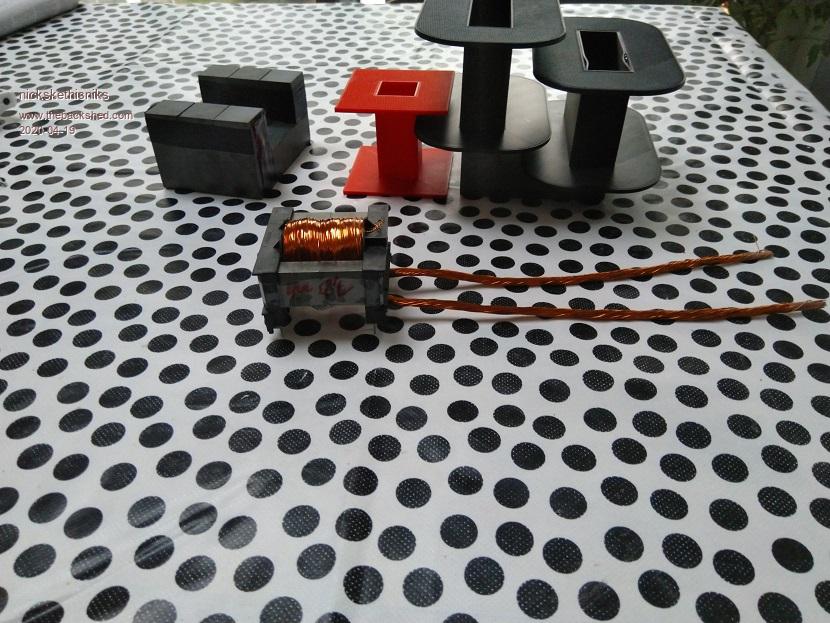

Nick, I found some of those ferrite U cores in my junk drawer. And a couple of them already had 22 turn windings on them !
So I fitted up one U core with 22 turns and another U core without any turns and measured 2.16mH with zero air gap.  My ferrite data book only has inductance figures for one U core and one I bar in combination of 6.2uH for one turn.
6.2uH x 22 x 22 = 3.0mH  Two U cores have a lot longer magnetic path than a U and an I, and will produce much less inductance, so 2.16mH is probably about right.
Anyhow, tried a 15mm gap and measured 110uH with just the one 22 turn winding plus one bare core.
My data book only has Hanna curves for 20mm square cores and 30mm square cores, not the 25mm square cores.  But even the much larger 30mm cores might be right on the limit to get to 120 amps at 50uH before saturation.
If I draw a line between the two curves and assume that might be something like a 25mm square core set, then I squared L of 250mJ with a 5mm gap might be about the limit which may end up at about 71 amps saturation for 50uH.
The data book is probably a bit conservative, but its going to saturate well before 120 amps even with a 15mm gap.
Only way to know for sure would be to build a choke testing rig.

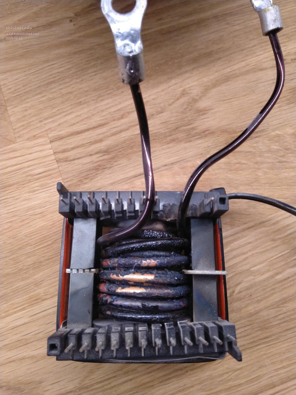

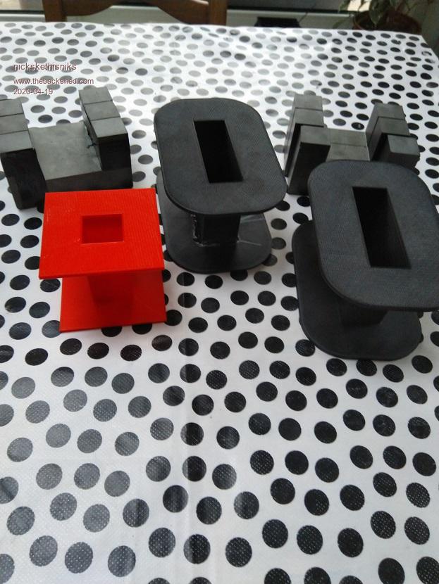

So you don't see it as a problem the way I wound the inductor?
I know the core will saturate @ those current levels. I used an etd59 for more than a year now, considering the size (cross section) that will saturate @ half the current.
You motivated me to do some more research, so I found a site where I could do some calculation.
This morning I looked back at the bobbin and it "looks" more like 22 turns then 25.
So I found this website to calculate saturation of an inductor.
http://pigeonsnest.co.uk/stuff/core-saturation.html
Datasheet of the core is found here:
https://www.ferroxcube.com/upload/media/product/file/Pr_ds/U100_57_25.pdf
It doesn't matter one or 2 core halves for the calculation?
So if I derrive some information:
For a certain airgap with one bobbin I could measure 60uH.
AL= L/n˛ =60uH/22˛= 123.97nH/n˛
If I use the tool and use the following data as reference:
AL=123.97nH/n˛
Bsat= 0.32T (datasheet)
L = 60µH
Ae = 645mm˛
Then I get 75A for the saturation current.
If I do this for my ETD59 core I get about 30.6A for 320mT and 38A for 400mT, if I remember right it was somewhere between 30 and 40A. So these look the right numbers.
I could parallel 2 inductors in series to reach my goal.

Nick, that link to the inductor calculator is pure gold.
The data books are a bit limited, because they have no idea what you plan to use their cores for, and they have limited space to include data for gapped cores, or huge extremes in operating frequency. There is also the problem that different manufacturers make similar cores from their own ferrite mix recipe which may be end up being very slightly different. Ferroxcube are the big guns in Europe, but TDK have a huge market in Asia and the east.  Their products are pretty much interchangeable but not identical.
Published data is certainly a great help initially, but it can never replace the results of actual testing.
What you need for choke design are called Hanna curves. This plots total air gap along the X axis and L I squared on the vertical Y axis. The scales are both logarithmic, and the "curve" is actually a straight line which is appropriate for a specific ferrite size and geometry.
L I squared is actually the stored energy in the choke, and becomes larger with a wider air gap. Scroll down to page 39
https://www.ferroxcube.com/zh-CN/download/download/21
On the right hand side you will see the Hanna curve for U100-57-25. That curve only extends out to about 3.5mm total gap, but right at the end of the line the quoted energy is 200 mJ.
What that means is, that core set with that air gap will always end up with Amps squared times inductance value of 0.2 Joules.
So, amps x amps x inductance (in henries) = joules (just below expected saturation).
If we put on just sufficient turns to produce 50uH, we get:
Amps squared = 0.2 joules divided by 50uH
Amps squared = 0.2 / .00005 = 4,000
Amps = 63.24  with the specified 3.5mm total air gap (2 x 1.75mm spacer)
Now a 1.75mm spacer is not a lot, and we can do better with a wider air gap but there can be issues with that.  The problem is fringing around the air gap.  If the air gap is in the middle of the winding, as it will always be with two identical core halves, that can create some odd effects that can make a nonsense of any calculations.
It depends on the application.  For chokes with a lot of dc and very little ac current ripple component, a central air gap should work pretty well. If its for something like a flyback switching power supply,a big central air gap can create some really nasty effects. There will be horrible ringing and the waveforms will look truly awful. That is all caused by fringing around the airgap influencing the voltages developed in the turns immediately above the air gap.
So the ferrite manufacturers do not like to recommend using really huge air gaps for general applications, although you should be able to get away with big gaps in a large over designed dc choke that has a very low ac ripple component.
You can get slightly more by extending the line on the Hanna curve, but will quickly run into diminishing returns. Much better to go to a larger core cross section.

Again thanks for all the comments!
I was running out of time, the current inductor allmost lost all his smoke.
But I was just in time to notice, there was a little bit to much power consumption, the induction stove, oven, microwave...
So had to speed up things and mount a more robust inductor. I just went for it and had the spare mosfets closeby ( fortunate not needed )
So I had to put in about 36mm airgap (2*18mm, it's more like an aircoil :) ) to get my 50µH, it's functioning about 2 weeks now. Fingers crossed it holds, sinewave does not change a lot under load. Now it's 30mm˛ instead of 10mm˛ should run a lot cooler with heavy loads.
It will be temporary, It dropped to my mind the pla from the coilformer is only rated for about 50°C, that is to little.
I must make a new coilformer with abs. The new coilformer will hold 6halves and will be suited for the whole powerrange this inverter can take. The airgap will be a lot smaller so should keep surprises away.
This inductor will move to a spare inverter or other project.

So speaking of the new inductor, I let my wife draw the CAD files for my new coilformers.
Then I let a colleague print the formers in abs, this is the result:
(So small mistake,  they are a little to big, but the grinder will help me with that.)
Edited 2020-04-19 20:41 by nickskethisniks
Posted: 10:00pm 19 Apr 2020
Very handy to have friends that can do things like that
