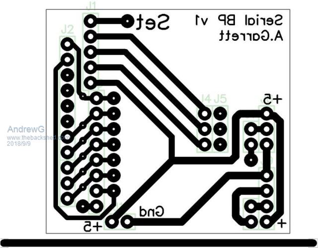

Hi Plover,
I forgot to mention that the "bar" at the bottom of the diagram is 50mm long.
The border is approximately 43x36mm.
Below J2 is J8 - they form a continuous 11 pin female header - on the Cu side) (I don't have such a beast in my Diptrace template)
Below J3 is J9 - these are not actually headers but 11 holes at .1" spacing! (its covered in my description above).
Subject to the other thread I've just started (here) I will be modifying the design (again) to remove J2 and J8 and put a female header at J3 and J9.
OK? Cheers, Andrew

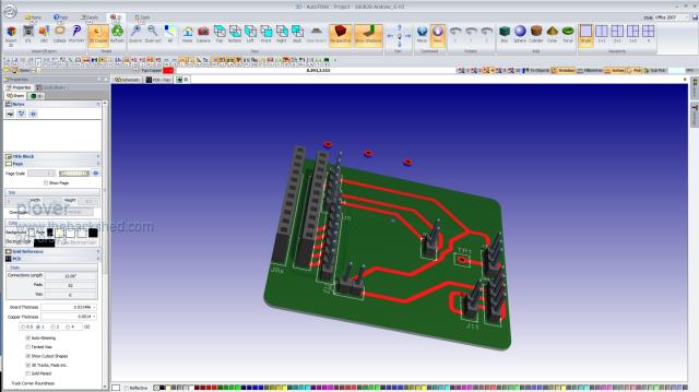

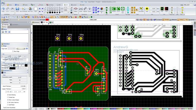

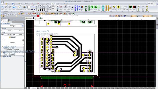

There is a bit of action on my part though again having to limit my time to spend on a number of my projects so I do not know when I am going say I have now learnt enough.
Interesting exercise to spot changes and correct. My memory looking at a picture then changing page I can no longer remember properly so I have to do side by side comparison and have worked something out that works for me.
In the following the connectors and routing is not finished but the spider net has been completed, ie if the schematic is correct then routing is also.
On the schematic, I miss the visual female/male header indication which bigmik long ago demonstrated as dots/circles definitely need them back but may have to be a job when building my own libraries.
The following is not complete as the 3 pads not below the headers not added but time up. Instead of drilling what about putting in a loop and then remove that when replacing with resistor?
First picture shows I am getting close as far as dimesnions, as it is 0.1" grid point based it will be close.
I wish I could remember how to turn a picture transparent so the overlay will show much more of the circuit board.
On the second picture notice double sided routing because I let the autorouter have a go, takes about less than a second to route and it is a good start.

Hi Plover,
You (and BigMick) have inspired me to have another go at AutoTrax Dex (I am starting from scratch but BigMick's "manual" sure helps).
I am still keen to do some DIY PCBs (I now have most of the gear) I think I will progress to gerbers as I begin to "master" the DIY process.
WRT to your designs above. Given you are x2 sided you can dispense with J2 and J8. The connections to J3 & J9??(below J3) will depend on your LCD display. BigMick's Serial BackPack is 1:1 for a particular display, my displays require a different connection.
I have changed my design so that the connection to J3's top pin is not from Vcc but is now from BigMick's LED pin (currently n/c on J5) - this has a resistor, R2, on the Serial Backpack to protect the LCD.
My J7 & J10 are 90 degree indexed male connectors and I'm not yet sure of the gender of the other connectors, except my J3 & J9 will be female to match the male pins on the LCDs.
Cheers, Andrew

Ouch, sorry I almost forgot about this little exercise. I have to re-build my hard drive. A job I was not very keen on but the drive I am running this DEX operation is getting in need of some organisation. All up I expect it will take me about a week before I am happy with a new setup.
If you have DEX I will post the project and you can load on your DEX configuration. This is one thing I like very much about DEX, you have everything in one folder. To exchange information is just passing one file.
I think my next move was to place the 3 pads sitting outside the board and re-route manually so it looks better.
Will be interesting to see what you can make out from building further the project.

Hi Plover (et al),
PM sent.
Until I can snaffle my wife's Win10 machine (she has a new Apple thing) I am restricted by my old XP's speed and what it can do with Dex. In the meantime I have composed the following on Diptrace and I'm not far from having a go at etching my own. Then I'll try to compose a x2 sided one to send to China.
You will see that it is quite different. I've inverted the HC-12 so the antenna is more central. I've added more headers to access more of BigMick's Serial Backpack's pins, power to the LED now comes from Mick's LED pin (protected by a resistor on his board) rather than Vcc and I've added some pads so I might be able to connect to the other LCD versions I have.
Cheers,
AndrewEdited by Andrew_G 2018-09-10

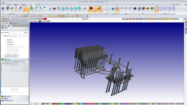

It is a great program once you get the hang of stuff. There is so much of it. The recovery bit is very handy. Had it playing silly buggers when I updated a part. Went back to just before it started playing up & continued on from there.
Interesting in the 3D mode when you find you have been using the wrong part. Pins pointing downwards instead of upwards & female ones instead of male ones.
I just went in & grabbed the first component I found. Slowly getting there.

Some of my parts have pins going the wrong way (well vertical positions incorrect) this happened when an update happened 12mths ago.. I need to redo these again..
A lot of parametric parts have been added which sort of supersedes a few of my parts..
But if you have the pins the wrong way you may have placed the part on the TOP (default) and not the Bottom layer (select the part and in properties there is a pull down tab that selects top or bottom.. I am not in front of my PC at the moment so I cannot pinpoint more accurately where this is.
Also if you chose Female in stead of Male or vise-versa click the PART BUILDER ICON then select your part.. Select the image that most represents your part (Presume it was a header) then there is a small easy to miss check box that turns the part into male/female types.. Works only on parametric parts and I think ONLY on headers.. There is a similar one for DIP ICs to add a socket in the 3D.
