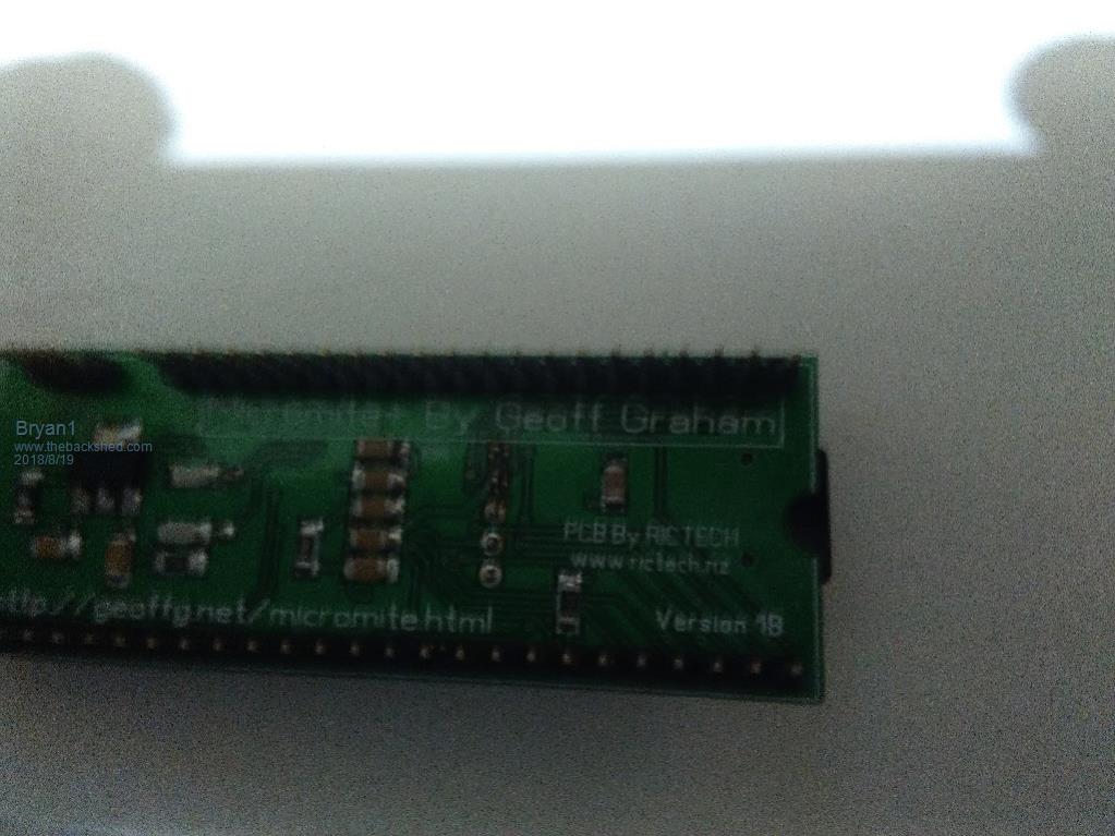

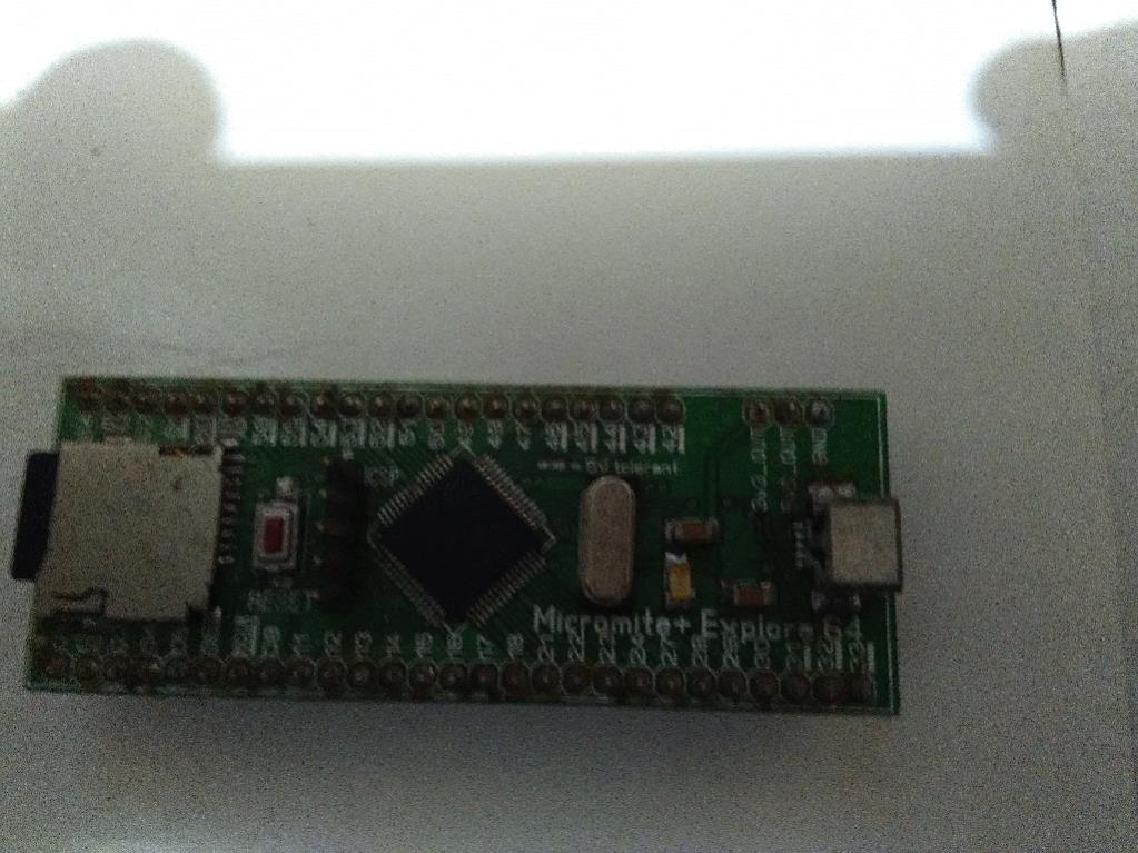

Bryan1
Joined: 22/02/2006
Posts: 2267
Posted: 09:13am 19 Aug 2018
Ok did the reflash of the beta10 hex file and still got the same error: SD Card not found. I only set the option for the sdcard and had the lcd unpowered.
here are a couple of pic's of the module
Tomorrow I'll have look in good light at the solder joints and if needed resolder them
Edited by Bryan1 2018-08-20
Posts: 2991
Posted: 09:39am 19 Aug 2018
OK - you need to isolate the breadboard as a potential issue too.
Is there anyway you can connect your Prolific to the E64 NOT via the breadboard. For example, four female-to-female jumper leads (i.e. 2x power + Rx and Tx).
Next step would then be to run a 'wet-tip' iron over the SD contacts. Ideally run some liquid flux over the contact first. Do same for the four rows of pins on the PIC.
Being aware of the time difference betweens, I await your update in a few hours . . .
